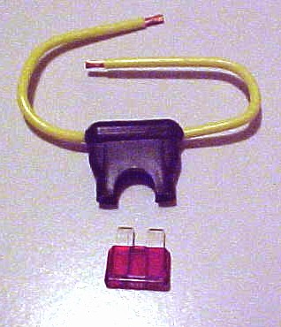

Your discussion about fuses was very good.
Key points:
Fuses are more reliable than circuitbreakers.
Fuse as close as possible to the power source.
Use large wire. 14 ga is good for 15A, 12 ga. is good for 20A, 10 ga for 30 amps.
Attached is a pic of one of my favorite fuse holders. It is small, can be tucked away inside a box, and uses the standard automotive industry fuses. Well designed fuses, very available, and hard to mis-apply.
I got a good surprise when I checked my M6800 fuse box. It has a lot of fuses. Then I noticed that half of them are stored spares! The fuse box cover has a built in fuse puller. Quality!
I don't like the cheapo cigarette lighter outlets that cost $4, and am looking for a well made one. Any suggestions anyone ?

jrpoux, Although I will probably never use "large" wire on my lil Kubota I have wired power to the center console of my pickups with #4. But then not everyone uses 1.5 million candlepower spot lights, 2-3 ham radio xcvrs, CB, FRS, WX, GPS, small frige, etc. Amps for some ham gear are amp hogs.
Regarding the reliability/longivity of breakers: If you are so fortunate as to find some surplus mil-grade, aircraft. or better yet mil-aircaft breakers, especially the ones for pilot use, then celebrate. These are made to use as a switch as well as to be a circuit breaker. Typically they are well sealed and pretty dust proof. I lucked into some that were lighted. Wired the light circuit to the pannel lights so they dimmed (had to cobble in some 12 volt lamps as the 24 volt ones were already dim on 12 volts.
Congrats on your spares and tool, I have that feature in my Dodge pickups.
Regarding 12vdc (cigarette lighter) outlets. Some of the best I have seen are stainless steel and come with waterproof covers to keep thing nice inside. They were built, I believe, for the marine industry. At least that is the venue in which I found them. My only complaint is that they were not flush or recessed (they protrude less than an inch, I was just being picky).
Thinking outside of the box, some folks just delete cigarette lighter outlets from their designs and standardize on something they like,changing everything to that style. It is certainly a valid engineering solution and you can use as good a style connector (with waterproof covers etc.) as you wish. Of course, as everything is a tradeoff, you have the time and expense of replacing the cigarette lighter plugs that come on a lot of gear.
