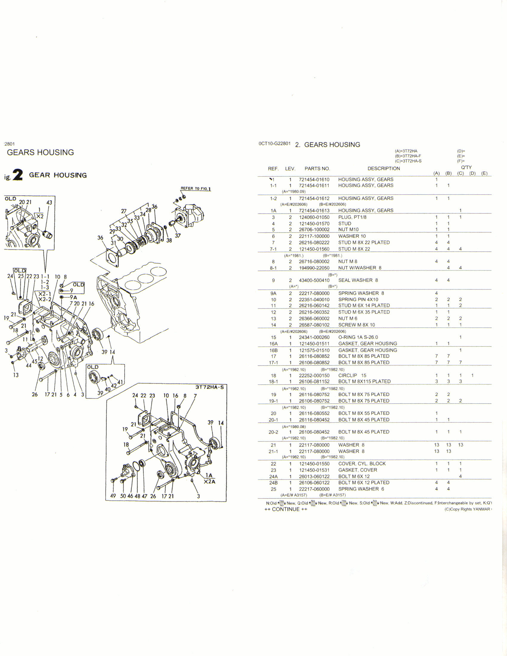

Likely the rack on the injector pump is stuck. Remove inspection cover #22 to check and see if it moves freely.
   / Runaway Throttle YM186D #6
Stuck control rack on inj pump..
When u find it, don’t force it.. u have to b careful of what your banging on..
