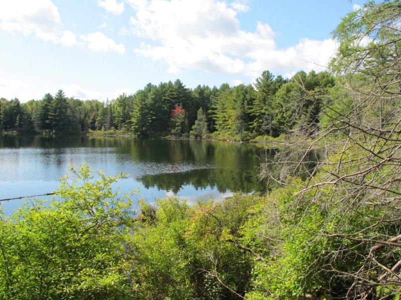

TBN works better with pictures :)
OK, here it is.

OK, here it is. <img src="http://www.tractorbynet.com/forums/files/projects/433176-running-500-feet-underground-wire-private-lake2-jpg"/><img src="http://www.tractorbynet.com/forums/files/projects/433177-running-500-feet-underground-wire-private-lake1-jpg"/>
Here's a photo showing the beach

Thanks, GSGANZER. I looked at the website and unfortunately I need a pretty big open area in which to operate the windmill, and my property is pretty much all Boreal Forest with pretty tall trees. (See the photos that I posted.)
