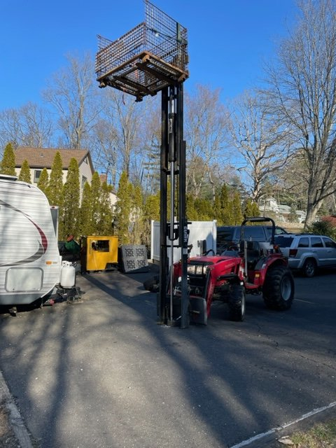

Have you checked your reservoir when that thing is up that high? That cylinder has a lot of fluid in it!
   / Running a Single Acting cylinder on a double acting valve.
#17
Perhaps dead heading was the incorrect term. The valve is going into relief, but it's not for a second or 2, it's a minute or 2 to lower this. I don't think this is really harmful, it will heat the fluid, but I don't use this hard or often.
Stability is certainly a concern and I'm really careful and aware of that. The tractor however is longer, wider and probably just as heavy as the forklift it was previously. I use a ballast box filled with steel plates and lead. The Ballast box weighs somewhere over 2,000 lbs. The Forklift of course had solid tires and was intended for use on concrete floors in a warehouse. I still think this tractor setup is safer than how I was using my old forklift.
The reservoir volume is a real concern. I have no way to verify that. My dipstick only reads full or not. it's only about 1" in the fluid.

Is there an orifice hidden in the plumbing to the cylinder that is causing it to be slow on the downstroke?
