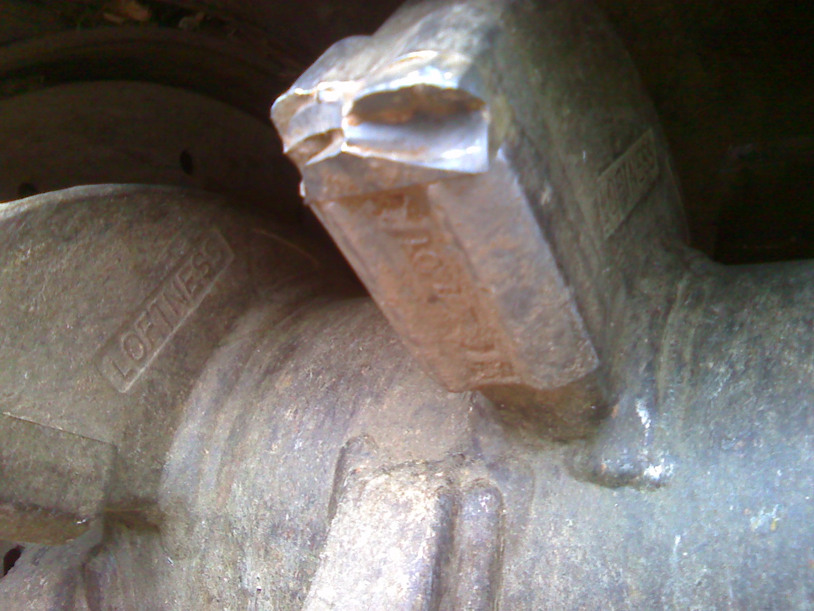

Think twice about the Planer Carbides.
I spent a lot of money swapping out standard carbides for planers and results are disapointing on my Loftness Carbide Cutter. I have less than 100 hours on the new teeth and half are fractured and broken. The Standard Carbides lasted 700 hours without a single broken tooth. King Kong Tools is the OEM supplier for Loftness. The response from Loftness was "planers are best when used in areas where geology is entirely rock and stone free- a Carolina sand beach for instance." I don't have any rocks, only average vegetation that would be expected for any mulcher. The drum is now out of balance with broken teeth. Without material in the drum, the vibration is noticeable.

Try Quadco I've had nothing but good luck with Quadcos coppers, I did have king kong planners but had the same problem as mccasky broke very easy.

Yeah i got the older style head and I talked to Jim at quadco and he said he wouldn't run the feller teeth said they won't last very long he recommended the chipper tooth. Have you ever heard of the eagle claw brand of chipper teeth? They are about a grand cheaper a set than quadco and they claim to last about the same amount of time.
