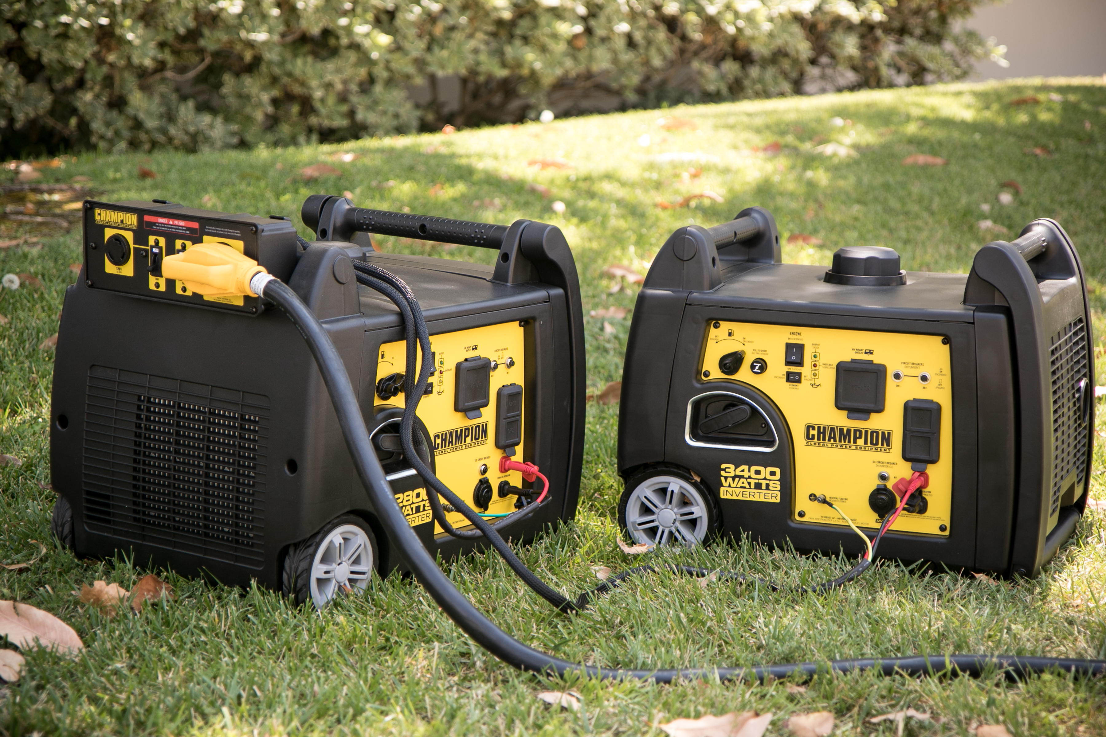

Spending $800 for a generator plug and line power disconnect, and buying a couple of portable generators I can use for all kinds of other projects seems prudent. The cost to store 15 gallons of fuel for the winter is ridiculously small compared to the misery that would ensue without it. I'm expecting we'd be hosting some elderly neighbors and families with young children as well. To the point of this thread, we chose a parallel setup for all the reasons already named by others:
Portability for unexpected needs
Reliability: "Two is one, one is none."
Lowest possible fuel consumption
Electronics-safe power that inverters generate
The downsides are:
Low output wattage for the money
Limited run time with internal tank

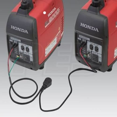

Numerous places on the internet on synchronizing and paralleling normal non inverter generators to a common bus. Never had a chance to try it but roughly you need generators of the same, type, size and frequency. You rig up a light where it is connected to the hot wire of each generator and watch the light. If the light is illuminated the generators are out of phase, adjustments are made to the governor until you get the lights so they are flashing at the slowest rate possible. Once you get a slow flash the breaker for the common bus is closed when the light is off and the generators will be synchronized and run as one. If they are combined when out of phase as they say bad things will happen and you will have large masses trying to correct and things will fly.
Video shows the concept.

Interesting.
If you are adept at building RF transmitters, perhaps not a big deal. Given the extent I see most people struggle with basic 12v wiring, not for the average Homer though....

Yep, how we paralleled them in school. But you gotta be able to control the field to get them in sync.
