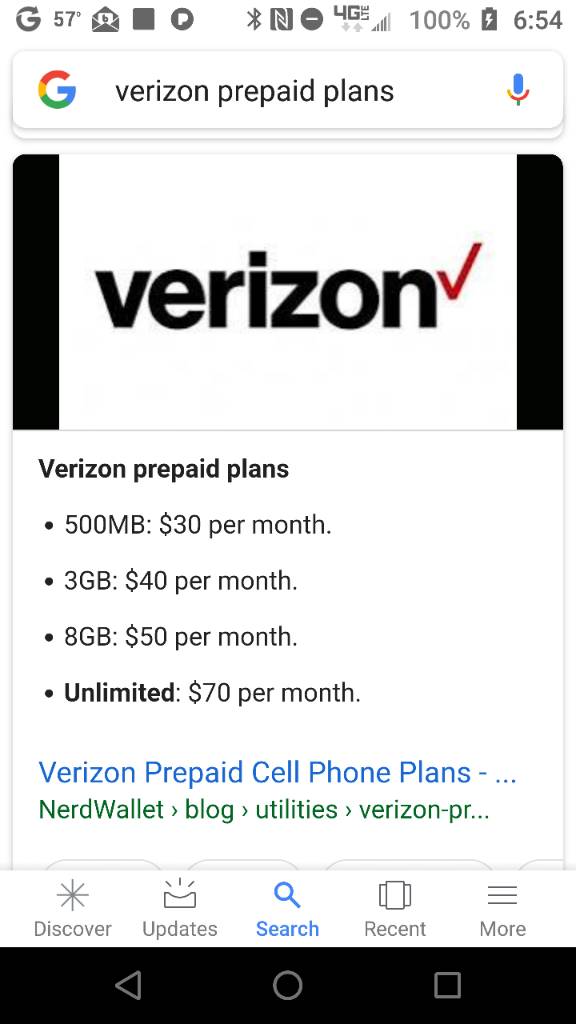

#55
It doesn't say anything about prioritization on this one. Of course, the only way to really know sometimes is to try it. Screenshot_20190116-185423.jpeg

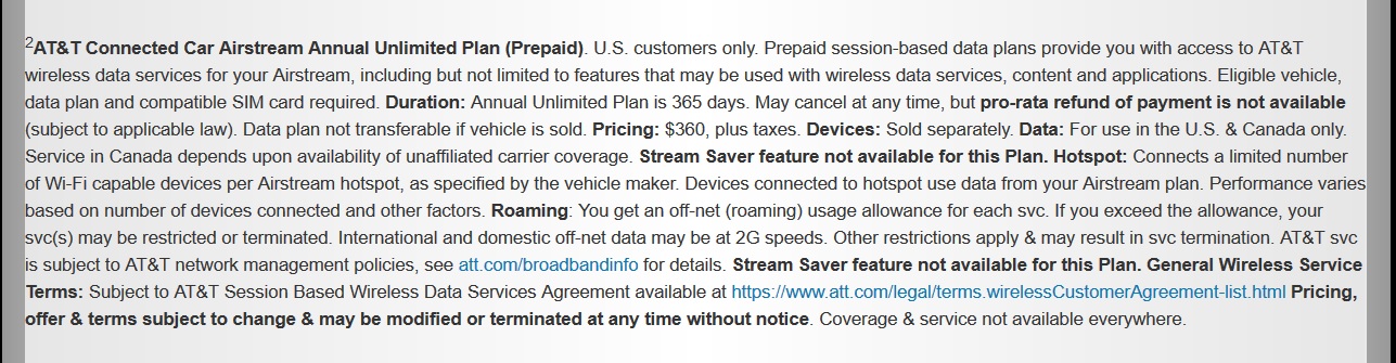

I got my $25 MiFi today so I was able to order a prepaid Verizon SIM for $65/mo unlimited with auto-pay setup, it should be here in a couple of days and I can see if it's as easy to switch the SIM into the Mofi as it looks like it will be.
Another thing I've noticed is that if I activate an AT&T SIM card on buyasession.att.com using the Mofi IMEI, my data plan options are $25/mo for 5GB or $360/yr for unlimited so, if the Verizon SIM doesn't work out, I can purchase the annual unlimited AT&T for $360 and drop from the $80/mo with Ubifi to $30/mo. There is nothing in the fine print on that one about prioritization or throttling after a certain threshold. (Plan and term screenshots below)
Verizon is 3x the speed of AT&T here though so, I'm hoping it works well, it's still $15/mo cheaper and I like fast better than cheap. That SIM will be here Monday so, I'll update then.

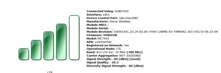

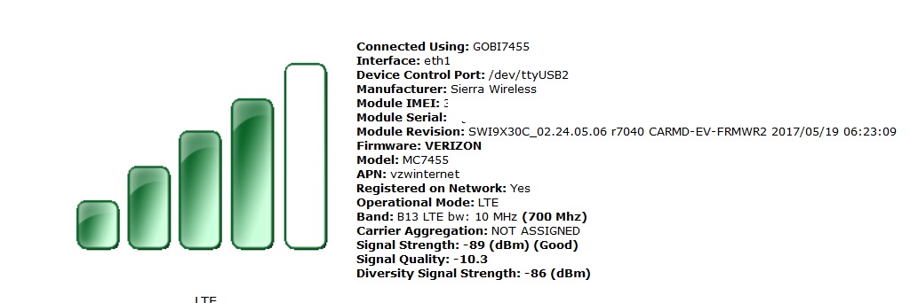

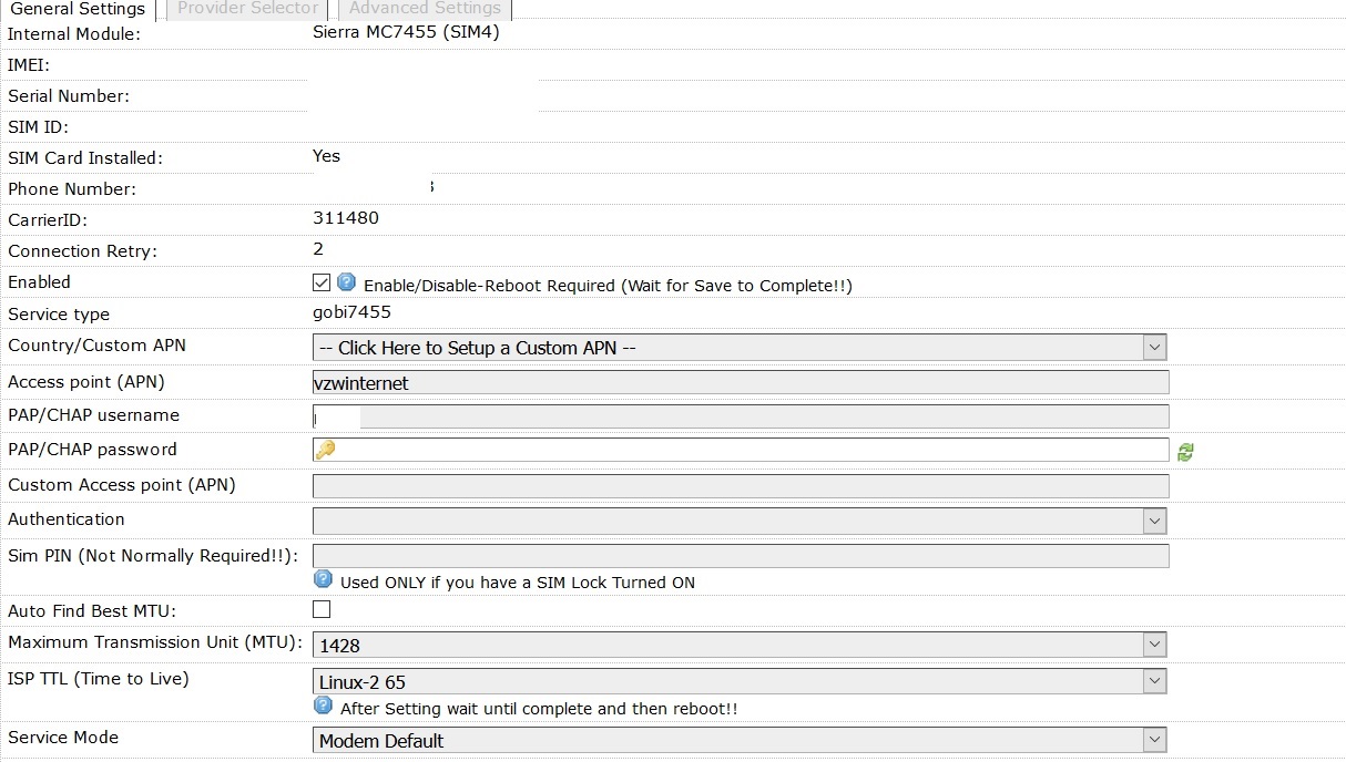

I got the Verizon SIM today, it took some trial and error to get it working correctly with the Mofi. Ultimately, these are the steps you need to follow:
1 - Put the SIM in the Verizon JetPack you used for an IMEI to order the SIM, power it up and connect. I think it needs this step for Verizon to verify the SIM went where it was supposed to.
2 - Insert the Verizon SIM into the Mofi and perform a factory reset on the device. When it reboots, it should detect the everything correctly and connect to the Internet. I setup a custom APN of vzwinternet. I'm posting a few images showing the signal strength, speed test result and my configuration for the Sierra card.
So now I find out if unlimited is truly UNLIMITED, I'll know within a week the way we go through data. Signal strength with from -105dBm on AT&T to -85dBm to -90dBm with Verizon and the speed test went from 8/3 to 26/21.
We're running on Verizon now, in fact I'm watching streaming TV and posting over it. I'll update in a week or so with our data usage and speed to see if we're getting prioritized.

We've used 70GB since I switched to Verizon so I believe this really is UNLIMITED unlimited. I have noticed that carrier aggregation never gets assigned with Verizon but, I'm still running at 23Mbps or higher whenever I run a speed test so I don't really need it, it's faster without it than AT&T was with it.
