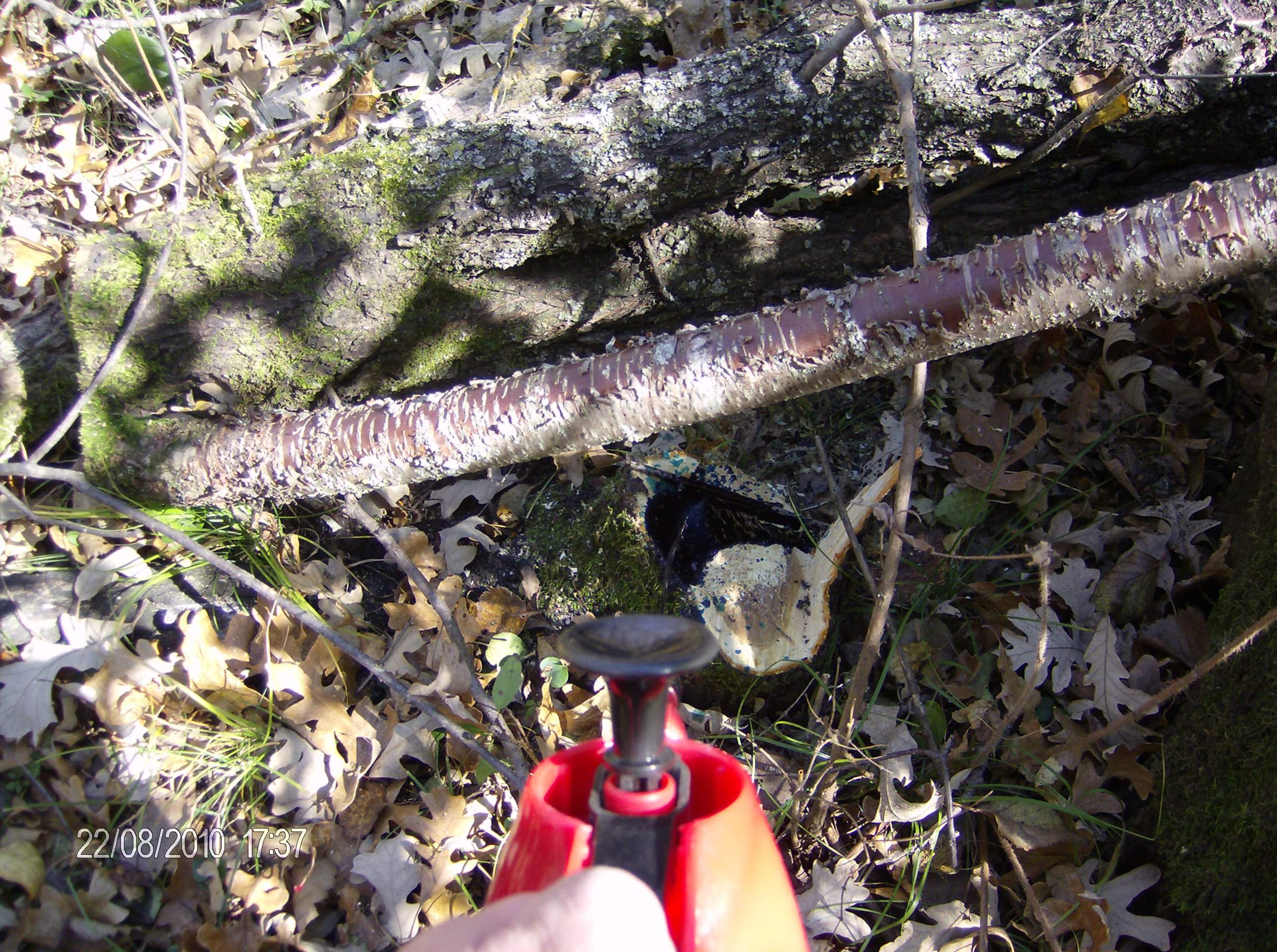

Check out the Dowagro web site. Here is how to treat stumps so they won't resprout.
Cut Stump
On this stuff, if you don't get all the roots, or just cut them off, they will sprout prolifically (10 stems instead of one).
For several very small stems in a "thicket"
Spray with a high-volume foliar spray (1/4% Forefront R & P + 1/2% Remedy Ultra (triclopyr) with 1/2% Methylated Seed Oil so the stuff soaks in. Wet the stuff next summer when it is in full leaf.
OR
D6 cat with a root rake and then use a foliar spray on what sprouts back.
For small diameter stems, you can use a basal bark spray, out of a small 2 quart sprayer. The solution is one fourth Remedy Ultra or Garlon 4 to three-fourths off-road diesel. A blue dye helps you to know where you sprayed.
For bigger trees, use the same percent solution as basal bark, but treat the stump right away after the base is cut with a chain saw.
Above, are some photos of Buckthorn eradication (another exotic species)
SC
