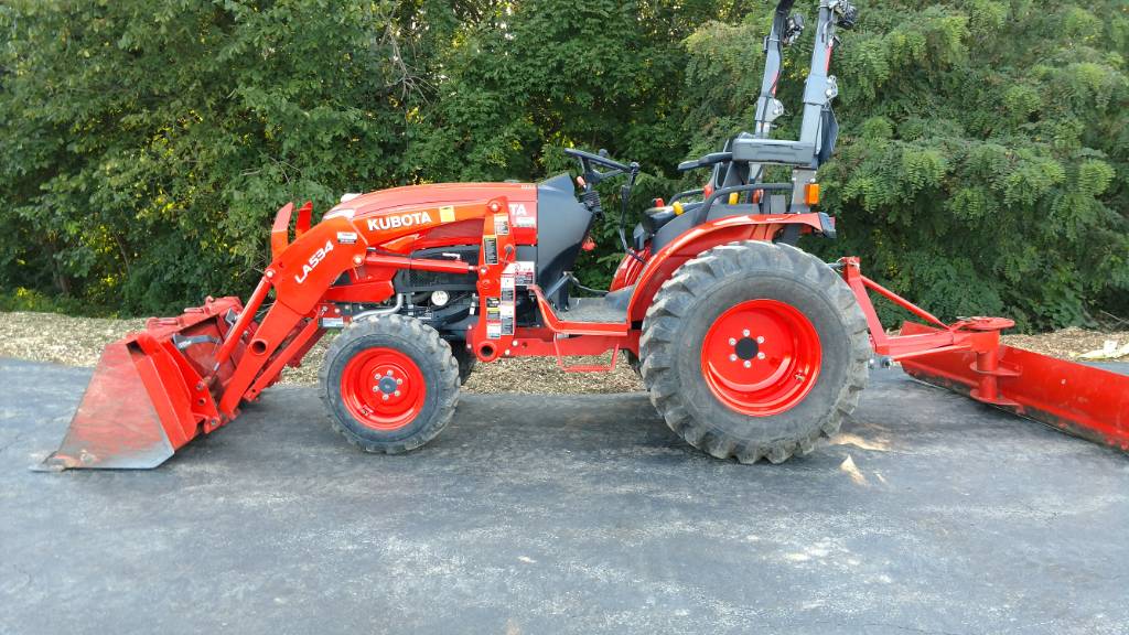

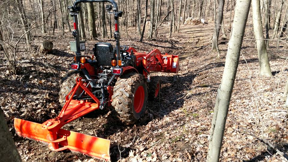

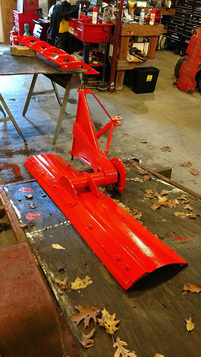

I may be the odd man out, but I got this many decades old rear blade for $100 2 years ago. It was sitting out behind a barn, not a spec of paint on it. It was covered in mainly surface pitted steel, surface rust (tightly adhered) with some loose scale. I knocked the scale off with a painters scraper, washed it with Dawn and hot water, pulled it into the shop to dry a couple days and went at it with a 3" paint brush and Kubota Rustoleum paint. It pretty much looks as it did the day I painted it aside from where the rocks and dirt gouged the paint off. I spent minimal time and effort on it and got maximum results. I would venture to say that I will have it another couple decades... or more. Maybe I'll paint it again in 10 years. Maybe not.
