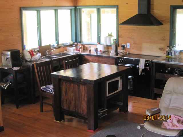

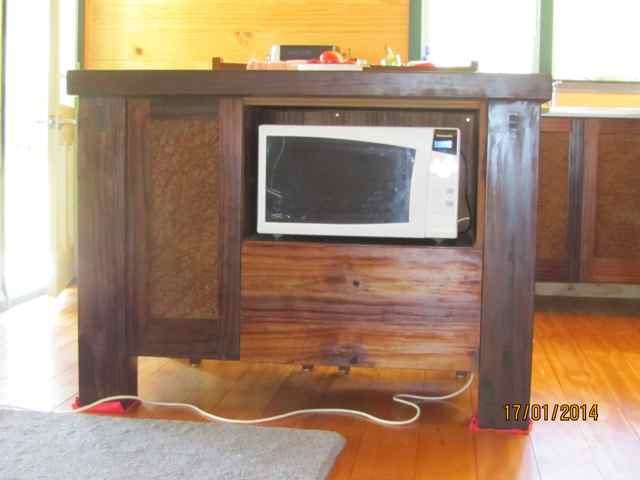

An update kitchen not finished but a couple of photos one showing the rusty steel panel dew to the problems mentioned earlier in the thread sealing the panels I have left them unsealed if they need cleaning they are removable and can be waterblasted outside and replace after they dry

Which process did you end up using to start the rust? Looks great!
What I went for was to find an old steel tank that had been out in the weather for 50 odd years It was rusted through in places I cut the panels from places that had deep pitted rust not through the eight inch plate but almost. The plan is to try without sealing I prefer the finish as is but if it doesn't work out I can always clear coat them latter
