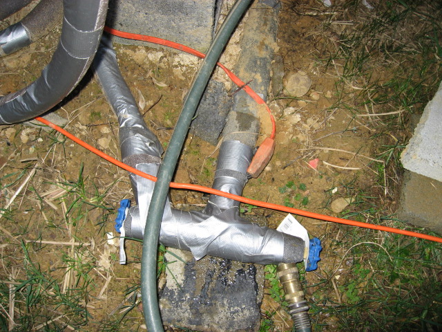

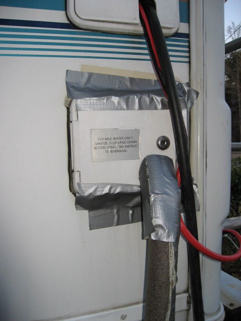

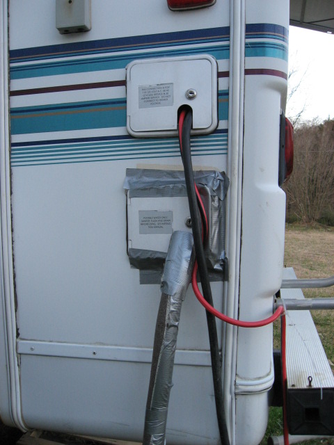

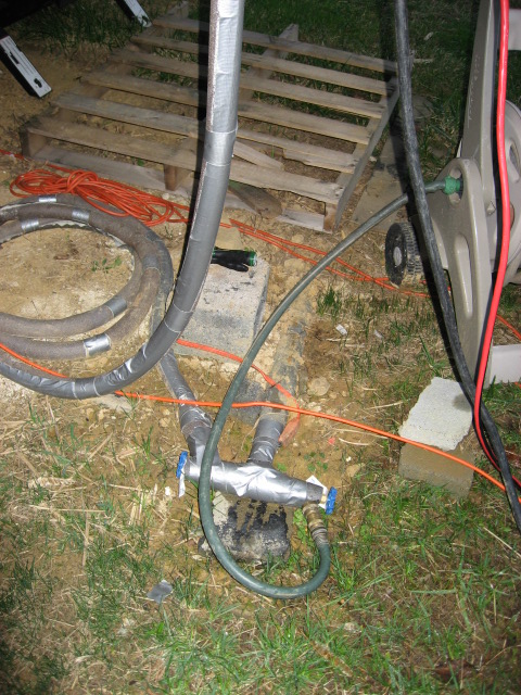

If there's electricity there, the easiest way to keep water flowing to the spigot is to use heat tape. If no electricity, you'll have to really insulate the pipes and use a frost free spigot assy........
   / RV water hookup for cold temperature #17
stumpfield,
I've been a full-time RVer for the past 10 years. We have had temperatures as low as 7 degrees F and still had water. I took some pictures of our water hose set up and have attached them.
We got heat tape from the plumbing section at Lowes. You plug it into an electrical outlet and it uses a thermostat to keep the water hose warm. We wire-tied the heat tape along the length of the hose, water pipe, water spigot, and camper hose coupling. It's very important that you be meticulous about getting all the exposed sections of the water line in contact with the heat tape. It only takes an inch of missed space to freeze the entire line. We then wrapped styrofoam pipe insulation around the hose and heat tape and used duct tape to seal the insulation. Done right, this setup will keep you water hose unfrozen for about any temps you should see in your area.
When the temps get down to the mid-20's, we open our lower kitchen cabinet doors and bathroom vanity doors so the inside water pipes get heat from the inside of the camper. Note: Our inside water pipes are located inside these cabinets. When the temperature gets into the teens we drip water in our two sinks. We have 2 problem spots inside the camper where the pipes want to freeze in extreme cold weather. One spot is where the water pipe first enters the camper from outside. This spot is accessible through a lower kitchen cabinet door. We've fixed this by placing an electric space heater by the open cabinet door during really cold nights. The other problem spot is where the water pipe that supplies the shower runs through the unheated basement area. We have an access panel to the basement area in our bathroom. We leave this panel off during cold weather to get a little heat to the shower pipes. This works in all but the coldest weather. Occassionally the shower pipes will freeze but not frequently enough for us to do anything about it. At one time I put a small space heater in the basement. Actually, a 100 WAT light bulb on an extension cord near the shower pipes in the basement enough to keep them unfrozen in our case.
