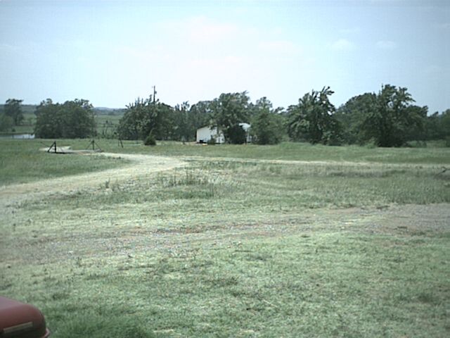

Its hot, I'm tired and lazy, so I just stepped out the door of the shop and banged out a few not very photeginic shots. First is row of pear trees with my mom's new house visible through them. Just to the left (south) of that is a couple ponds (she likes to fish so I put her house by a couple ponds that are pretty to look at and produce 6-7 lb largemouth bass as well as crappie, bluegil, sunfish, perch, and something I haven't identified but it isn't very big (haven't seen catfish in these ponds). Left of those ponds is the hay barn. Just visible to the south of the barn is another pond but you can't see much of it. Maybe one day if everyone doesn't cry "EGOTIST" I'll cruise the place in our little 4WD Dakota we picked up for a farm truck and snap some pictures that show the place to good advantage. From my vantage point you also see my burn barrels, "NEW" overhead diesel tank (4 hrs in sun at auction) and a collection of implements including the cement mixer still in the crate (did I say I was lazy?).
I think I have noticed that you can only send one picture per post so I will attach one to this and send some basically (place holder) posts to xmit others. Hope these shots aren't too depressing. The place looks better from several other vantage points.
