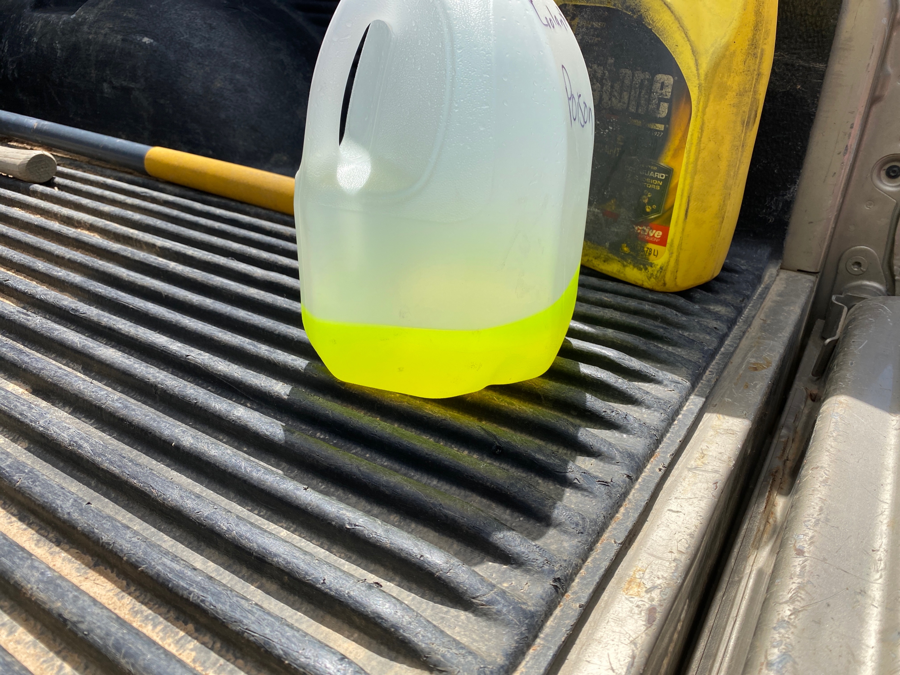

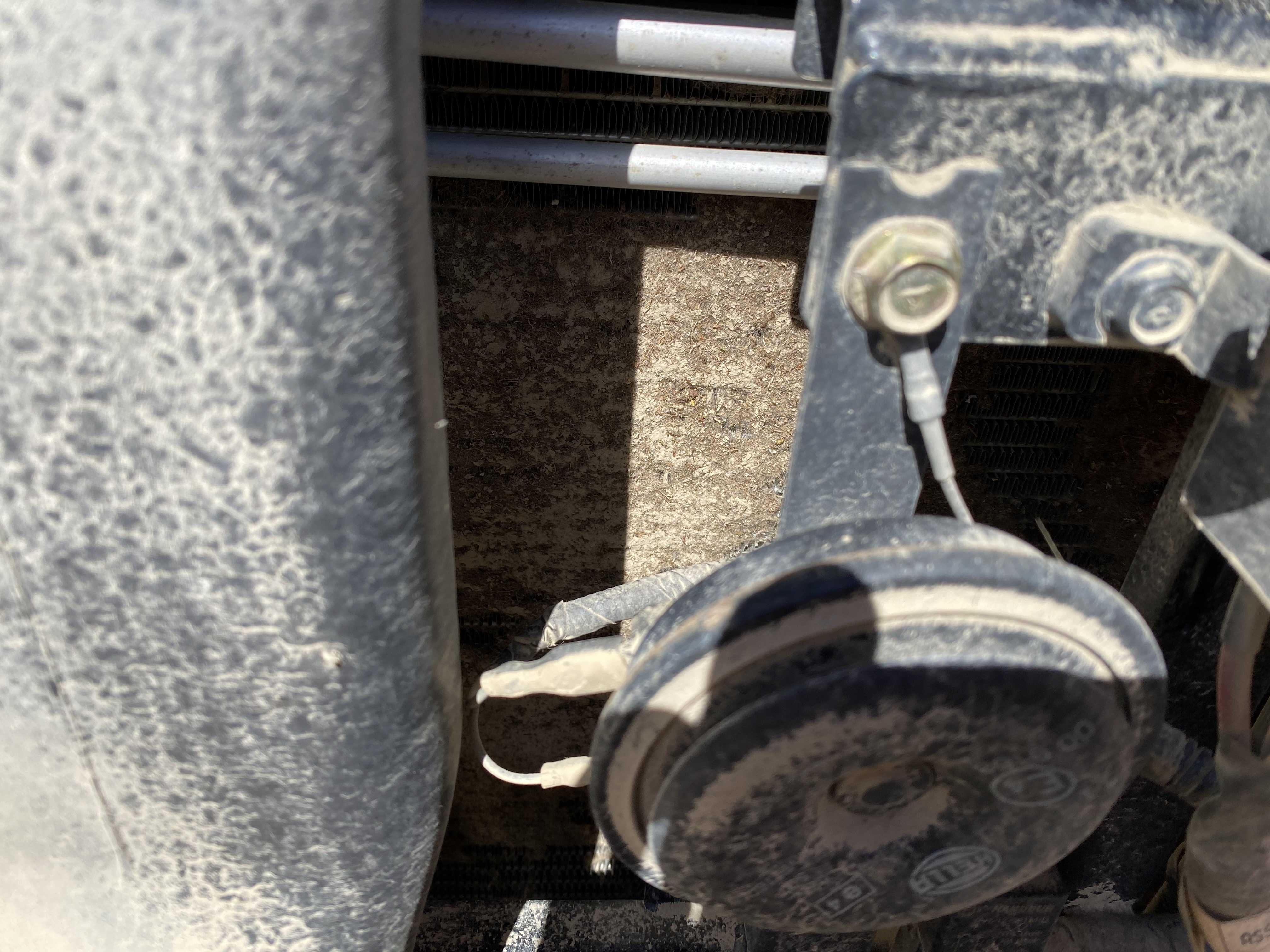

Last night I was going to use my tractor to pick up some large rocks. 500lb and up. Input my grapple on and my boxblade then drove 1/4 mile to get to my trailer with the rocks. Just before getting to the trailer I felt a loss of power and saw that it was over heated. I dropped rpm and let it cool. I popped hood and there was a big mouse nest on too of radiator. I removed that and cleaned the screens. The reservoir was empty. I filled that. Restarted the tractor and about 5 minutes later it overheated again. I shut down again and checked engine area. The reservoir was still full.

Before you spend money on parts, I'd recommend blowing out the radiator and such with compressed air and an appropriate tip wand. You'd be surprised how many people (myself included) cleaned the screens, but still had tons of junk jammed in their radiator(s) that we couldn't see. Could save you a few bucks. :)
Haven't lost anything but a few minutes of time if your radiators are already clear.

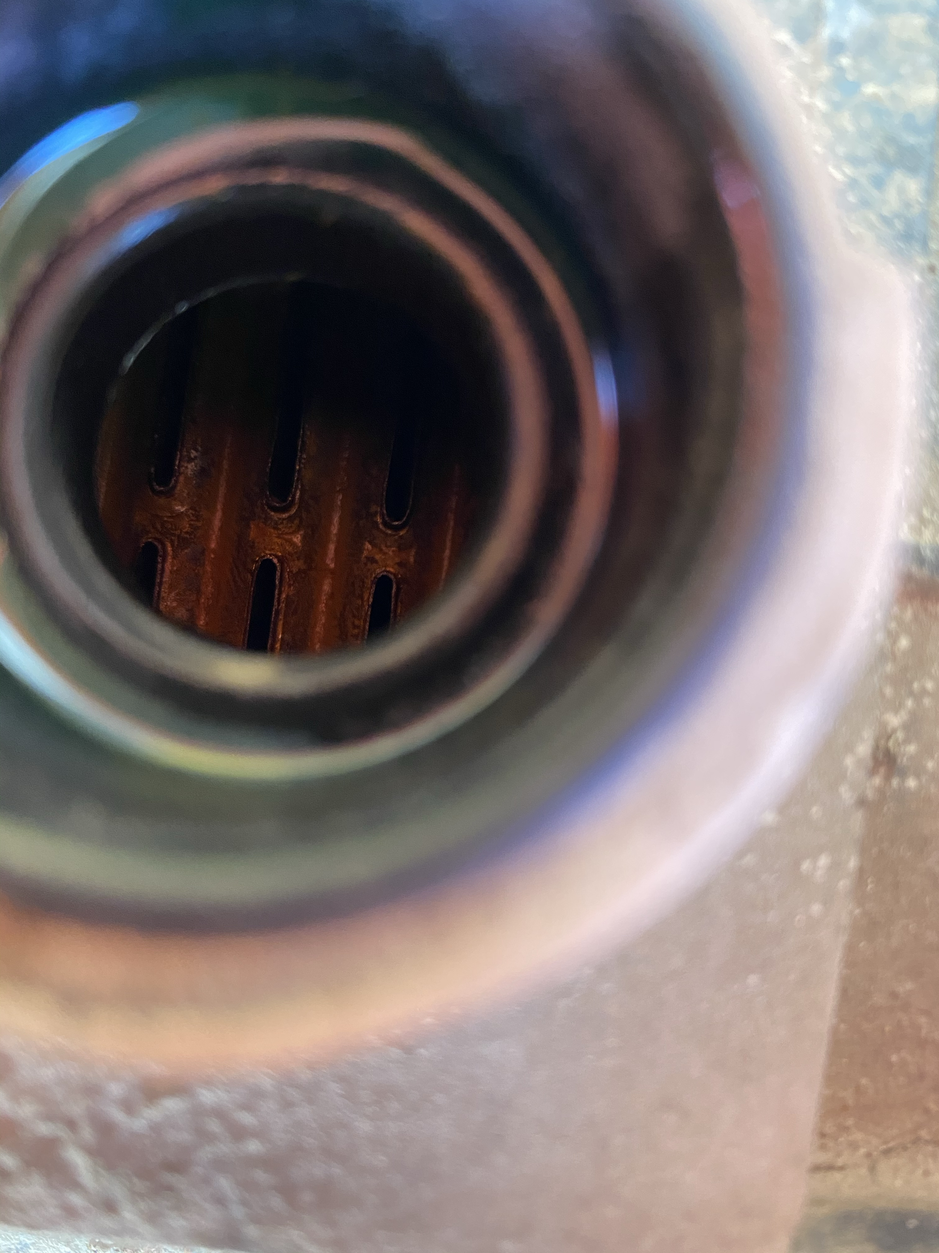

I got back out here this morning. I pulled the screens off. And the radiator fins are completely clogged.
Also, I pulled the radiator cap and there is no fluid that I can see. Looks like I have multiple issues.
I just put nearly a gallon of 50/50 coolant in.
I just spent 15 minutes blowing it out from behind with my pancake compressor and a generator.
There was an astounding amount of dirt and fluff and debris that came out.
I am hopeful that this will resolve my issue.
But that would not explain why my radiator was empty
