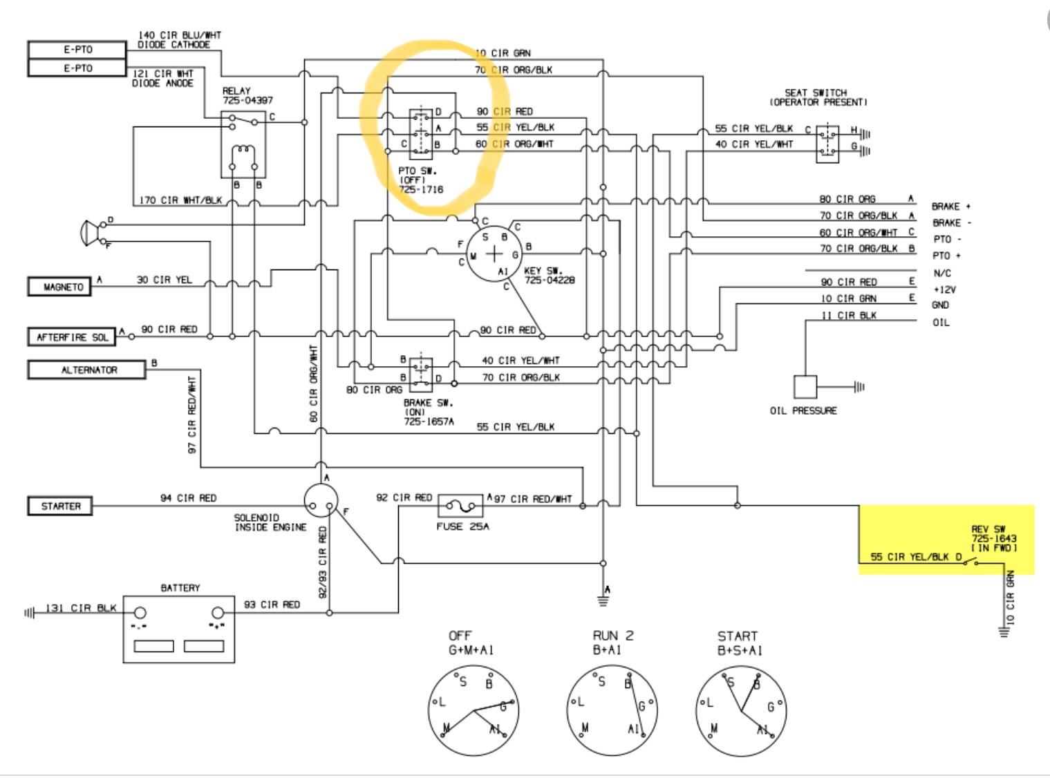

Diagrams show the PTO switch as having 2-normally open contacts and 1- normally closed contact (2-N.O., 1-N.C.).
Your description makes it seems like the N.0. and N.C. contacts are wired in reverse, making it seem the switch operates in “reverse”.
Any way for the switch and/harness to somehow be plugged in upside down?
Most likely a couple wires got swapped with the new pigtail/plug.
That is, a wire that goes to a N.O. contact now goes to a N.C. contact and vise-versa.
Or the relay shown to the left of the switch was somehow re-wired backwards.
Do the wire colors match up across each contact and through plugs like this?:

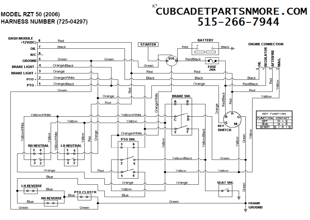

The PTO switch plug is oriented properly and the wiring is all done per OEM except for that new blue wire that was run by a previous owner because the original has a break in it somewhere. I don't see any relays anywhere, so that may not be the right schematic. Attaching the schematic I've been going by.
I haven't tried plugging the old switch back in to see if it has the same issue, could give that a shot tomorrow.

   / RZT50 - PTO switch off turns on PTO? #6
So the interlock (not allowing a start) and dashboard indication that the switch is on when you’re trying to start works correctly.
The operation of the switch for the PTO clutch itself seems reversed.
Check that pins 1 and 4 operate correctly. Switch should be open when switch is down.
Correct. Switch works normally for the interlock/dash light, works opposite when operating the PTO clutch. I've looked over that schematic multiple times(the one I linked above), but I'm not seeing how it's able to act like that unless it's a faulty switch.
I'm pretty sure I still have the original switch to try, but I want to make sure I'm not overlooking something that may be obvious to someone else a bit more experienced with wiring diagrams before I go pulling that side of the mower apart again.
   / RZT50 - PTO switch off turns on PTO? #8
Check that pins 1 (red) and 4 (blue) operate correctly. Switch should be open when switch is down.
#9
Those pins have continuity when switch is down/off. With plug removed from switch, blue/red have continuity.
Tested the old switch, same result across those two pins and same functionality as the new switch.
