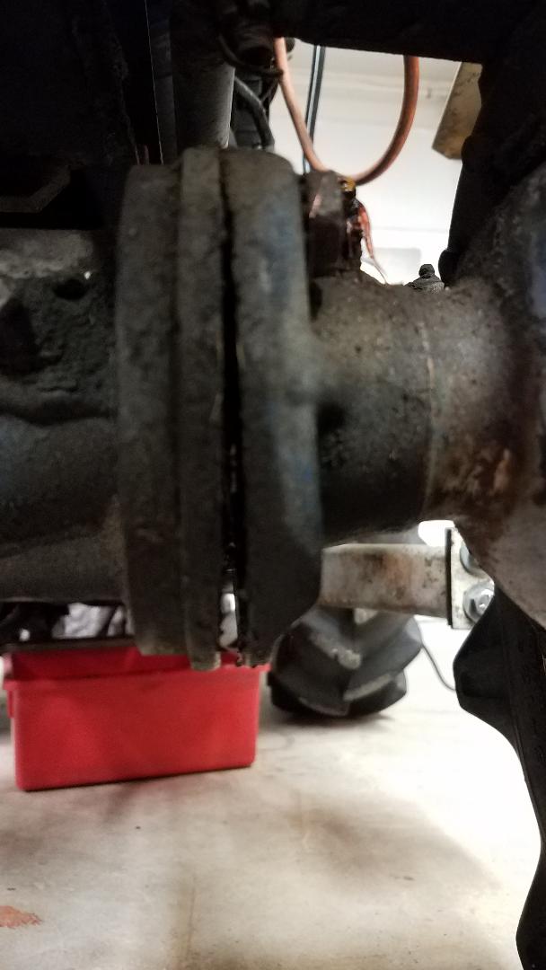

Hi,
Bought a S370 Beaver and was going over it. I found one of the bolts snapped on the front differential to knuckle housing. There is about 1/8 to 1/4 gap between the two housings on the bottom. The top is touching. Both sides are about same. (see Pic)
I'll have to pull the knuckle assembly to get the broken boltout.
I assume they should be bolted up tight against each other?

Yes they should be tight to each other...
   / S-370D Front differential knuckle housing #4
I would use new bolts also, good luck

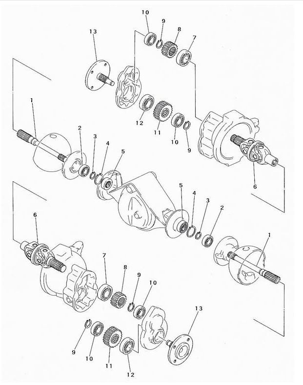

I took it apart to drill out bolt. Dang bearing was out too. Both sides. Not really surprised being it was angled.
Have to find bearings and figure out how bearings goes in. From the looks of it, bearing is snap ring to shaft and shaft has to come in from the hub side.
   / S-370D Front differential knuckle housing #6
I think your gonna need a shop manual:)
