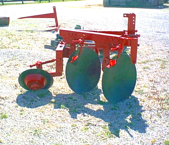

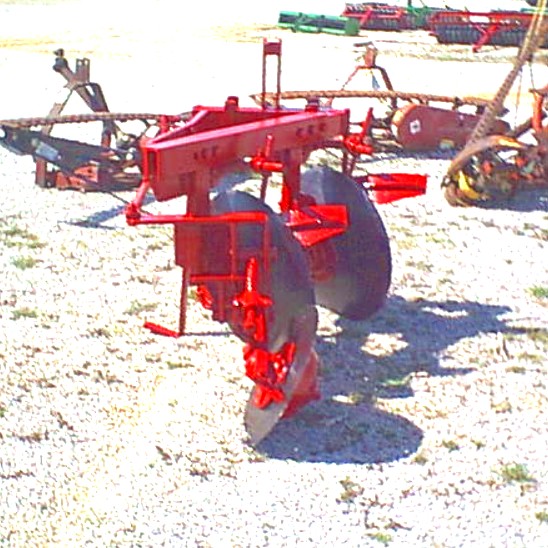

This should do it at 400 lb per disc. Ken Sweet

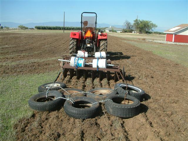

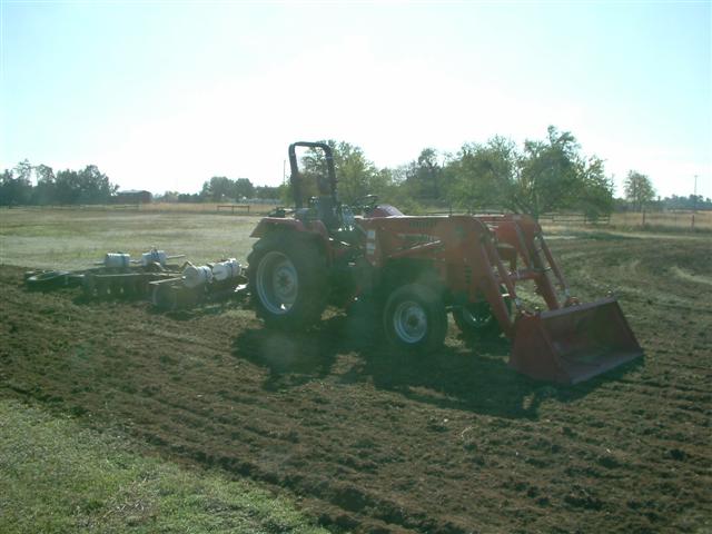

Add more weight. I have an old 6-ft Towner offset disc that weighs about 800 lb. I use 4 concrete weights that add about 500 lb. Blades are 20" dia--9 and 9. So I working at 72 lb/blade.
The disc is set at an aggressive cutting angle and I pull it at 5-6 mph with my 2008 Mahindra 5525 (54 hp engine, 45 hp pto, 2WD, gear tranny). You have to pull that disc at high speed to get it to work effectively.
I wait for the first rain in Oct (fire hazard, our rainy season is Oct thru May) and then start by mowing the hayfield with my brush hog as low as possible. (That was last year. Since then I bought a 68" wide flail mower for this job--lower cut. I'll be mowing my 6-acre hayfield with that baby in early Nov after the burn ban is lifted and the fire season is over).

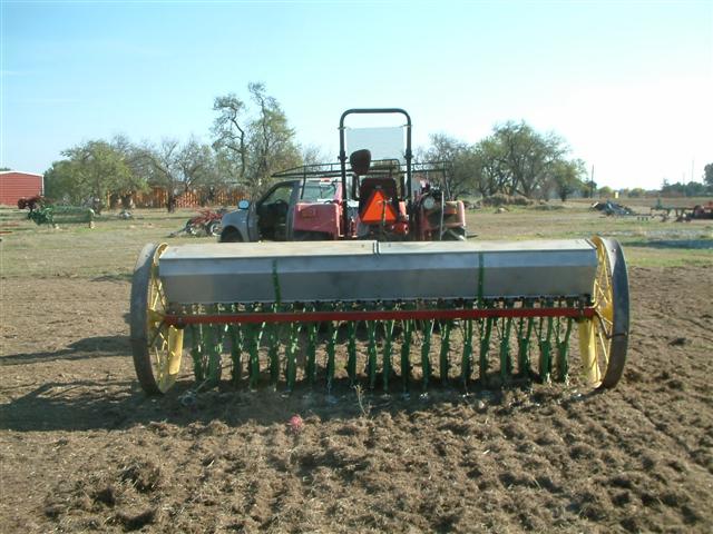

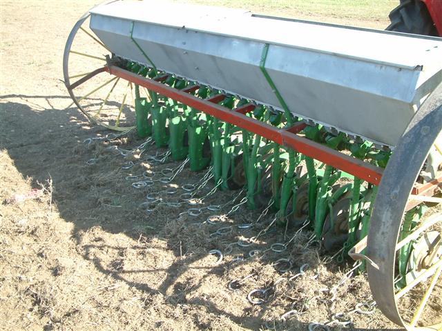

Then I run the disc in a criss cross pattern over the field, which is bone dry. After the first soaking rain I repeat the discing and then plant (Kanota oats) with my restored Minneapolis Moline P3-6 grain drill (10 ft wide, 20 drops, single disc openers)--mid Nov planting, bale in following May.
