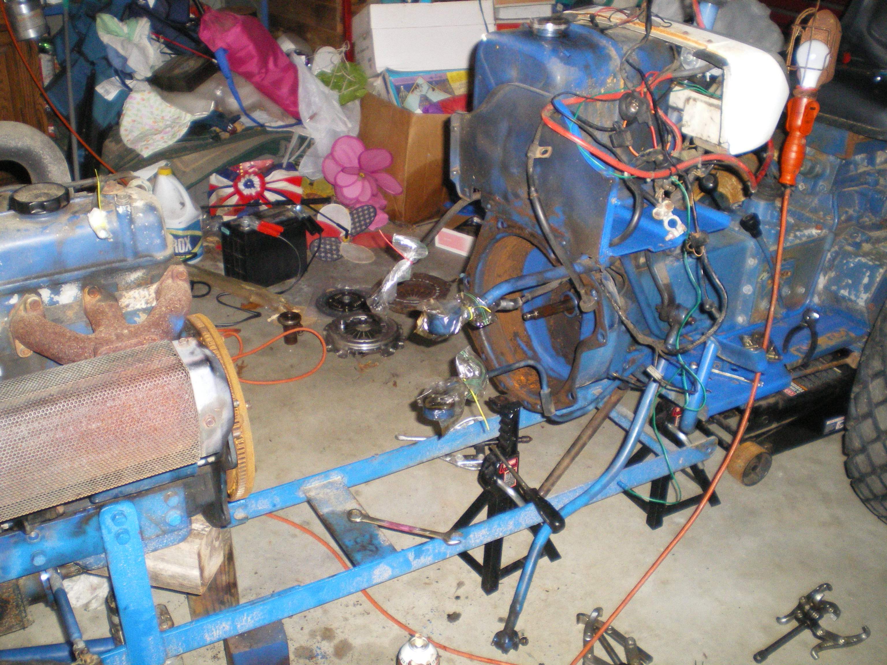

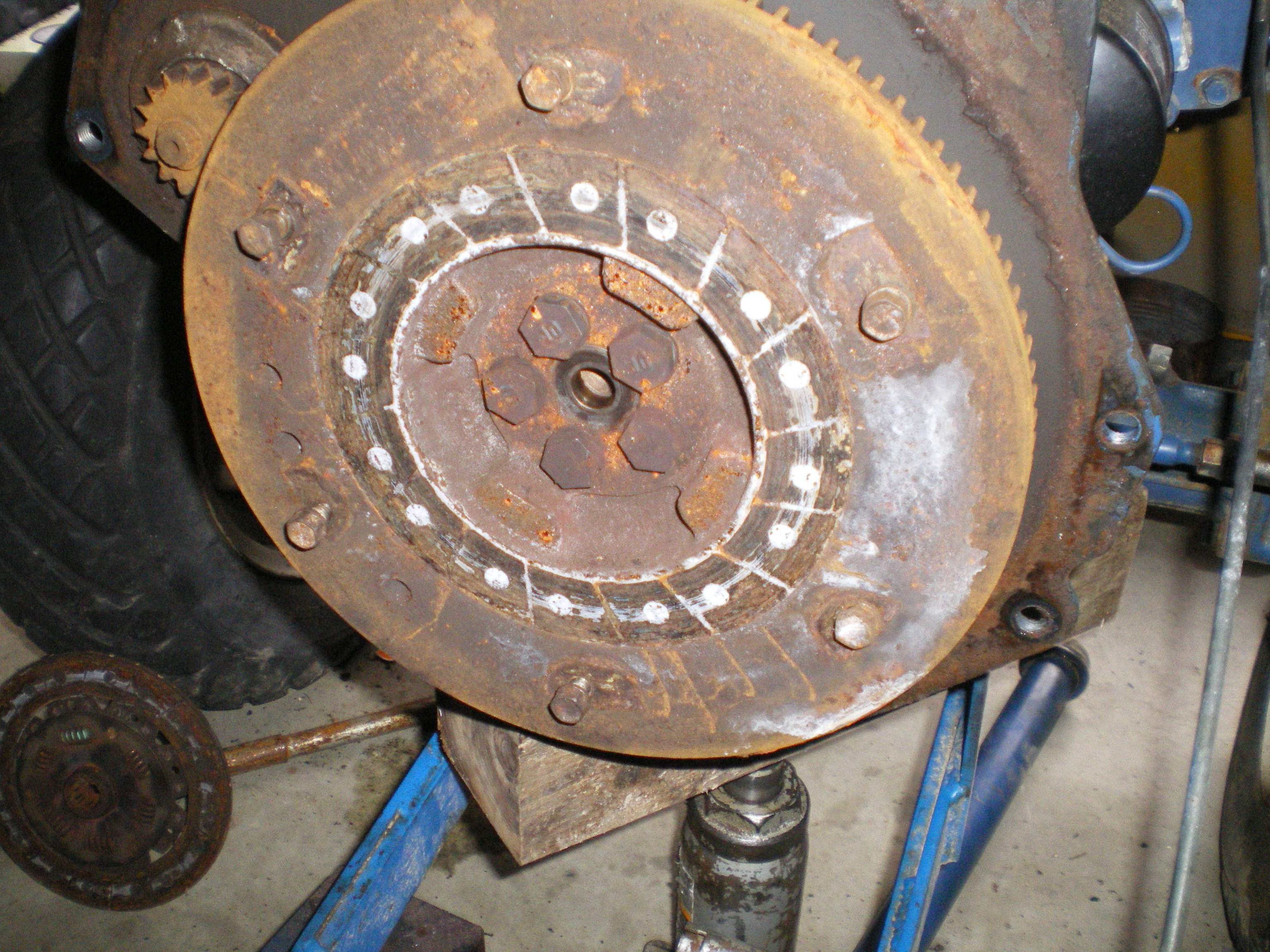

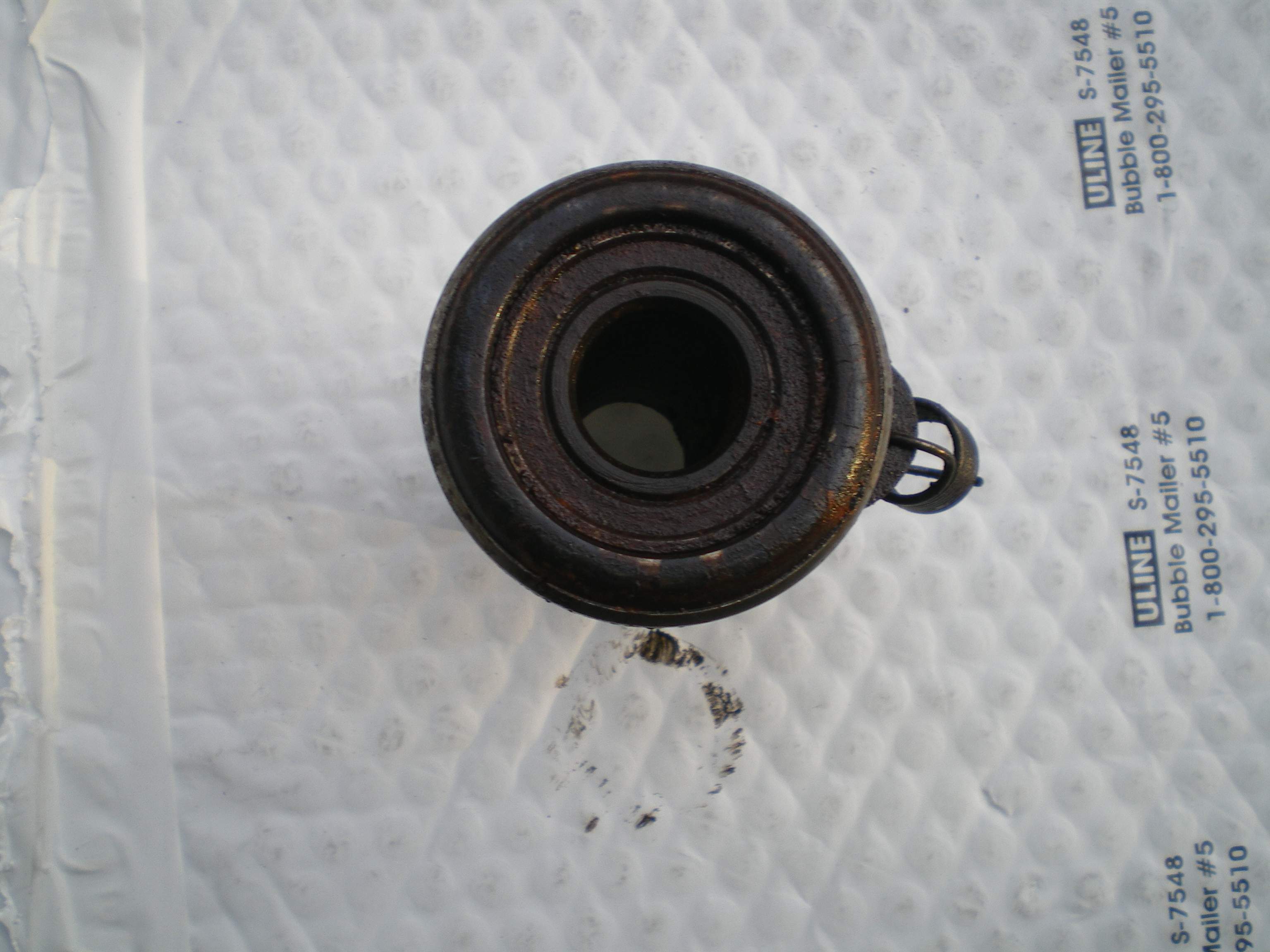

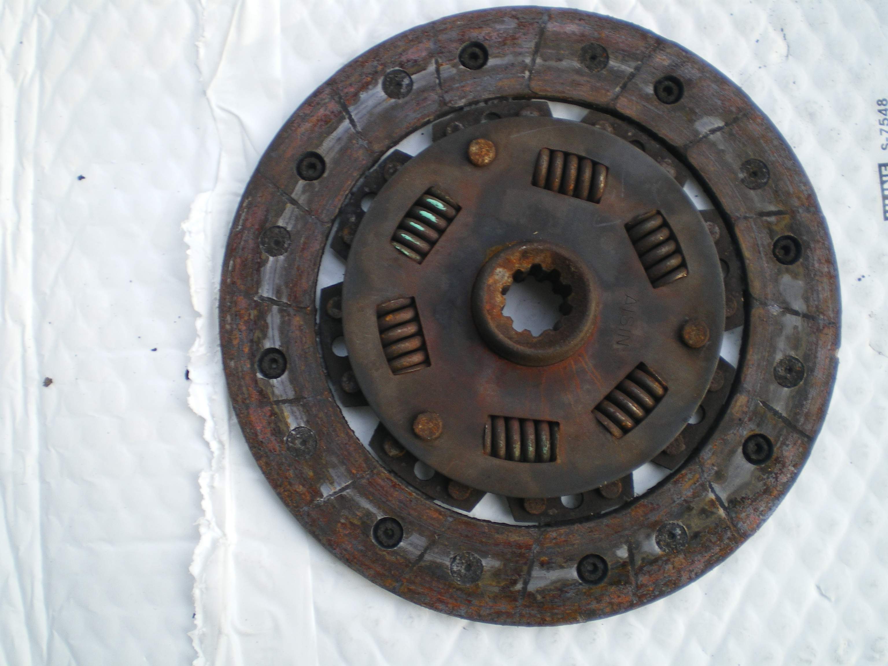

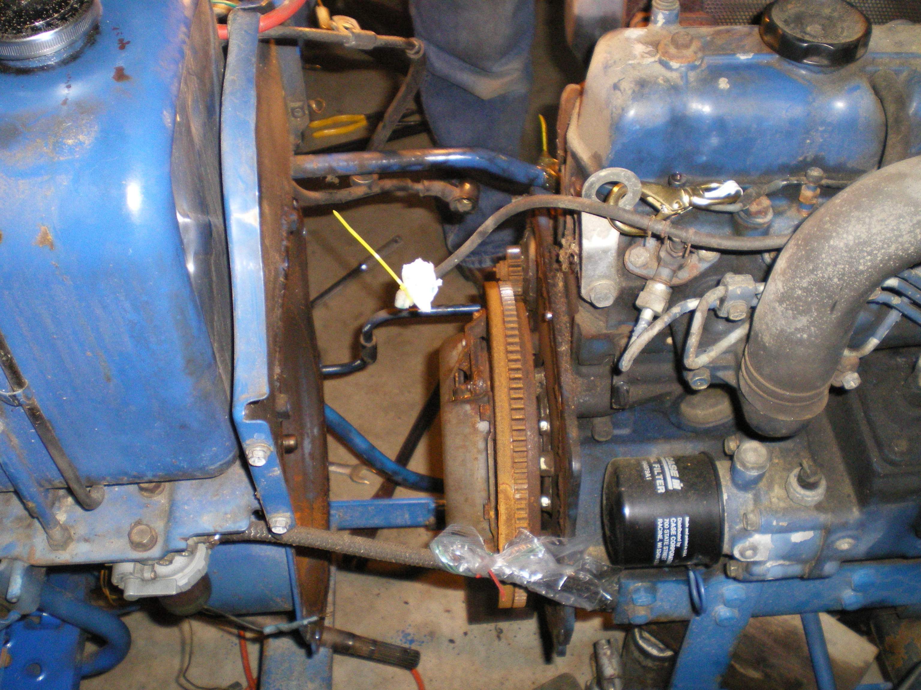

Thanks guys for you input. Took me most of the day to split and replace clutch and bearings. But an interesting project. Hopefully don't have to do this again real soon. :) Will attach some pics if I can figure out how.

Boy, that was a lot of rust. Glad you got it done.
   / S470D Buck Clutch Problem #17
Yeah looks like you made the right call...bet it works good now.
   / S470D Buck Clutch Problem #18
I am assuming that the collection of sockets/extensions is your alignment tool.
Did you have the flywheel resurfaced?
