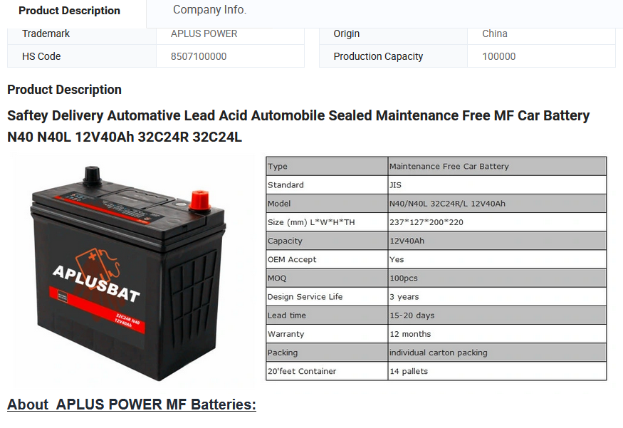

40Ah battery would fit in the palm of my hand, it's sooooo tiny.
Now for the N40 and N40L size,
The size is in mm as LxWxH and TH. 237x127x200x220 in metric
For American English size, 9-3/8 x 5 x 7-7/8 and with the posts sticking up, the Total Height is 8.66 inches.
From the image you can see the neg/pos posts locations.
Now with all this info look up the US battery sizes to match it.
The lawn and garden tractor group-22NF 12VDC battery is the closest size to fit to a N40L size.
See if it would fit in the spot on the tractor.
