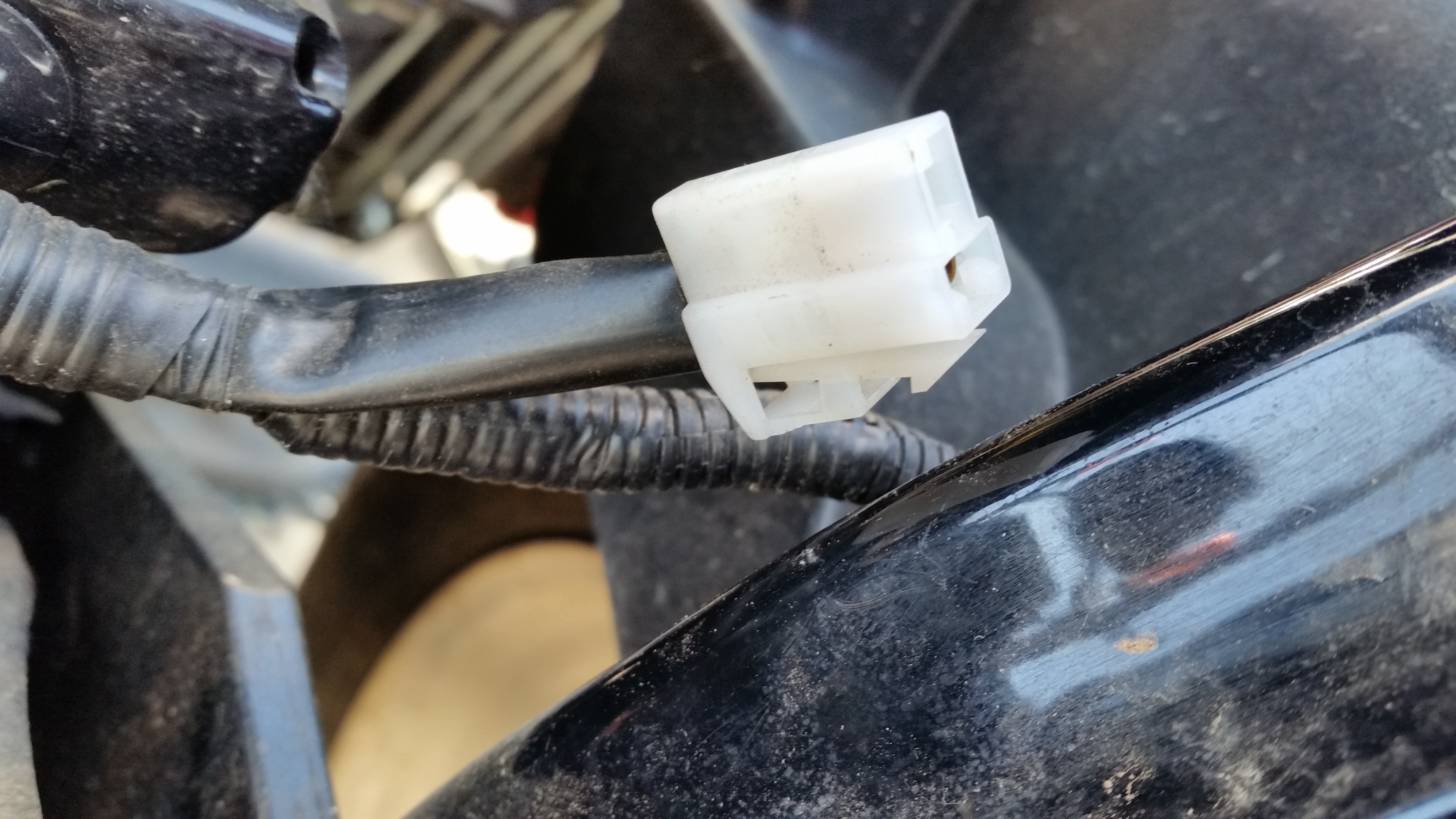

Similar to you - I've got a 12 V, tow sprayer that I need to hook to my 424.
I'm intending to hook it up, as it was on my last machine, with a flat four trailer hitch connector, so I'm not planning on using the power port connector. I looked around the left fender where the power port thing would go, but didn't see any wires.
Any suggestions where to look for wiring - or which fuse controls the power?
Where does the switch for the work lights go? (is that on the left fender?)
Thanks.

The switch for work lights are on the lights there plug and play very usefull
   / SA 424/324 12V Power Outlet #5
So I see a plug behind the seat near the right hand ROPs support. Is that where the work lights "plug and play"?
Thanks!
   / SA 424/324 12V Power Outlet #6
Yes sir comes with every thing you need even zip ties
   / SA 424/324 12V Power Outlet #7
I just checked out that plug. It's located behind the seat, starboard side. This is a photo.
I'm showing it here as an upside down "T". The vertical part of the "T" is the negative side. The horizontal "top" (which is on the bottom in this photo!), is the positive side fused through the ACC 15Amp fuse and powers on and off with the ignition key. (Yes mine has the other half of the fitting/cover which I've removed for clarity in this photo.)
I've looked briefly, but haven't found the connector for sale. In fact, I've stopped looking. I've come to the conclusion that I'm not impressed with the weather resistance of this fitting and, when the time comes, I'll be replacing it with Weather Pack type fittings as described below.
