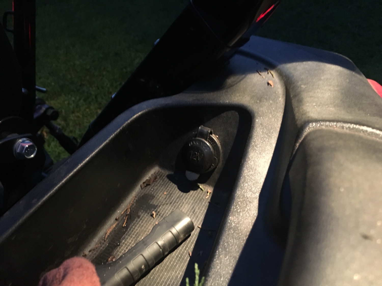

I just checked out that plug. It's located behind the seat, starboard side. This is a photo.
I'm showing it here as an upside down "T". The vertical part of the "T" is the negative side. The horizontal "top" (which is on the bottom in this photo!), is the positive side fused through the ACC 15Amp fuse and powers on and off with the ignition key. (Yes mine has the other half of the fitting/cover which I've removed for clarity in this photo.)
I've looked briefly, but haven't found the connector for sale. In fact, I've stopped looking. I've come to the conclusion that I'm not impressed with the weather resistance of this fitting and, when the time comes, I'll be replacing it with Weather Pack type fittings as described below.

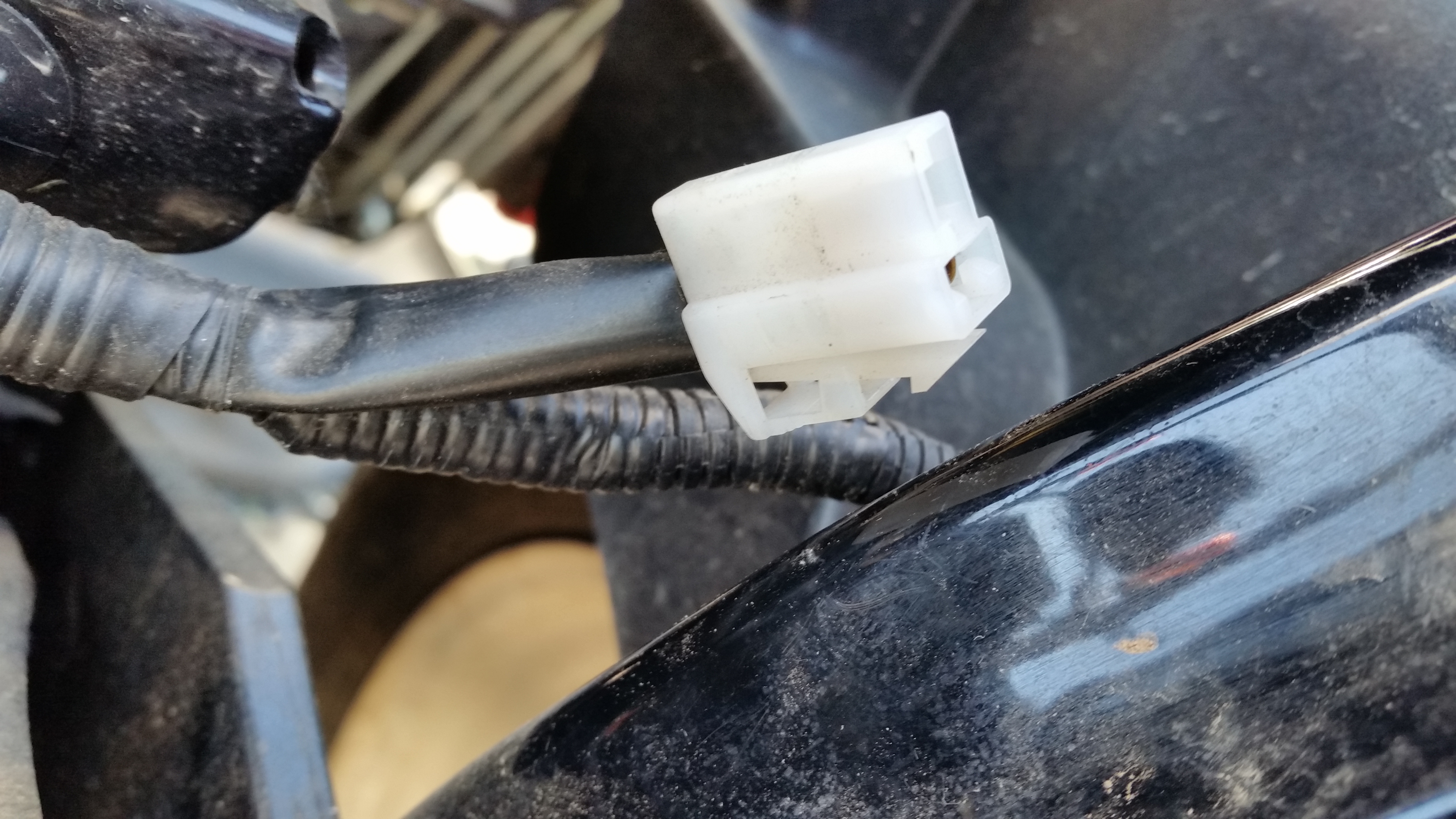

Sorry to bring up an old thread, but do any of you know what this connector type is called? If you do not get the Yanmar branded ROPs lights, how do you ensure the connector they come with will be the same?
