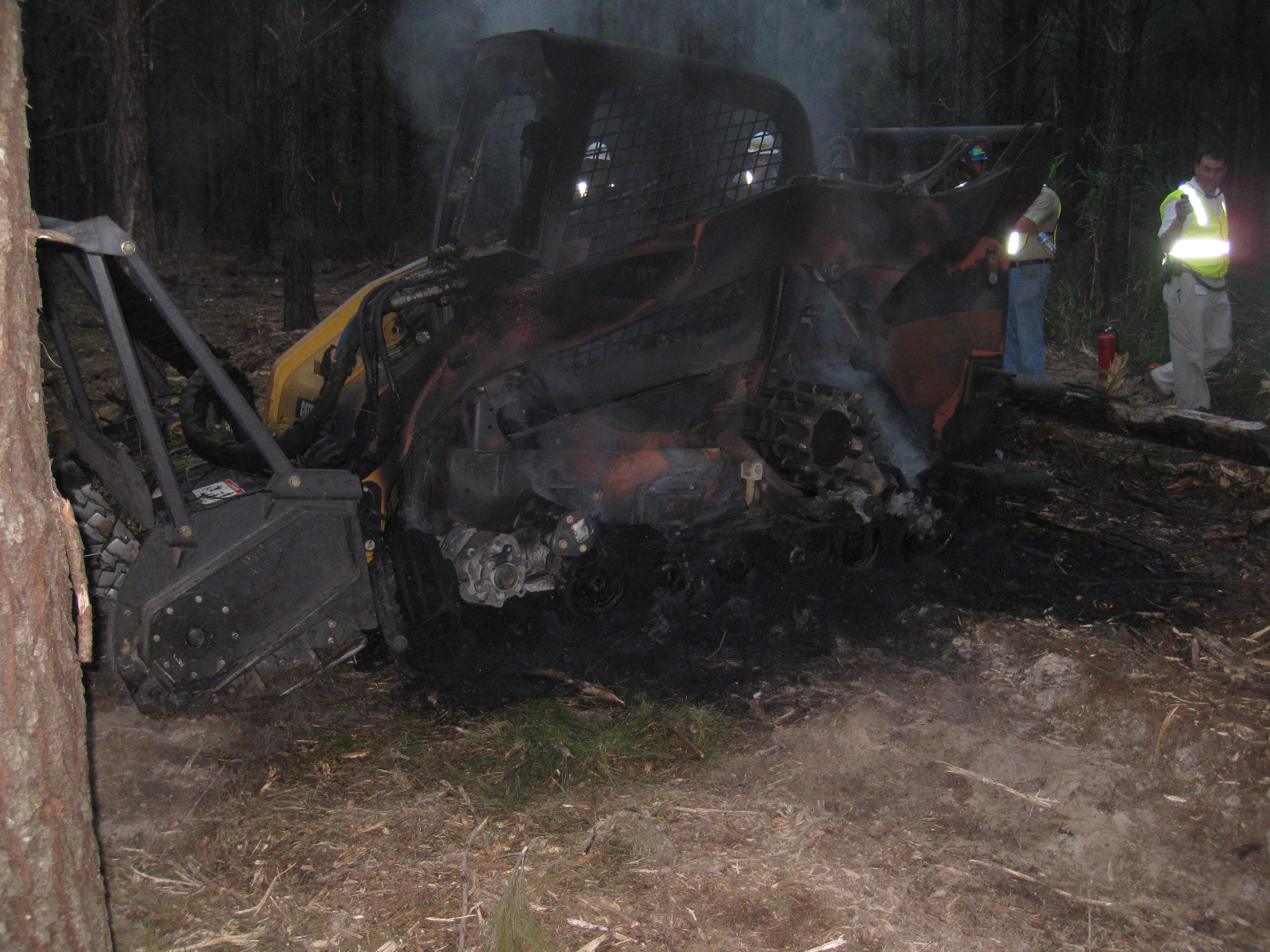

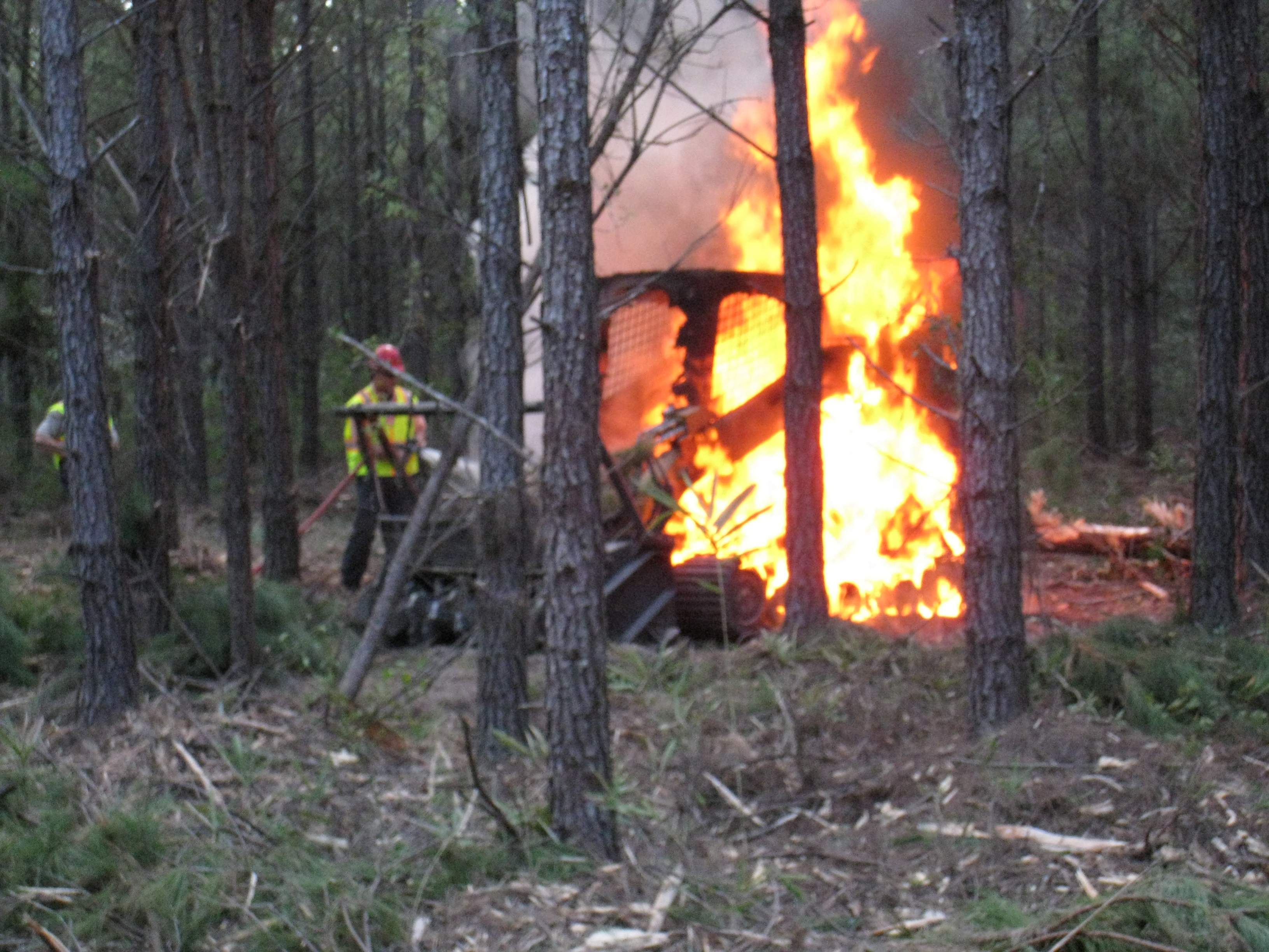

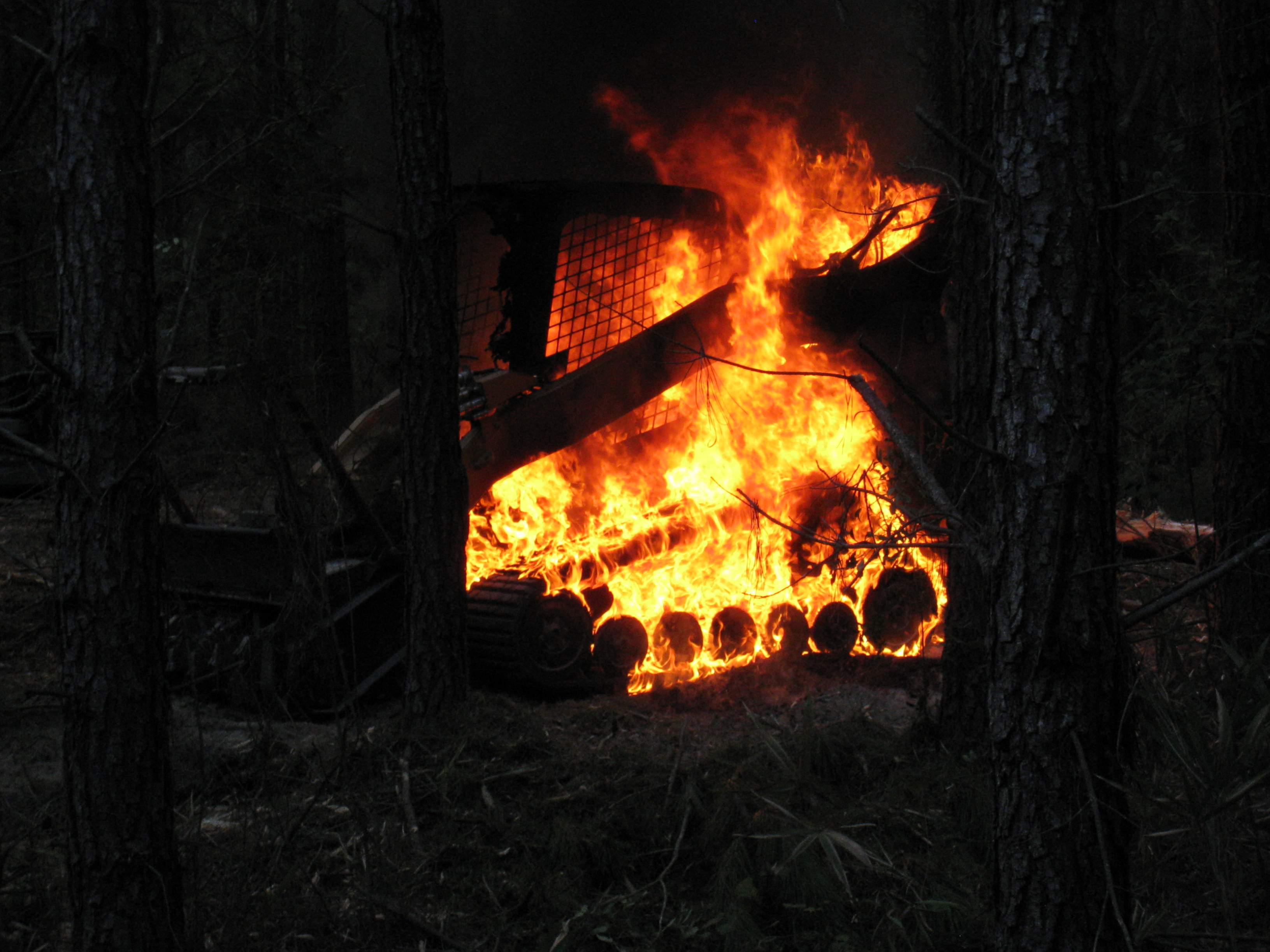

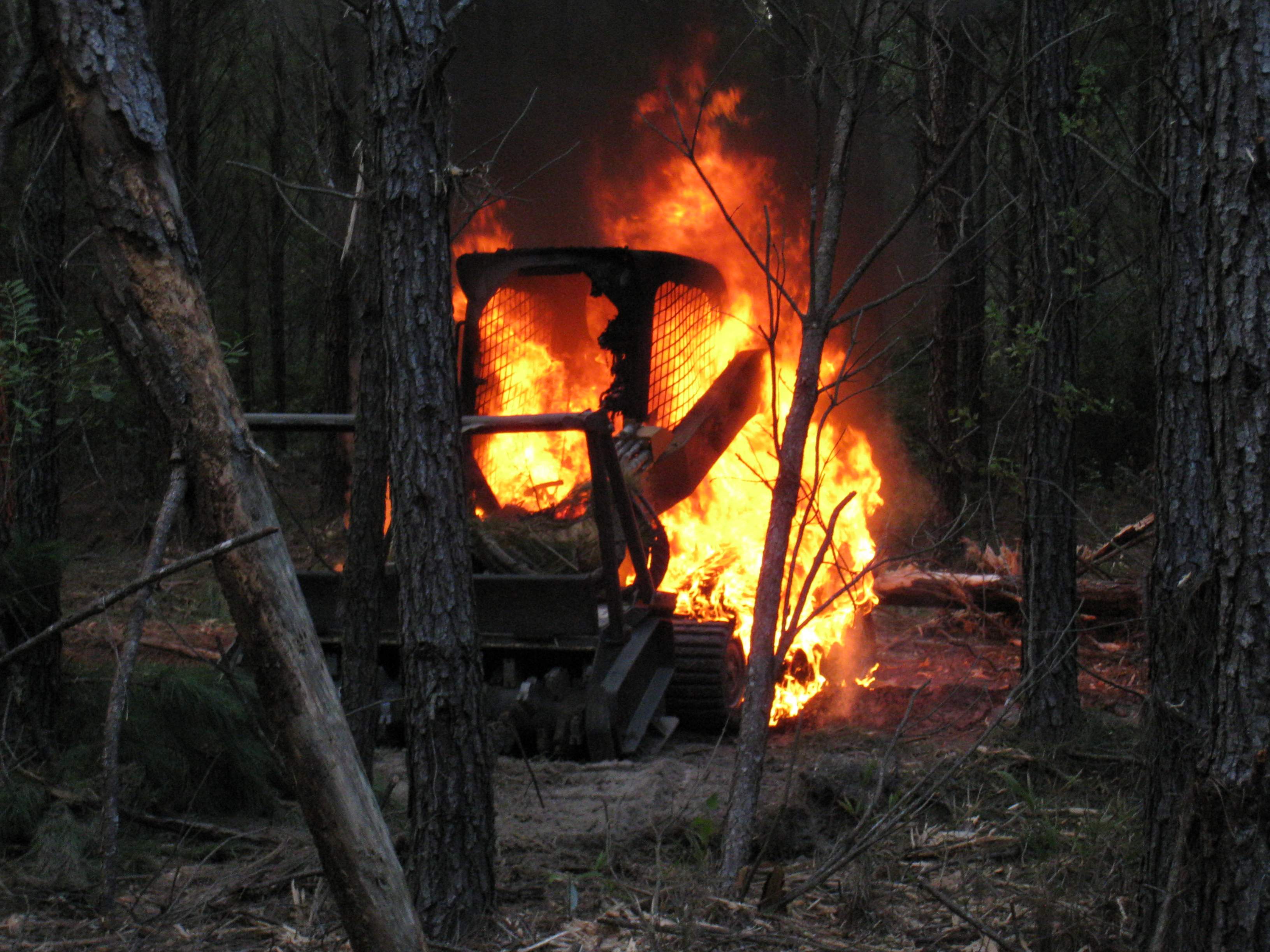

Sorry bout your machine, I had to watch my friends machine go up in smoke a couple months ago. He just bought it a month before it burnt, here some pic. We were working on a new steel mill being built in Mobile, Alabama cutting buffer lines, when it caught on fire.
