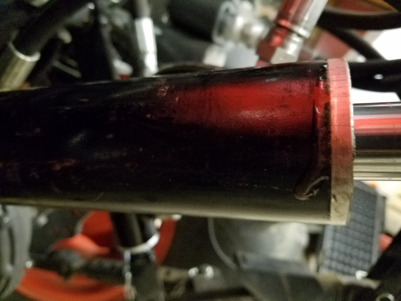

Fallon, those are not Kubota cylinders. In fact, they look identical to the A&I cylinders I bought for my L3200 (about $180 for the top link and $120 for the side link -- mine both were "new old stock" made in the USA from the 1990s, but I understand new ones are cheapo Chinese crap). They have been fine on my L3200 with no leaks or issues, but I sure wouldn't want to be sold those for an L4060 and told they were from Kubota. I'd wager you paid a lot more too. I'd send those back to the dealer and tell him you want OEM, not budget crap.
If they are the same cylinders I think they are, then the stroke is probably not nearly enough for your L4060, never mind that they are too small in general.
   / Sad story of Kubota TnT #23

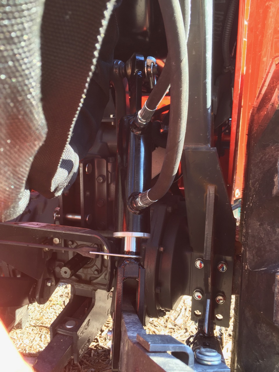

Here's a pic of my A&I side link -- I think it looks just like yours:
The OEM Kubota hydraulic side link has an angled clevis on the bottom (just like the original turnbuckle side link) which these generic side links do not. That's just one giveaway. Lack of Kubota gray paint is another.
The other thing I don't like about your setup is the total redneck-rig of fittings they set you up with. The cylinders have ORB fittings, so when I ordered hoses, I had ORB fittings crimped onto the hose ends. Much cleaner install that way and fits better and more compactly. Why they would give you JIC fittings on the hoses and then elbow adapters is beyond me -- that's not custom either -- that's an off-the-shelf hack. Fine in terms of function, but not something I'd expect from an OEM kit.
I think the dealer just put together the most convenient generic "kit" from standard parts they could get their hands on. You could do that for a lot less money if that's what you really wanted, but it sounds like you were expecting something much better and you probably paid for something better. I'd ask for my money back and tell the dealer they need to be more professional.

So I chatted with the service guy on the phone on my way home. He said they had an extra cylinder & swapped it out & mentioned check valves as a possible fix for the sidelink leak down. Not an option as I explicitly got the float spools just for TnT as I loved on my L3200's toplink. Will worry about that next after things stop leaking externally. I assume they ordered a few when they ordered mine as I heard them mention that a while back & why else would I have not gotten it sooner if they had it on hand. Fired it up, ran it in & out a few times...
Sidelink fitting was still seeping a hair too. I unpluged the sidelink QDs & will check it in the morning. Will check to see if the bottom clevis is tweaked like the stock fixed ones are. I thought it was. The dealer says they will take care of me & so far they have. The lack of QA is kind of by whoever the manufacturer is, as well as the dealer is depressing though. Wouldn't suprise me one bit if those cylinders weren't OEM Kubota. I think FitRite will come up heavily in my conversation with them tomorrow. If that flies, it won't be a speedy fix, but at least I know they will be done right by somebody with pride in their work.

No significant leak down on the side link overnight despite it still dripping a bit... indicates a bad valve.

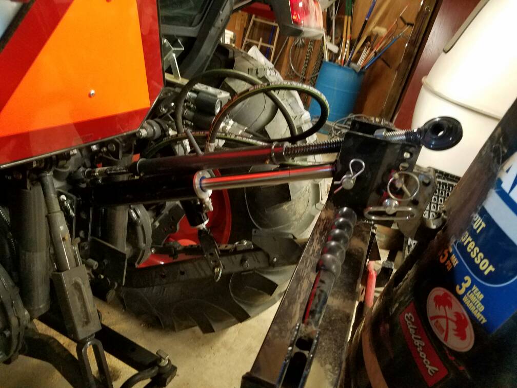

Unscrewed my manual toplink & set it on the hydraulic one. Looks like I'm missing 4" at least.
Clevis on the side link is straight, so probably not OEM as others have noted.
Dealer was asking how much my impliment weighed, presumably thinking I was overtaxing it. 60 gallons = 8 cubic feet & dirt is 70-100lbs per cf. Add a hundred lbs for the tank & you don't even make 1000lbs. 3pt is rated to 2750lbs @24" & the back of my ballast tank isn't even that far back.

Dealer has some new bigger & longer cylinders on order from somewhere else. Not going to address the leak down issue that is probably something with the valve until the cylinders oozing fluid externally is sorted. But they agree it's probably a probably a valve.
