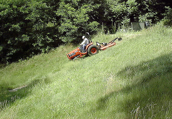

Roy,I drive and cut both up and down the slopes, just not sideways. Attached is a photo of some of the steeper parts.

Take my hat off to you Von,for I wouldn't drive up that slope mowing w/turf tires..I would mowe the bottom first than back up the bank plus have the rear tires chain up.

That doesn't look too bad. Seems to flatten out at the left of the picture. The slope you're on is similar to what I have, except I've a tree line where it starts to flatten.
I'm assuming you're in your lowest gear using engine braking.
Now, tractor fans...which has better engine braking: gear or HST? Which is less likely to run away or be driven down slope by the weight of the tractor or implement. I'd like answers from both the non-occupational owners (the majority of us on TBN) and those making their living on tractors.

Roy, I use the middle gear, as low is just too slow. With the hydro I can take my foot off the petal and the tractor will stop even on the steepest of slopes.Thomas, I don't know why turfs get such a bad rap. I have never had a problem with traction with them in any situation. From mowing to heavy loader work in soupy mud. I had ags at one time on my old Kubota and changed them for turfs. Only differance was less sod damage when mowing the grass. On ice the turfs are way better, and the overall ride is much smoother. For my uses turfs are the way to go, and with the loaded rears that I have now. I never seem to get stuck or have traction problems. Just yeaterday I had to stand up some large pines that were leaning over from the wind storm. I used a strap to the drawbar and on two of the larger ones had the relief valve pop before I lost traction. These trees were about 25' tall and the little B2710 pulled them up straight. I just hope that the roots take before another big wind comes. I staked them and tied them off, but there are afew that are real tall. Only time will tell!

I’ve looked all through my manual and don’t see where it specifically states a maximum safe tilt angle. I have one hill that’s 15 degrees and I drive sideways on it all the time and it doesn’t seem too bad. I don’t go very fast and certainly don’t turn up hill while I’m on this hill (that would create an unstable situation). I have a couple of other hills that are much steeper that I’ve driven up and down on, but never sideways. I measured them and they are 30 degrees, but it feels like more when I’m driving on them!

My take on going up vs down on steep hills is that if you have a mower attached, it probably doesn’t matter as far as flipping over frontward or backward, because the mower will keep you from flipping over either way (unless you drive down an 85 degree bank!). But, going down can be dangerous because the weight of the mower will tend to push the tractor sideways if you don’t stay pointing exactly straight down. I had that happen to me. The weight of the mower pushed the tractor faster than I wanted to go and I lost control and was starting to go sideways by the time I got to the bottom of the hill. Fortunately, the hill was short, if it would have been a long hill I would probably have rolled it. One mistake I made was not having it in 4WD, thinking I didn’t need it going down hill. The thing I forgot was that, unlike my Jeep, the brakes only apply to the rear wheels, so I had less stopping traction, and that’s how I got going too fast to start with. The rear wheels started to skid on the slippery grass when I let up on the hydrostat pedal and hitting the brakes only made it worse. Now I always use 4WD when on hills, going either up or down. As for going up, that seems less dangerous except of you loose traction (or power), then you’ll have to back down, which won’t be fun. I’ve had the front wheels come off the ground going up hill with a mower attached. I didn’t worry about flipping over because the mower prevented it. I was able to keep going though. I’ve gone up the hill without an implement attached and the front wheels did not come up, probably because the weight of the implement was not there. But, it’s more spooky because I know there’s nothing behind me to keep me from going over if the front does start to come up. I think KYFARMER’s concern about backing up and then going down is that if you have a gear drive, when you stop to change gears, then you’re relying on just your brakes to keep you from rolling back down when you push the clutch in. I’ve had this problem with my Jeep (heading up hill) and it isn’t fun! If you can get over the crest of the hill before having to stop, then it’s much safer. So, I guess what I’m saying is that if you have a mower attached, it’s probably safer going up hill. If you don’t have an implement, going up hill can be dangerous. Either way, I wouldn’t go near a 30 degree hill without 4WD.

In the John Deere information for the 4000 series compact tractors it states that it meets ANSI B71.4 Slope Requirements. Nobody at JD would tell me what that requirement was so i bought the ANSI B71.4 Safety Specifications for Commercial Turf Care Equipment ($70.00). It contains the specifications, test conditions and procedure for conducting the tests. It generally states for longitudinal test acceptance is 30 degrees (58 % slope) with either end positioned downhill. Lateral tests acceptance is 20 degrees (36.4 % slope) with either side positioned downhill. It further states that how the tractor is equipped and ballasted will effect these figures. I mow on a 20 to 30 degree slope with a JD 4400 hydrostat 4 wheel drive, 72" mmm, with turf tires. I mow up and down, can back up or back down any parts of the hill without any problems. At first it was interesting but after years of mowing it is now second nature. With the hydro I can stop, change direction, either going up or down the hill without any tire slippage or loss of control.
