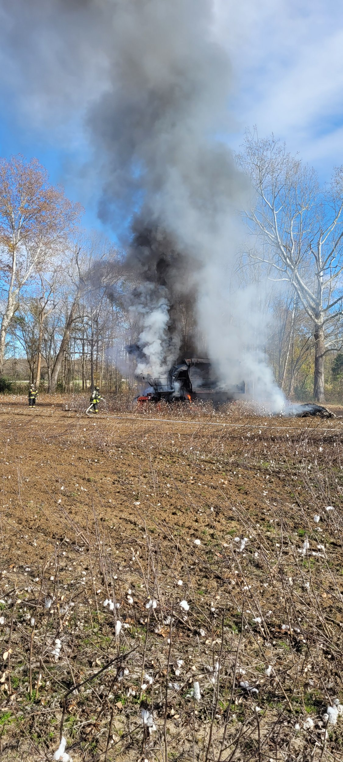

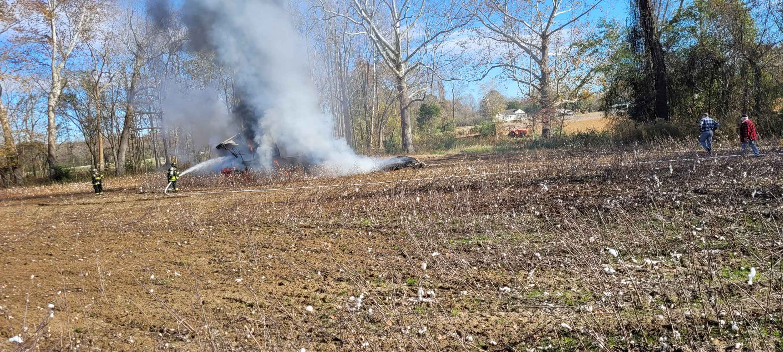

Machine was running and he was under the head cleaning it with out blocking it up. A hydraulic line or fitting gave out dropping the head and he barely rolled out before it pinned him! Hydraulic fluid sprayed on hot exhaust then ignited is the best hypothesis of how blaze started.I usually put safety 3rd, behind progress and laziness. Seems this guy did too. I like to think that I have a net overall gain in progress vs setbacks. I hope this guy does too.
I'm pretty free and loose with safety, but I won't go under anything suspended by hydraulics. I've had hoses go and it's scary even from the drivers seat.Machine was running and he was under the head cleaning it with out blocking it up. A hydraulic line or fitting gave out dropping the head and he barely rolled out before it pinned him! Hydraulic fluid sprayed on hot exhaust then ignited is the best hypothesis of how blaze started.

Is this common? To work on a running machine is a "better not do that" flag to me.Machine was running
I'll ask him about the machine running. I mentioned not blocking the head to go under he his reply was, "I have to do this 10 or 15 times a day, don't have time for that"Is this common? To work on a running machine is a "better not do that" flag to me.
Was the machine running or just the engine on? I sure hope he was not trying to clean with it running although I have seen people do that as well.Machine was running and he was under the head cleaning it with out blocking it up. A hydraulic line or fitting gave out dropping the head and he barely rolled out before it pinned him! Hydraulic fluid sprayed on hot exhaust then ignited is the best hypothesis of how blaze started.

Hard to second guess the man doing the work.I'll ask him about the machine running. I mentioned not blocking the head to go under he his reply was, "I have to do this 10 or 15 times a day, don't have time for that"
My thoughts exactly.Wow ! He came real close to not having time for anything !

Engine running not head running.Was the machine running or just the engine on? I sure hope he was not trying to clean with it running although I have seen people do that as well.
I have to agree that it is very easy to begin to trust the hydraulics after thousands of times of them doing exactly what they are supposed to. But that is when they are going to give out - after the thousands of times. A simple cylinder block is well worth it.
I was just asking questions. He should be second guessing himself after this. I know of a couple people hurt while working on these machines. One used plastic buckets to block it up which were crushed when he took the hoses loose.Hard to second guess the man doing the work.

I know what he means.I'll ask him about the machine running. I mentioned not blocking the head to go under he his reply was, "I have to do this 10 or 15 times a day, don't have time for that"
I used to work under and around my loader all the time, always believing that any hydraulic failure would bleed down slow enough for my young and nimble self to jump clear if something happened. Then one day while lifting a brush hog (Woods PTO "rotary mower") up to pressure wash the underside and look for a leak, I had a hydraulic hose failure on my loader.I'm pretty free and loose with safety, but I won't go under anything suspended by hydraulics. I've had hoses go and it's scary even from the drivers seat.
Bet he just found time for that now...I'll ask him about the machine running. I mentioned not blocking the head to go under he his reply was, "I have to do this 10 or 15 times a day, don't have time for that"
I was lifting a full load of dirt out of the dirt pile when a line burst, covering everything, including me, with quite hot hydraulic oil, and the bucket fell like a rock. The hose failure wasn't a pin hole, it was more like what you see a water balloon look like after it's popped. Never saw it coming, no warning, just running, running, POP!I used to work under and around my loader all the time, always believing that any hydraulic failure would bleed down slow enough for my young and nimble self to jump clear if something happened. Then one day while lifting a brush hog (Woods PTO "rotary mower") up to pressure wash the underside and look for a leak, I had a hydraulic hose failure on my loader.
Hydraulic fluid shot 30-40 feet into the air, covering everything in a 50 foot radius, but more importantly, the loader with mower crashed down like a brick dropped from a building. There was nearly ZERO resistance due the expected hydraulic bleed-down, it literally fell with gravity. Woke me up to the possibility of what could really go wrong, and I haven't put any part of myself under anything supported with hydraulics, in the several years since.
Interesting. I'm probably more likely to get caught out by something i don't do on a regular basis. If it's something i deal with routinely, I'm more likely to figure out a way to do it more safely, and hopefully just as quick.I know what he means.
People like to virtue signal about doing something safely until that have to do it 10x/day.
