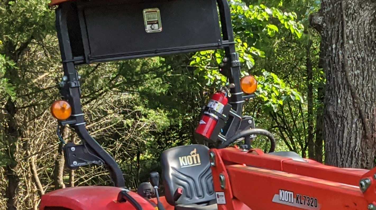

Running out of space to mount things, I had to go onto a section of 45 degree ROPS. I used some plastic lumber 2x4 as spacers to offset the mount, to achieve the necessary clearance.
I too am a proponent of inverting the extinguisher and bopping it on something hard, from time to time (a couple of times a year).
