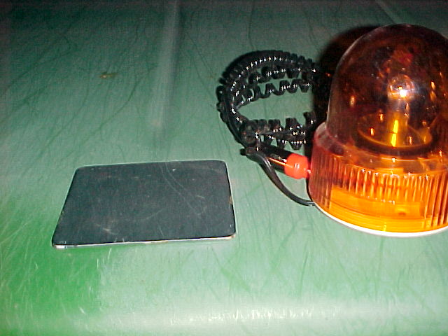

My situation exactly, except I like the magnetic base...and found a way to use it on my fiberglass BuckTop.
After painting a 6"x6" square of thin metal, I used double sticky foam tape (like they used to use to attach cell phone antennas to windshields) to attach the plate to the BuckTop. The plate is not visible in regular use (unless you're 7' tall) and works great. The tape is available anywhere. The light sits in the garage until I need it. You can tell by the scratch marks on top of my canopy that I need a light that can sit in the garage until needed. A permanent installation is out of the question.
The light I use is a rotating beacon type, with lighter plug-in. It was purchased at AutoZone for around $30, as I recall. The metal base plate, taped to the BuckTop, with the beacon sitting next to it, is shown in the attached pic.

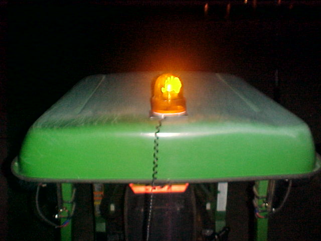

This pic is taken from the backside of the tractor and shows the beacon in place and fired up. Good luck!
