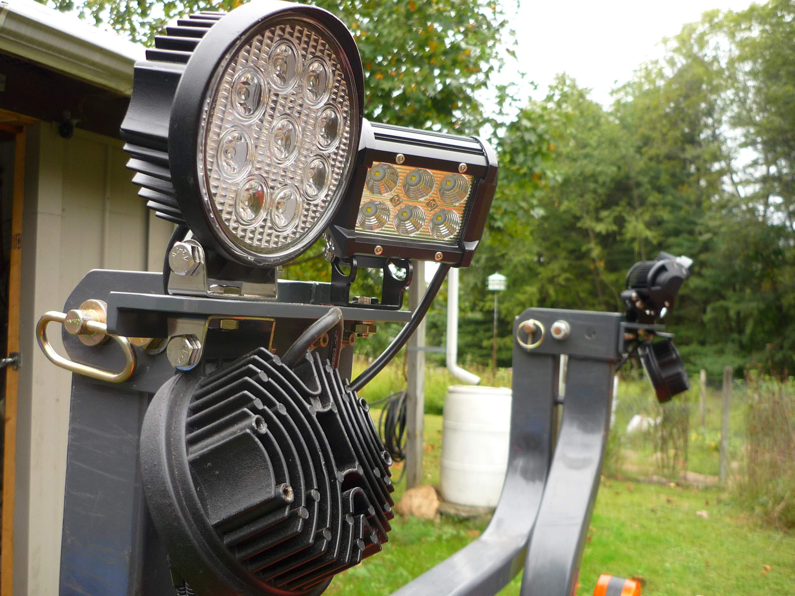

Wanting to do a similar install on my New Holland TC18. If I did 4 of the lights like you have what type of wiring kit would be best? I have not found any wiring harness on amazon that will work with 4 lights
   / Magnet Mounted LED ROPS Lights - PICS
#22
Hi brenth561. I didn't use a wiring harness. I just spliced single strands of wire to lengthen the wires coming out of the lights. Probably needed 12 feet or so total for all four lights.
Having now used the lights to plow snow a few times I definitely like the setup. Good coverage, trim profile, and magnet mounts. I'd do it again.
Good luck. Jeff

They really do look great. Did you use a relay? Have you had any problems with the lights yet? I have read countless reviews and it seems that others have problems with them collecting moisture and eventually stop working. I don't plan to use the tractor when it's raining so the lights should never get wet unless they are sprayed on accident when washing or I get caught in the rain.
Also how it your light output with those lights? I can't decide whether to do 4 of yours or a 20 light bar for the front and two of yours facing the rear or use 2 of the square type for the rears or even the 28w rounds ones... So many options!!

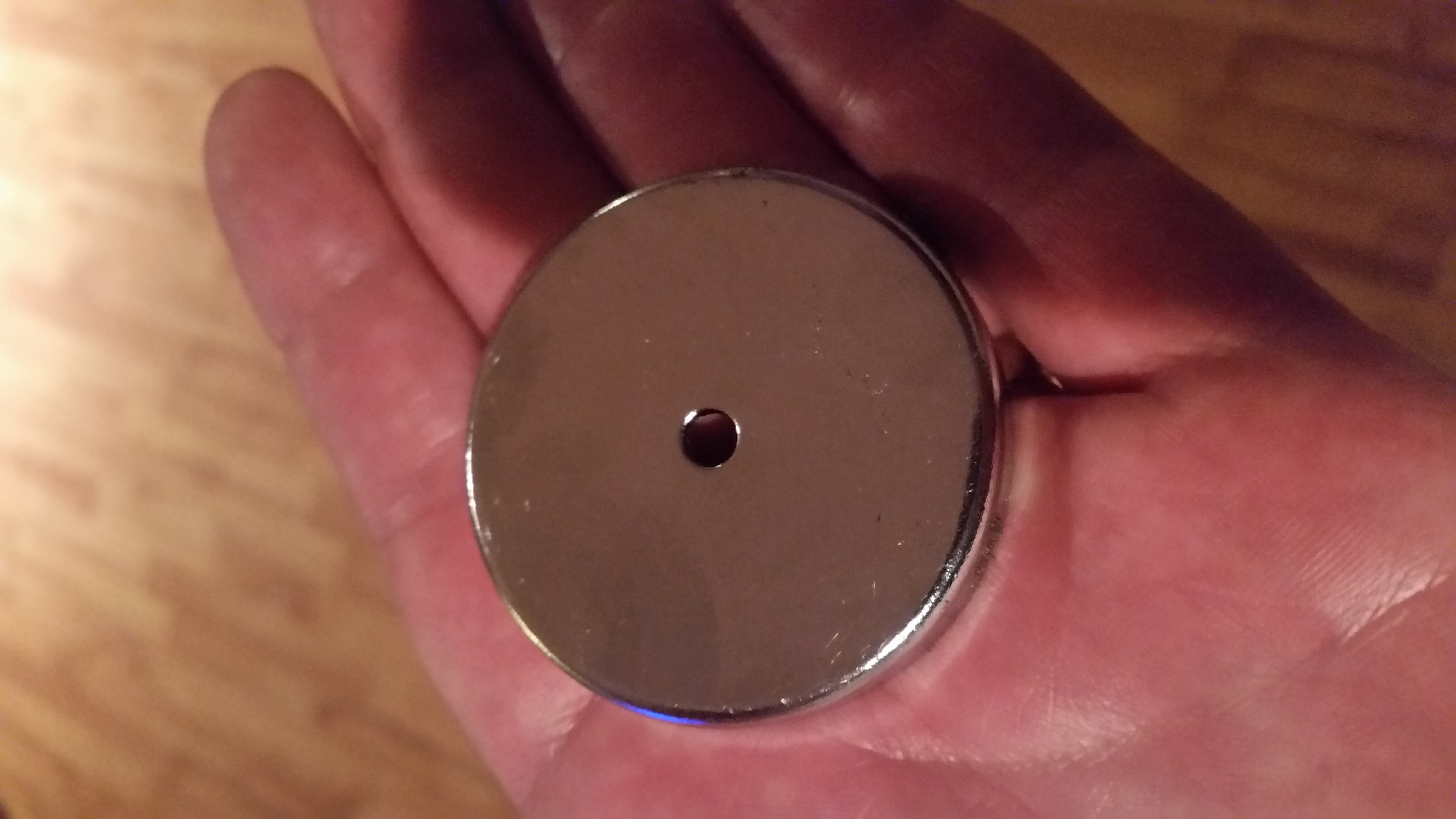

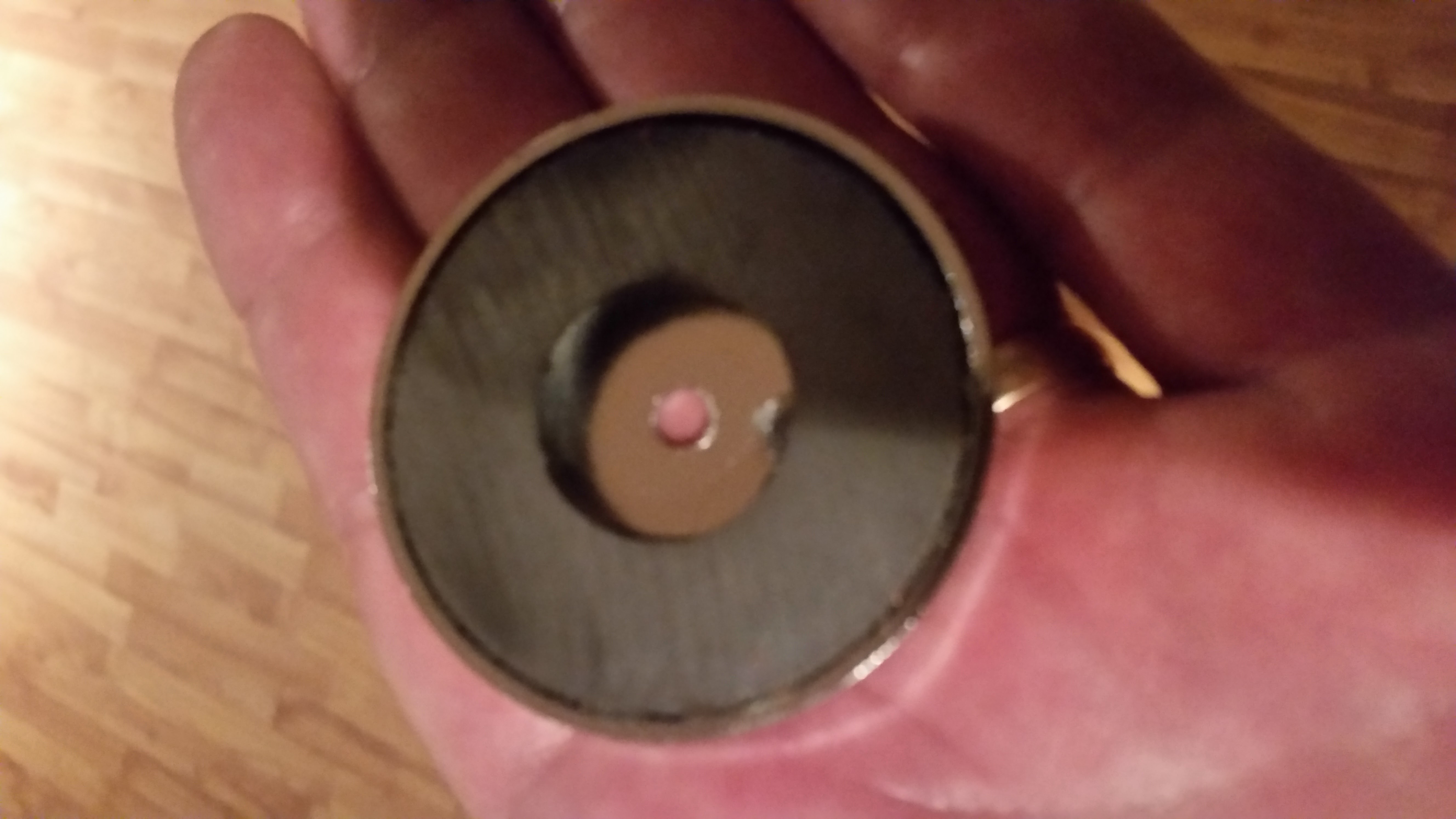

I did order the magnets today. Per your advice I went with the larger ones that are 2.64

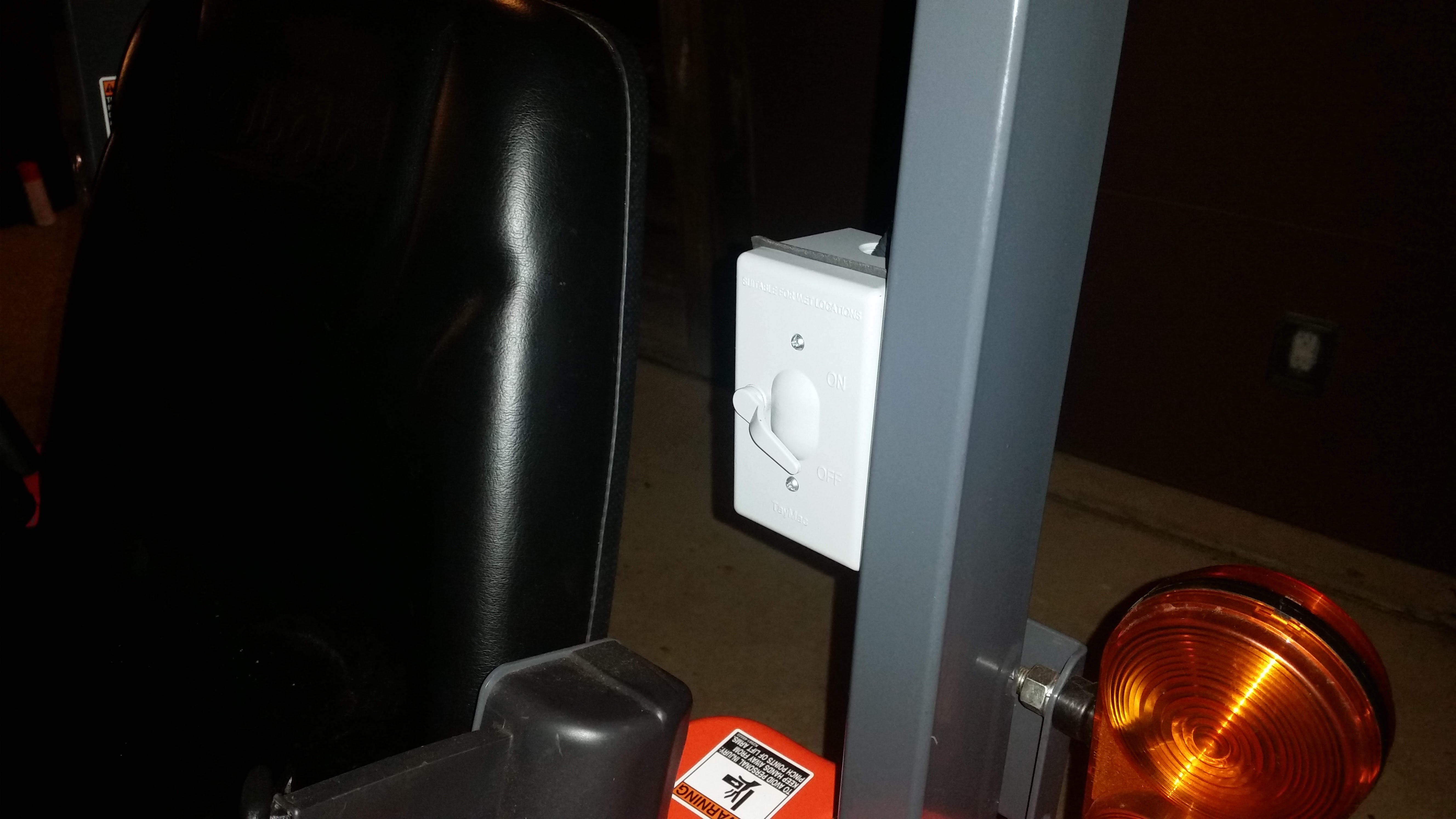

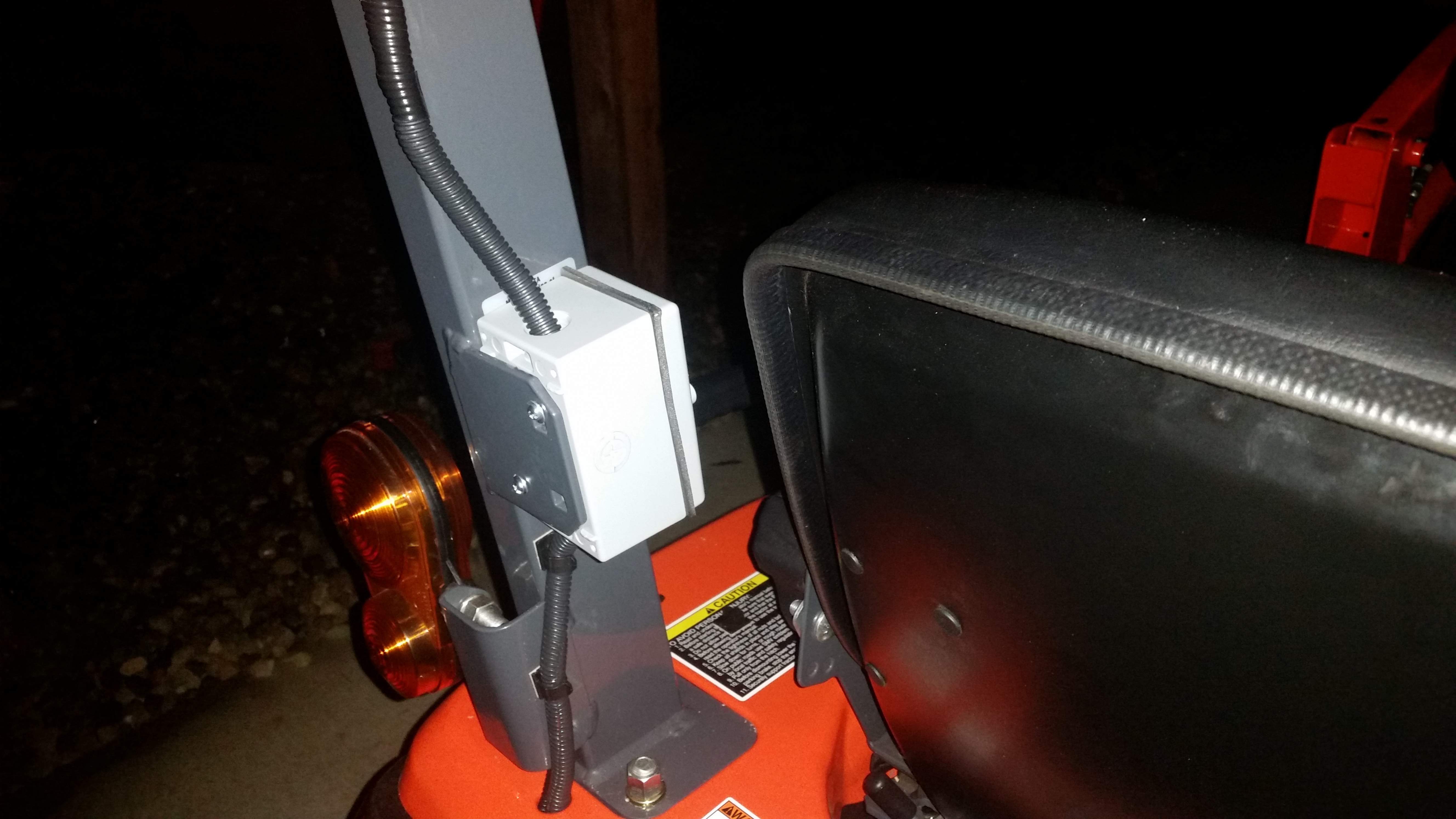

Other than it being a sin to drill a hole(s) in the ROPS, is there any reason not to thread the wires thru the tube?

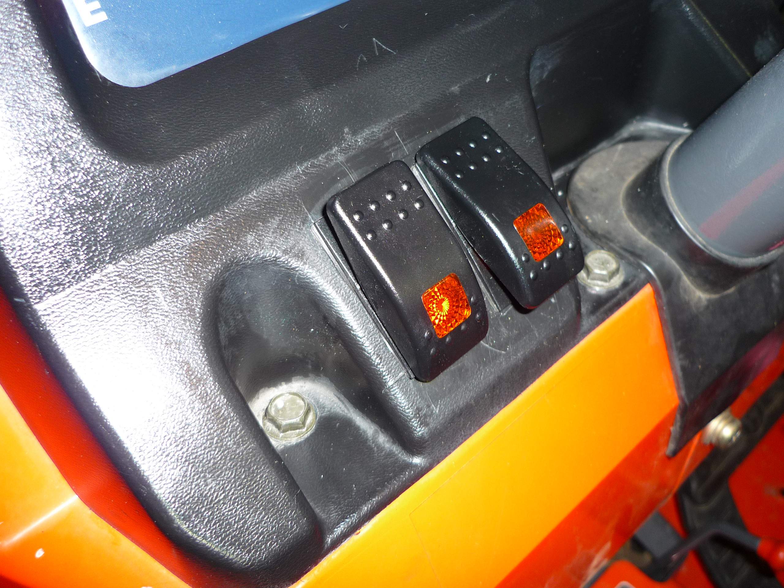

Varmint, looks good, but I have to deduct a point because your switches are upside down! ;) Or do you flip your head around when using them? :laughing:
Those Contura-style rocker switches are a mainstay in the boat world. Never made sense to me how they decided which way was on or off. I only know when comparing to other switches nearby. Sometimes in my boat when I have a bunch of gizmos running, I look at the switch panel and it's never immediately apparent which ones are on and which are off. Easier at night when the lights are visible.
   / Magnet Mounted LED ROPS Lights - PICS #28
Those are boat switches (I wanted waterproof, and they seem to be) and they are mounted that way on purpose- the indicator lights don't bother me, and for reasons un-definable, I just prefer to push down for "on". I wanted indicator lights so I wouldn't have to think about "are the rear lights on or off" during the daytime. I do use them to light up the barn when I back in.
But I guess you guys are right. I can flip them if I sell the tractor, and it becomes a sticking point! I don't need to check at night- I KNOW when the lights are on!

Brenth561,
I'm not certain you would notice a difference one way or the other between the two. I'd pick the one that fits the installation space the best. In either case they will put out more illumination then the typical 55 watt halogen fog lights and the light will be whiter.
I used the 1x6 configuration ones on my tractor because I tucked them up under the sun canopy. Originally had 55 watt halogens (H3 bulb), but they became damaged from limb damage.
On my neighbor's tractor I used the square 27 watt ones mounting them on ROP's. They were bright enough he elected to turn one rearward (1 forward and 1 rearward).
The square 27 watt ones referenced in my original post are brighter then the other two, but they are also physically larger.
For the most part the build quality seems to be about the same between these lights and they have come down in price over the last couple of years.

Just a heads up, from my experience, the 18w lights in the OP are not that water proof , here in the Canadian winter's, 2 of the 6 led's have burnt out within 6 months of use, they tend to fog up inside and then burn out. If you do have them, i suggest you re-seal around the clear lens, this may help reduce fogging up inside. I have 2 of these facing the rear, nice lighting for backing up, but as i sated one has already lost 2 of its leds.
   / Magnet Mounted LED ROPS Lights - PICS #35
I have heard the same thing about the cheap LEDs, but considering the price it may be worth a gamble. I put four of them on my RTV since I knew they would be subject to wear and tear and didn't want to invest more $$.
I think the problem is that they aren't perfectly sealed (some people seem to think it's around the cord) and they do not have a breather.
I have Rigid LEDs on my boat, and they all have a small Goretex breather on the back so that moisture can get out (but water can't get in). They cost about $200 each, so they better be darn good!

I've been wanting to make this identical improvement to my BX! I didn't know there was a factory-installed auxiliary power wires under the seat.
Nice install and thank you for sharing!

I made magnetic mounts with heavy duty magnets. The first time I hit a snow bank, they slid off the ROPS. Now, I have angle brackets on the lights that I clamp on with small C-clamps. They go nowhere. In summer when not needed, I unplug and unclamp them and store them away.

For moveable lights the magnets are an excellent solution! I really like the idea but wondering about magnetic interference... maybe no issue... not my expertise.
If a stronger and more permanent solution is desired I suggest you look into Click Bond adhesive bonded fasteners. These are serious structural fasteners used extensively by our military for a variety of applications far more intense then this. One thing that adhesive bonding does is isolate dissimilar metals thus no rust will occur. Full disclosure... I work for Click Bond but I only want to help fellow tractor owners with their mods. Our business is aerospace/military and I get no compensation for this type of promotion... not our market. That said, be glad to help with your mods on tractors installing systems without drilling or welding. I have posted a few threads on mods I have done on my BX using CB fasteners, LED lights, side view mirrors, and auxiliary storage boxes. I hope I haven't offended anyone by chiming in here.
