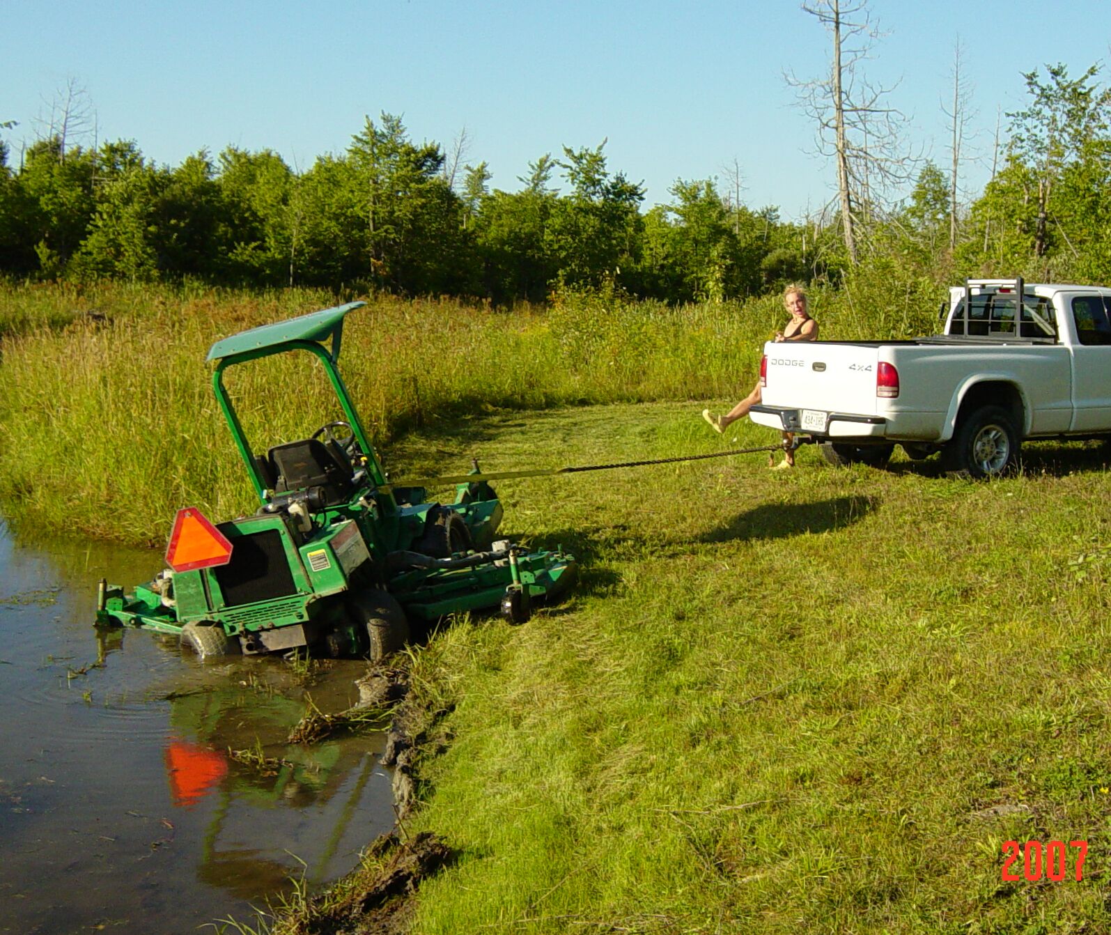

Many issues have occured when you box yourself in or don't give yourself enough room. Go up against a rock, building or tree and it's like you get sucked in and need additional equipment to get free without damaging anything.
Same with water and a slope. Go too close and you WILL get sucked in!
Are you saying if you mow around your pond long enough, your tractor is going to be in the water? :)

It would seem so.
