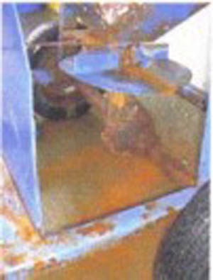

Could you use one of these, seams easy enough to build and you can load it with your FEL and then pull it down the road with your pickup.

this is a close-up of the spreader it is made from an old differential inverted, when pulled it throws sand or salt across the roadway.
Maybe someone else can enlarge these photo's so you can see them a little clearer, I had trouble trying to get them small enough to be accepted now you can't see them /forums/images/graemlins/confused.gif /forums/images/graemlins/confused.gif
