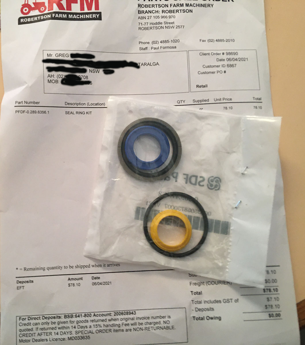

Will do Chris.
I've ordered the seal kit, expect to receive it next week.
SAME part number 0.289.6356.1
Cost $AUD78.11, which I thought was a reasonable price.
   / SAME Argon 50 steering ram leak: Repair at home or not?
You don't get much for your $78!

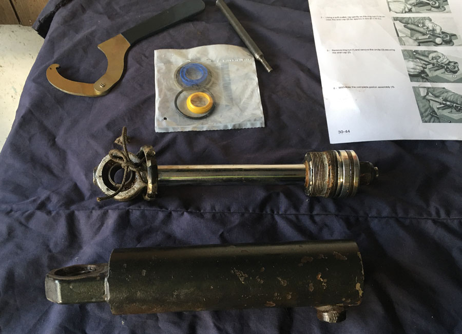

#9
I pulled the ram out of the tractor yesterday and spent this afternoon dis-assembling it and replacing seals and o-rings from the kit.

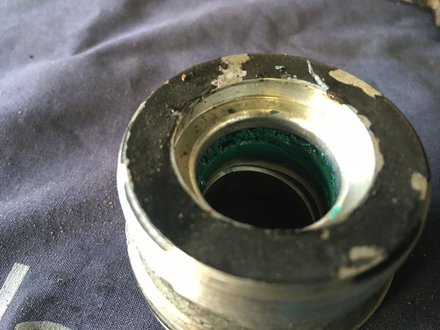

The centre seal was completely shot. No wonder it was leaking so badly!
