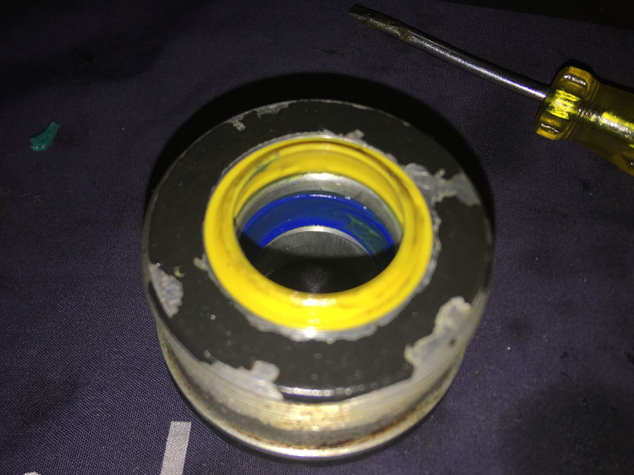

The new (blue) seal was an absolute bastard to get in. I ended up having to grease it to get it into position after much cursing!

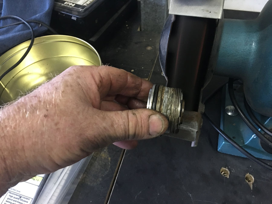

I cleaned up the corrosion on the end cap with the wire wheel on my bench grinder.
The mosquitoes drove me out of my workshop and into the house this evening.
Re-assembling tomorrow!
