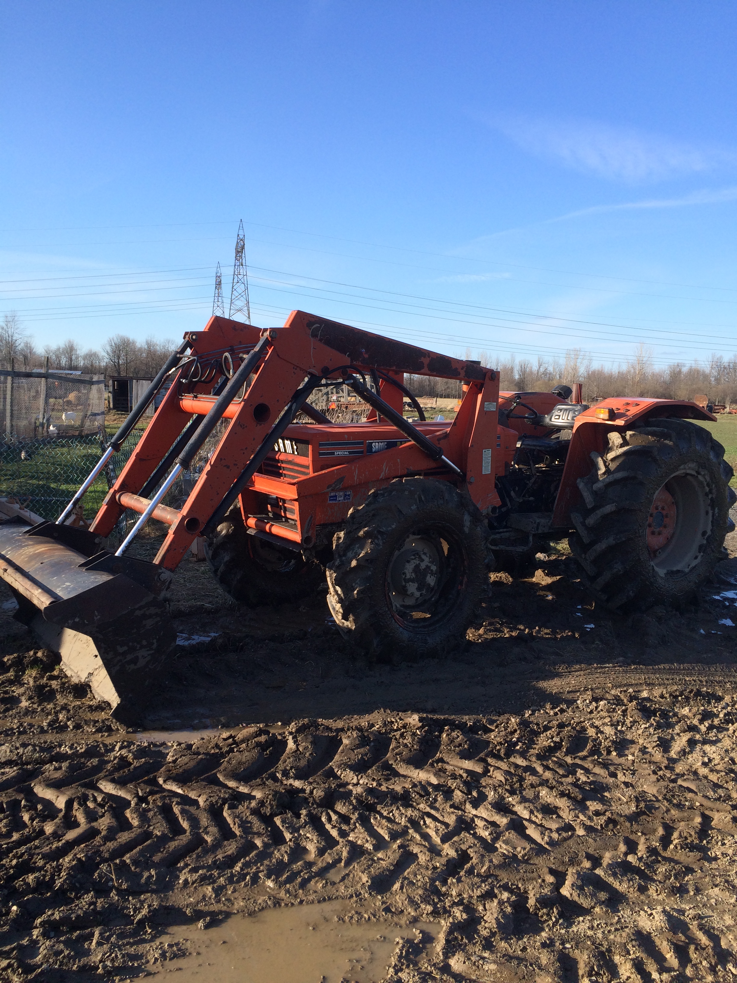

This is just after I bought the tractor(spring 2016). I haven't done too much to it yet. Just added a quick canopy for shade and redid the step.

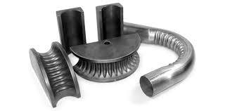

Be VERY carful having a muffler shop "bend up" a pipe for a tractor... ESPECIALLY on a bigger tractor like the OP's 75!
Tractors have "mandrel" bent exhaust, so they are full diameter through the bend, muffler shops don't... That means a BIG build up of heat behind every bend and the lack of free flowing exhaust and that means hotter exhaust temps!
It can and will cause over heating on heavy loaded machines.

Mandrel vs die? I'd hate to give a bum steer, but only experienced with Huth equipment in our shop, and 40 yrs ago. Don't think we had any of the 'ripple' dies. We did have several radii/dia in smooth and those were huge for 2 1/2" and larger tubes. It does all come down to ga, dia, and radius. :)
btw, rodders/racers who weld up exhaust headers or expansion chambers from 'kits' or plans might see something do-able there, but I've guessed 'near miss' a time or two. :laughing:

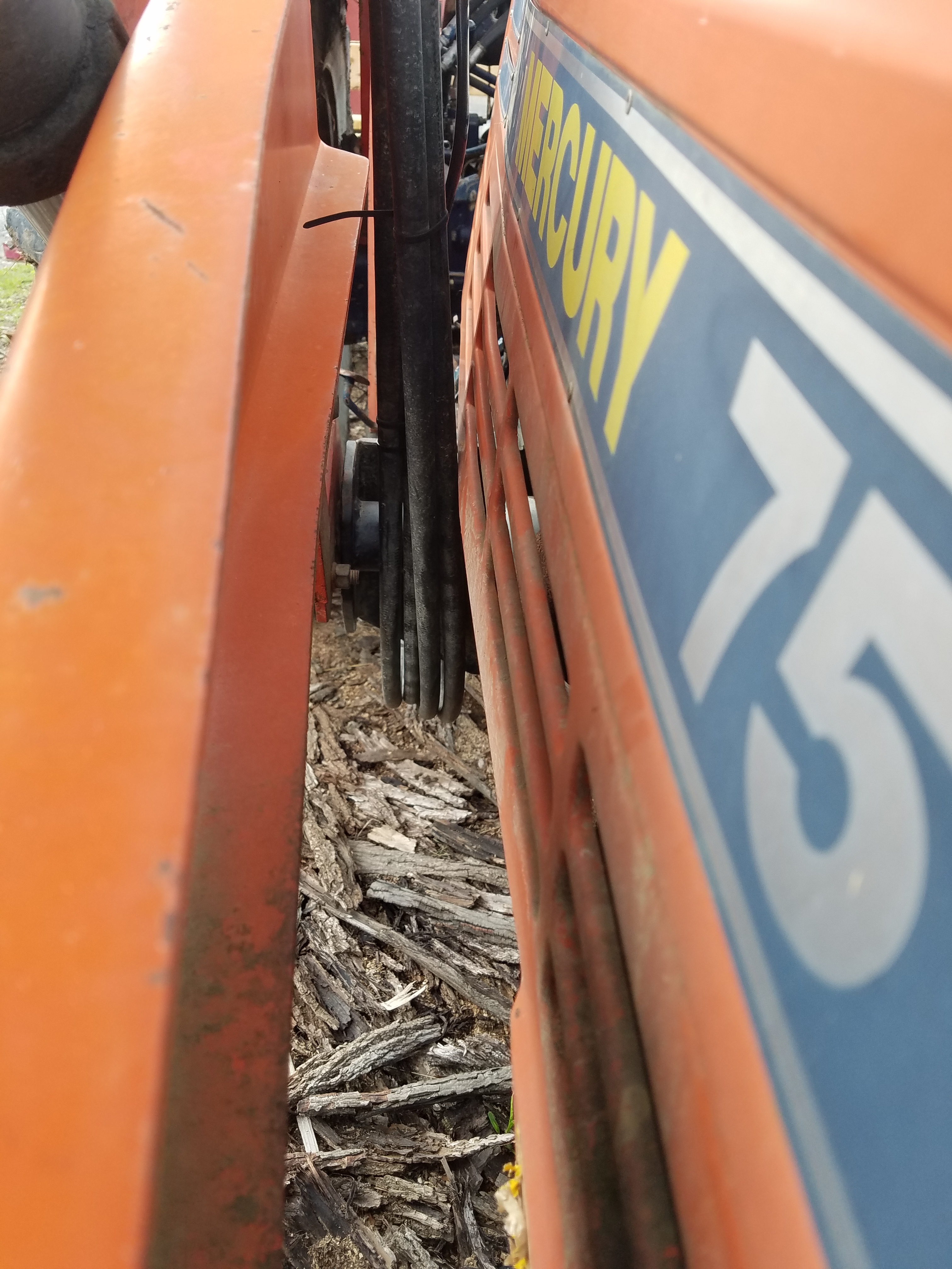

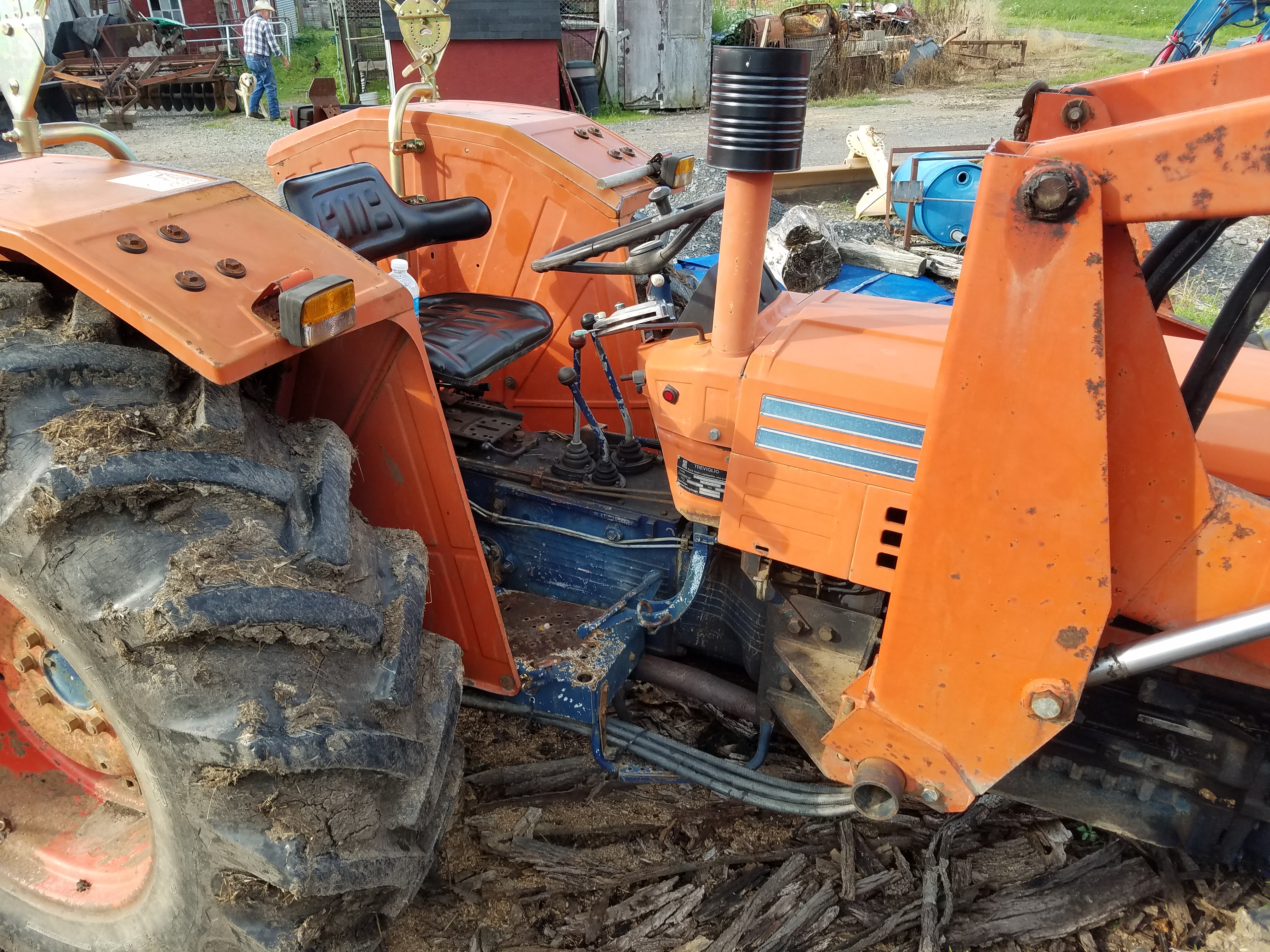

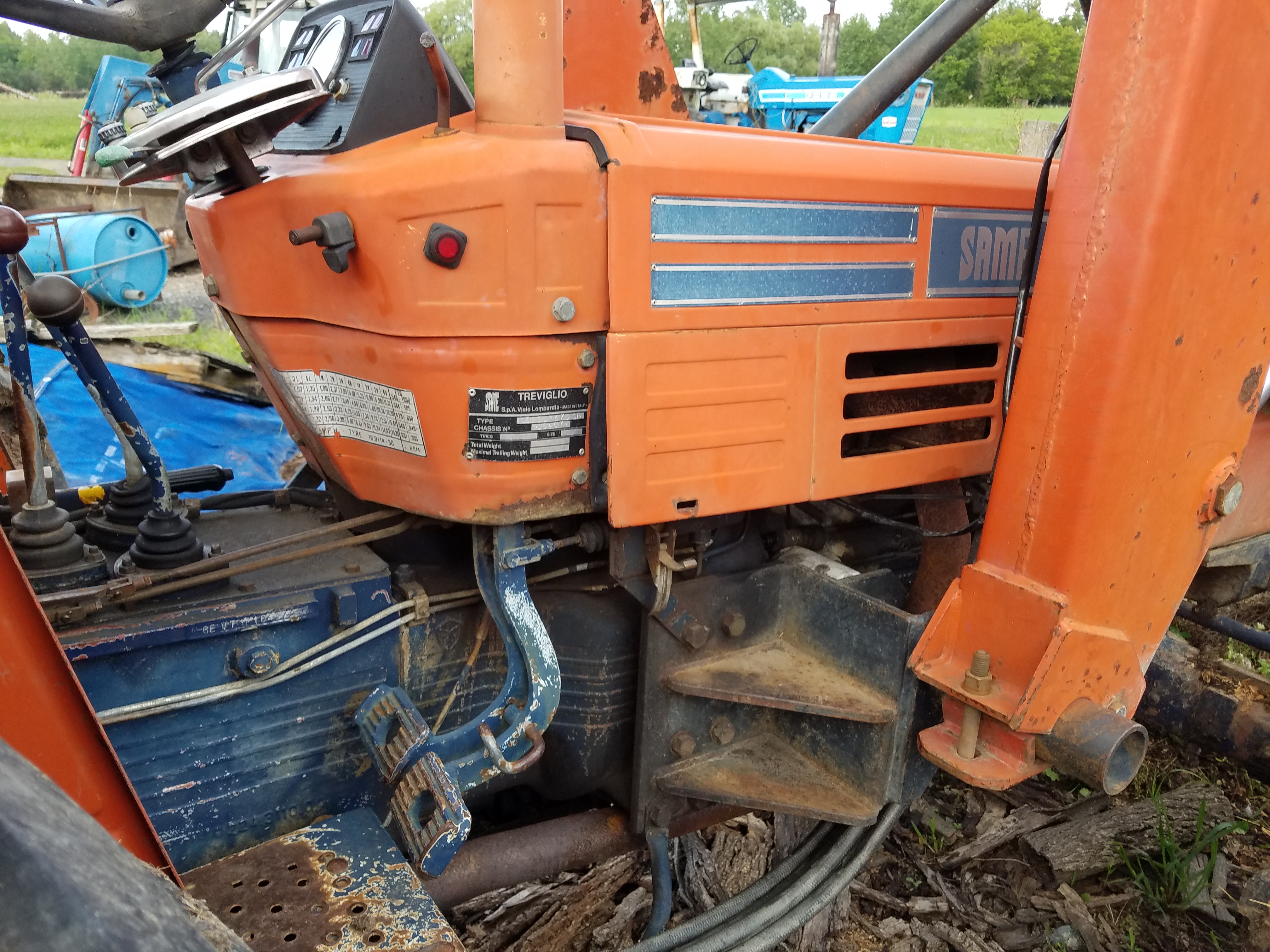

So I took some photos last night to give a better clue as to what I am working with. I think I may just do a straight pipe back and tie it up until I figure out how I want to work an upright into it.
This is the space I would have to work with if I wanted to put an upright
A better look at the pipe coming from the manifold going under.
Another possible option to bend the pipe around and come up behind the loader brackets.
Just another view of the side
Full view of opposite side and most recent pic of the tractor. The canopy didn't take long to fade and the black rings on the loader arm are for my chainsaw.
Underneath where the exhaust pipe ends which is right below where my feet go.
The backside where the old muffler came out from and the loop the end rested in.
The broken muffler.
