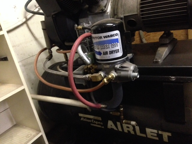

Don, that's funny, you used Harbor Freight and luck in the same sentence. All joking aside, I still get some moisture coming through my air line.
   / sand blast questions #22
We run two moisture/water separators filters on our blasting system. They are design for use on semi trucks and do a fairly good job. They have replaceable spin on filters, but we take them off (turn them upside down) and allow them drain overnight.
   / sand blast questions #23
Dry air is important. Pic of truck type water separator mounted at compressor.
Terry

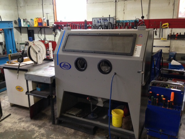

I use a U.S. made Skat Blast cabinet from TP Tools. It will accommodate a 15" wheel. Anything bigger I send it out to be blasted. Terry
   / sand blast questions #25
That's a really nice cabinet. We have two, but 90% of what we blast is to big for a cabinet. We looked into buying/building a blasting room, but decided it's not for us.
   / sand blast questions #26
Same here. Building a room would be nice, but a little too much of a 'luxury item'. :)
