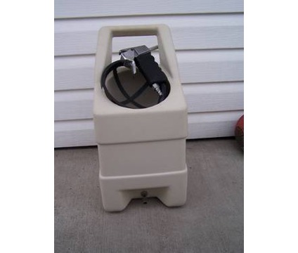

I have a small(er) plastic Craftsman suction feed blaster that I bought from Sears maybe 20 years ago .... it holds maybe 30 or 40 lbs of media .... works great .... no problems clogging ....
Only issue - like with any blaster - is having enough air to keep up with it.

It sounds like maybe the suction style is the way to go.
Maybe .... :D
This is a picture I found on the 'net of what mine looks like, although the gun on mine is a little different:
My 5HP compressor (true 5 HP motor) is 18 1/2 CFM at 90 PSI and I can tee in my other one, which I think is about 7 CFM at 90, for a total of about 25 CFM. That will have to do it and should be enough.
Biggest problem I ever had was a lack of air .... but I was using a small (30 gallon) single-stage Coleman 5 HP compressor.
Speaking of air, I'd strongly advise you to get a good fresh air system, including a hood - preferably one that has cheap (and easy to find) replacement lenses ....
At a very minimum, you'd need a decent respirator to keep from eating and breathing the dust ....
