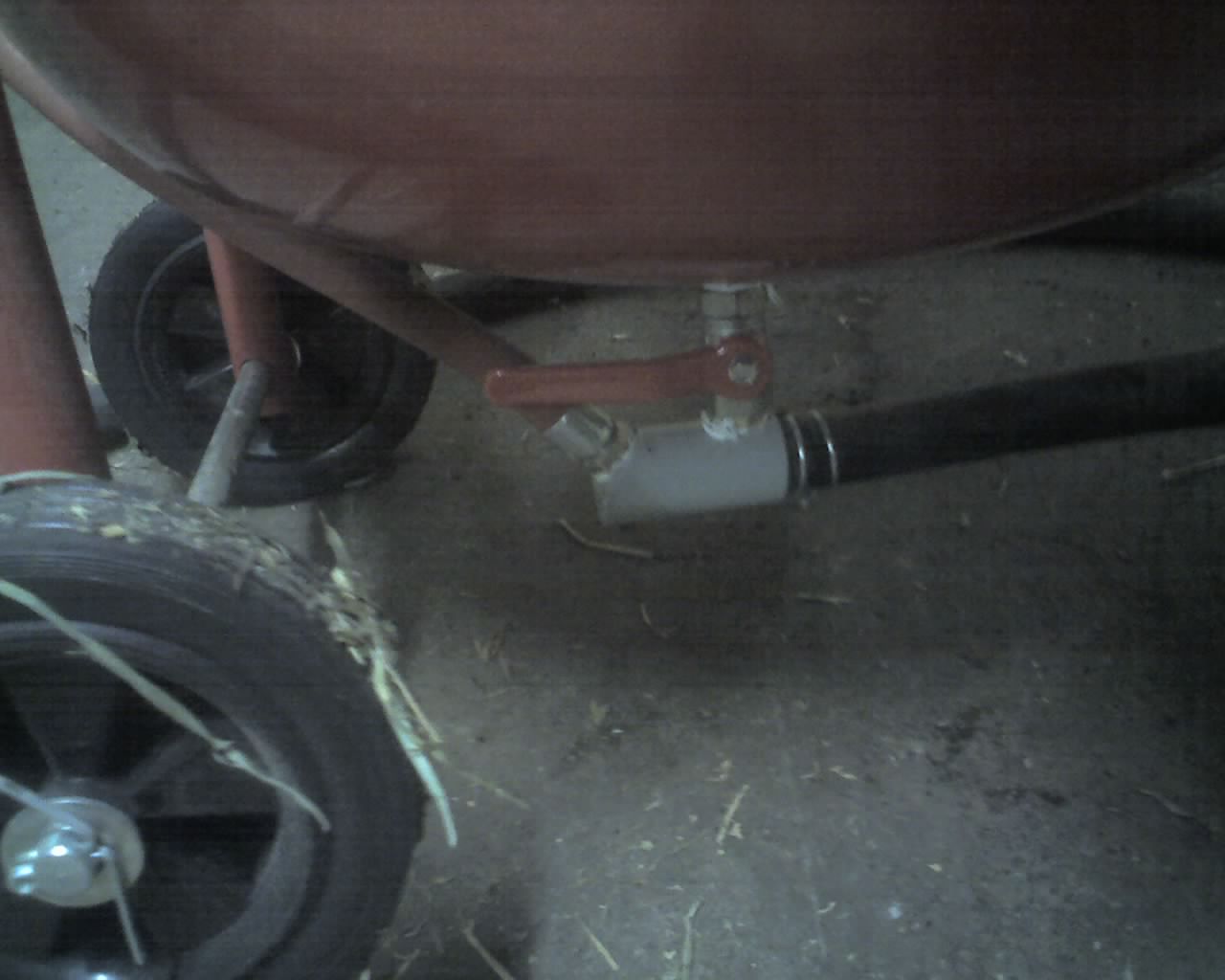

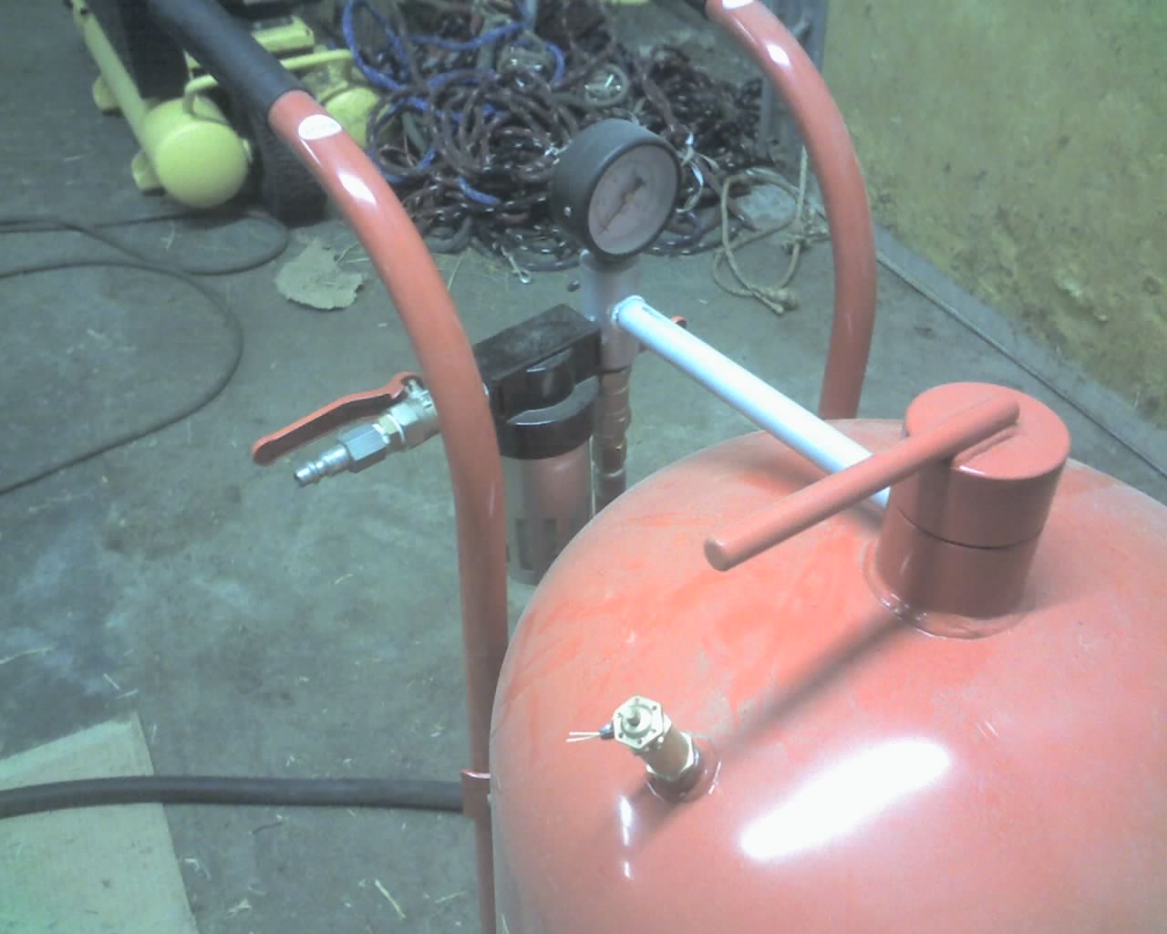

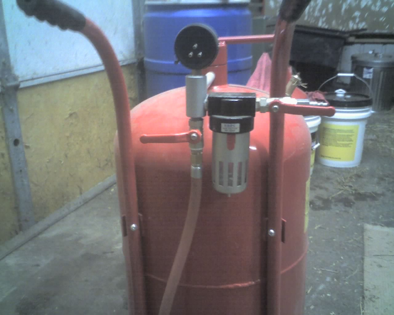

I have an inexpensive HF blaster which I have only used a few times, but I will try to tell you what I can about it.
My air enters a regulator followed by a water seperator/trap. It then goes through a valve followed by a "T". from the "T", one line goes to another valve and then to the top of the sand tank. The other side of the "T" goes to a "T" at the bottom of the sand tank. There is a valve between the bottom of the sand tank and the lower "T" for turning the sand on and off. From there, it goes to the nozzel for spraying. The hose from the "T" to the nozzel is a very heavy reinforced rubber to handle the abraision of the sand.
Don't know if that helps, but it is how mine is plumbed. The only thing I can't remember for sure, is if the first valve is before or after the regulator and water seperator.

Cyril, that helps a lot. If I understand your description, there is full blasting pressure in the tank pushing sand down to the bottom "T". The actual mixing of sand and air takes place at that "T" and the mixture goes through the heavy hose at full blasting velocity and out the nozzle. Is that right?
   / Sandblaster details #12
Correct. I'll try to remember to get you some pix, but I'm going from 4am until about 6-7pm right now and can't promise to remember to do it while I'm at our farm feeding. We'll see what happens.
   / Sandblaster details #13
Memory seams to have been a little foggy on the details, but the basic idea was there.
