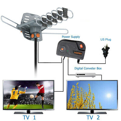

A few weeks ago, not wanting to toss a bunch of money at an antenna if there was no chance of getting a signal, I bought a $25 cheapie with the intent of using it as a test and then upgrading. To my surprise I get about 40 stations but about half of those only if I use the cable coming out of the gizmo marked TV1 and if I take the antenna directly into the TV or Tablo I get only a few:
TV1 I get about 40
TV2 I get about 20
No gizmo, direct I get about 5
Is this telling me that I need a powered preamp? I like a better quality equipment than the above so I was looking at Channel Master for a preamp and antenna:
4-bay HDTV/UHF Digital Outdoor TV Antenna-Channel Master CM 4221HD (CM4221HD)
Outdoor HDTV VHF/UHF Antenna Amplifier/Booster-Channel Master CM 7777HD (CM7777HD)
The feed direct to the TV would be manual, unplug from Tablo and plug into the coax connection on the TV, I would not feed both.

If that's what you are using, you will be AMAZED with a CM antenna and preamp. Rule for antennas, size does matter.
I installed one of those for my FIL down in FL. Works ok for him, but hes close enough to Orlando that everything is nearby. Out in the sticks you need something more substantial.

So dumb question.....With this arrangement:
Could I take 2 antennas pointing opposite directions and use a splitter "backwards" to bridge them into one?

That antenna was a $25 throw away now that I know I can get a signal I will install something better. Is there a way to fine tune the dB output without special equipment? Also, should the mast be grounded?
Yes sir! But drops from antennas to splitter have to be equal length. There are articles on the web about doing so.
