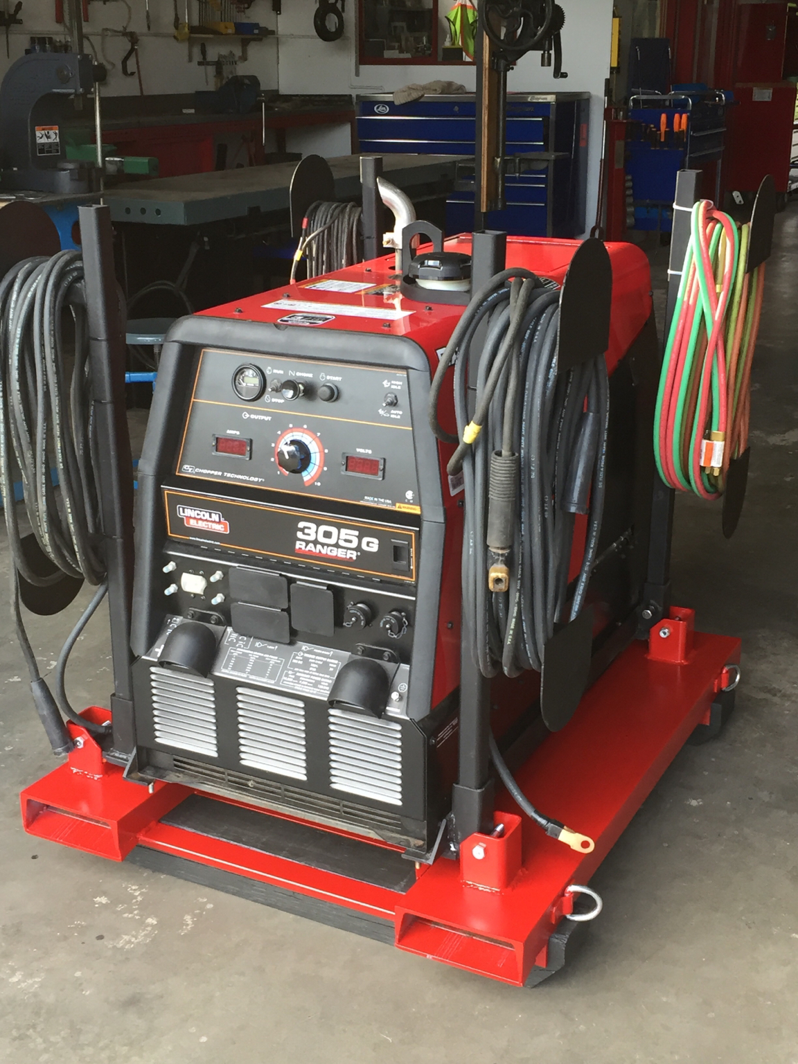

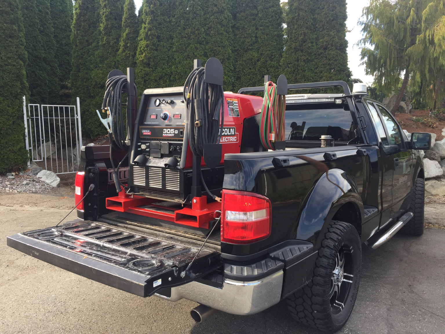

Congrats to you AND Santa for a wise choice. I have a 305G also that I use for back up power for my house. IMG_0599.JPG

I've got a much older model that has 36 hours on it. It ran at least 30 of them powering the house.

Big Barn,
Did you not put quick connects on your welder lead lugs? It looks like you still use the hex nut/lug setup and not quick connects.
   / Santa came early and left welder(s) #6

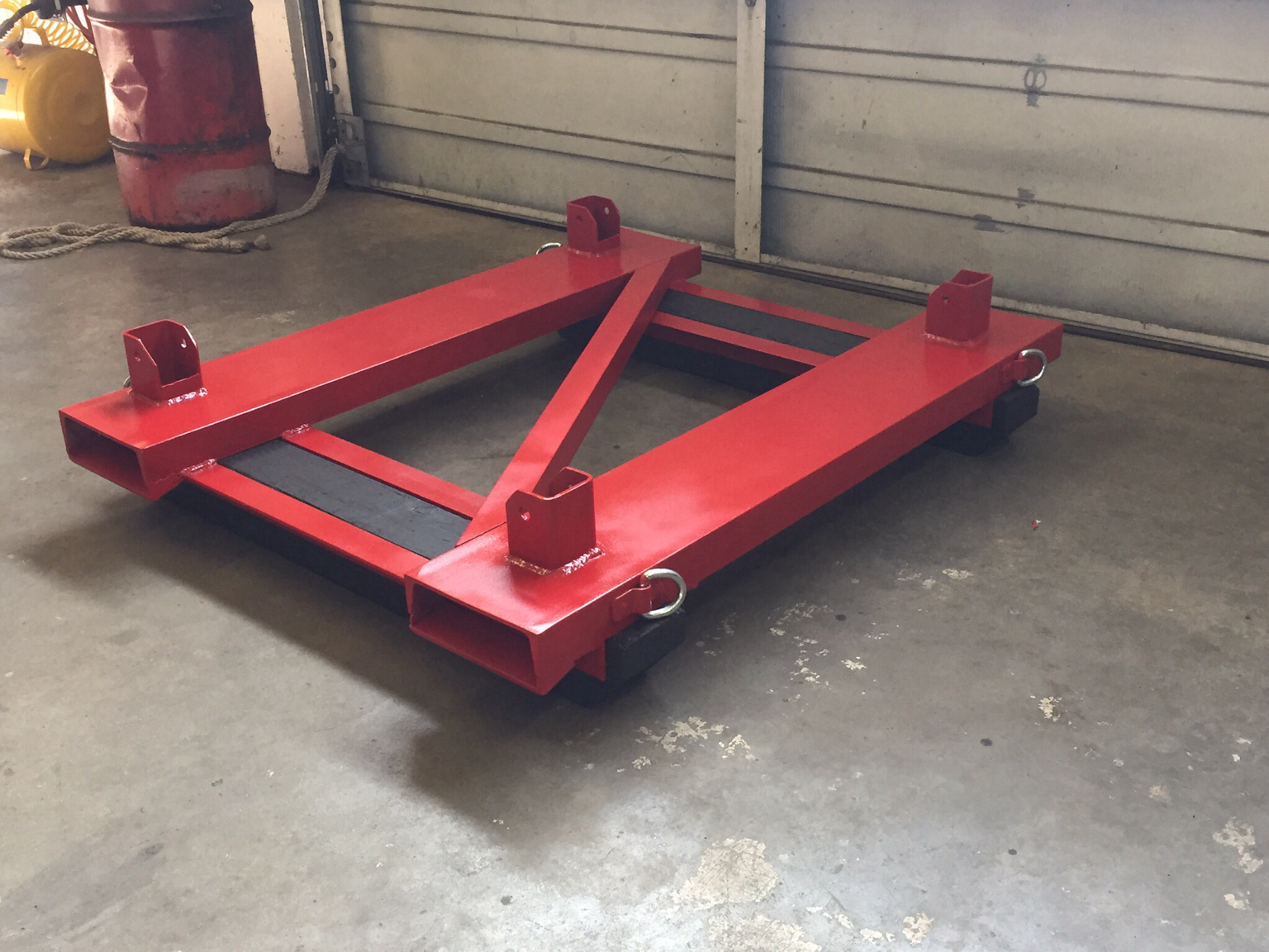

Thanks. Sorry no plans. Just made it with 8" channel fork pockets so that it could be fork lifted "end wise" into the back of my pickup.
The fork pockets sit at right angles on 4x4's so that it can be moved (cross wise) easily in my garage or shop with a pallet jack.
The "D"rings on each side of the skid are for tie down only. NOT lifting.
Terry
   / Santa came early and left welder(s) #7
Big Barn,
Haha. As a rule, yes. I bought this machine used (under 60 hours). The cables came with it. Haven't got around to purchasing Lug to female Tweco adapters.
Terry

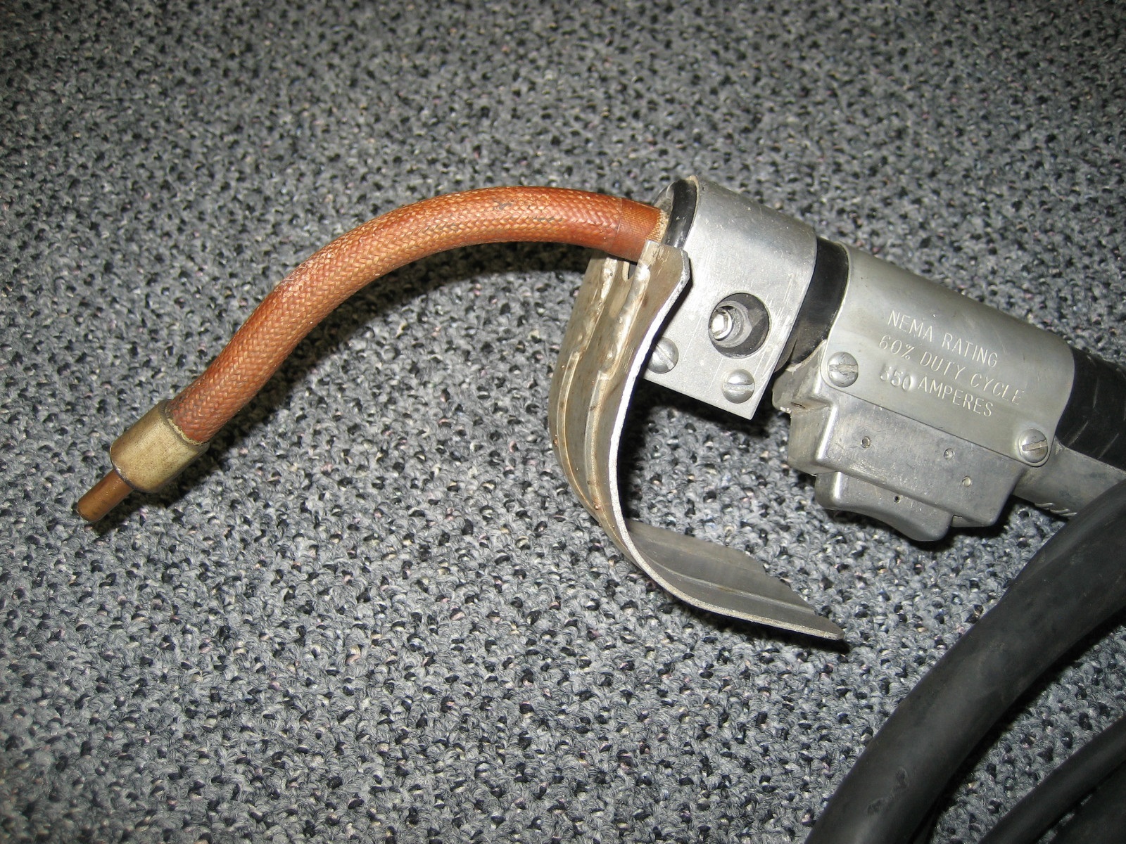

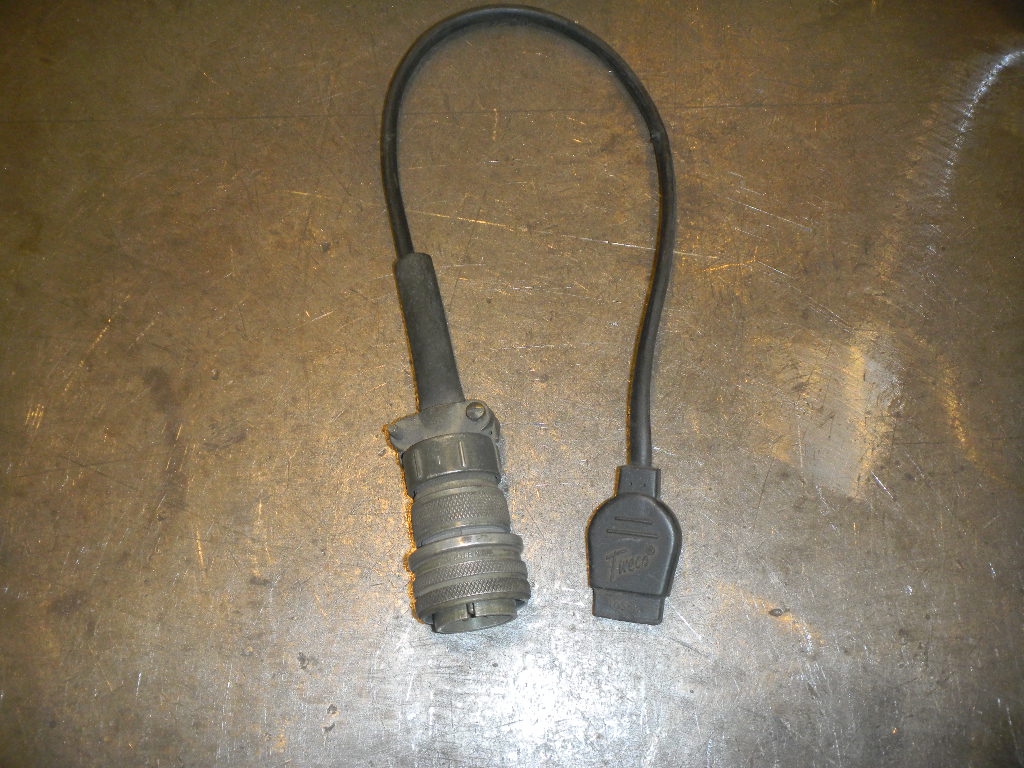

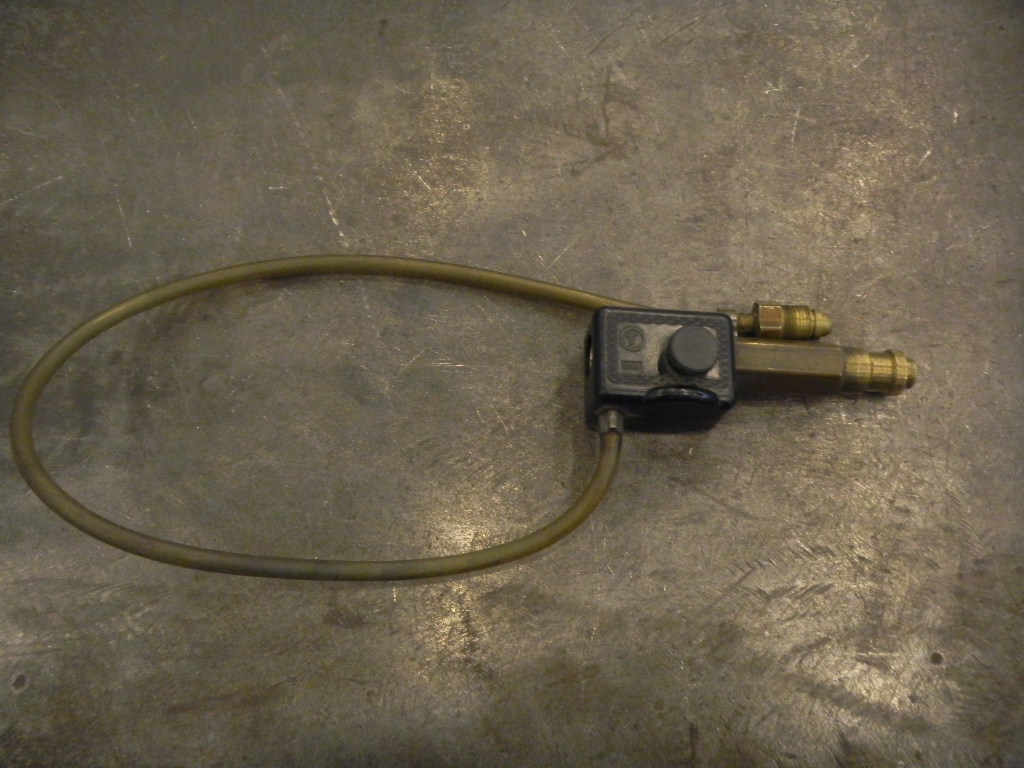

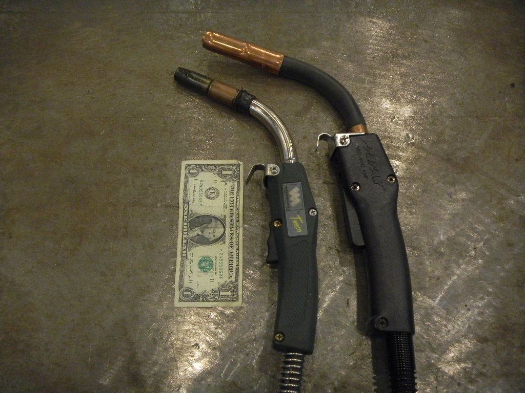

For self shielded flux core wire I've had the best luck with Lincoln's K-126 guns. I like the 15-feet length. Far as Mig guns I like the Tweco guns. But you will need adapters to run them on a LN-25.

That 350-amp, 60% rating is a joke! I've run those guns at 450-amps 10-hours a day, running 70-pounds of wire a day. Not one problem with them at all:thumbsup:. About every 40-hours of welding it is a good idea to blow them out. We use to remove the gauge on an oxygen bottle, remove the contact tip, place the end that goes in the feeder on the opening of the oxygen bottle and blow them out.
