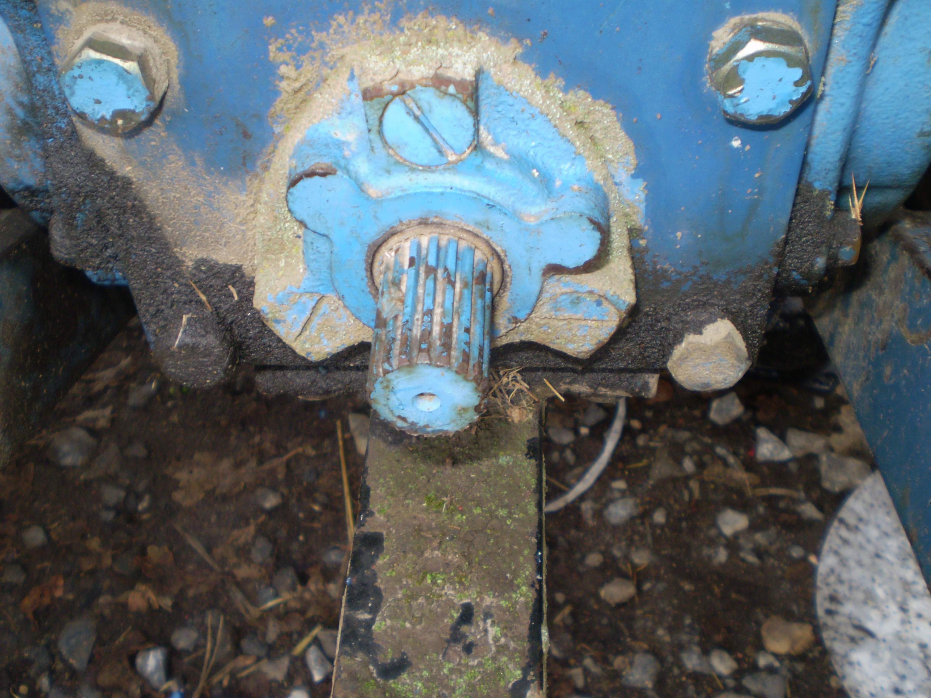

I am new here and hoping you guys can help me out. I have a satoh beaver 370d and a 2pr-1100a tiller the problem is I am missing the piece that connects the two. Its a short shaft that is square on the tiller end and has a 18 spline yoke on the tractor end. this shaft is maybe just 4 to 6 inches long. this tractor has an 18 spline pto. If anyone has a photo of the shaft I would love to see it, just so I know what I am looking for. Also if you know how to make one or where to buy one ancd could pass that information on to me I would really appreciate it. THANKS!!

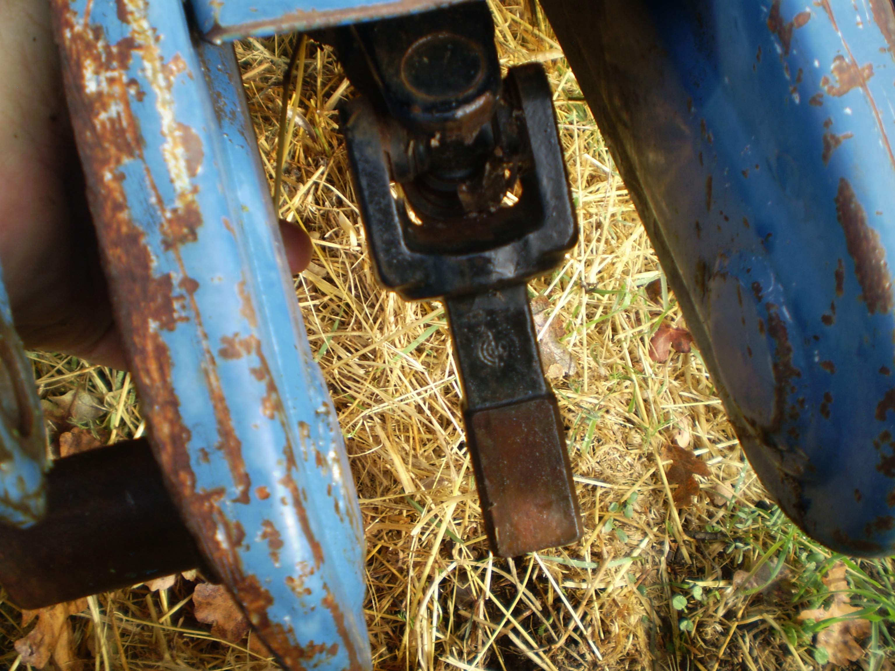

Hey oliver ...thanks...but I think that is just the 18 spline yoke that would go on the tractor end of the tiller drive shaft,,,right??...this tiller has a square or rectangular piece coming out of the tillers u joint. so I am thinking that is suppose to slide into another piece of the drive shaft that connects to the tractor.

Yes that is only the yoke. I'm guessing now that you need both yokes, the cross and the square tube? I'll look up the other yoke and cross.
   / satoh 370 & tiller, missing 18 spline yoke to run tiller. can i make/ buy one

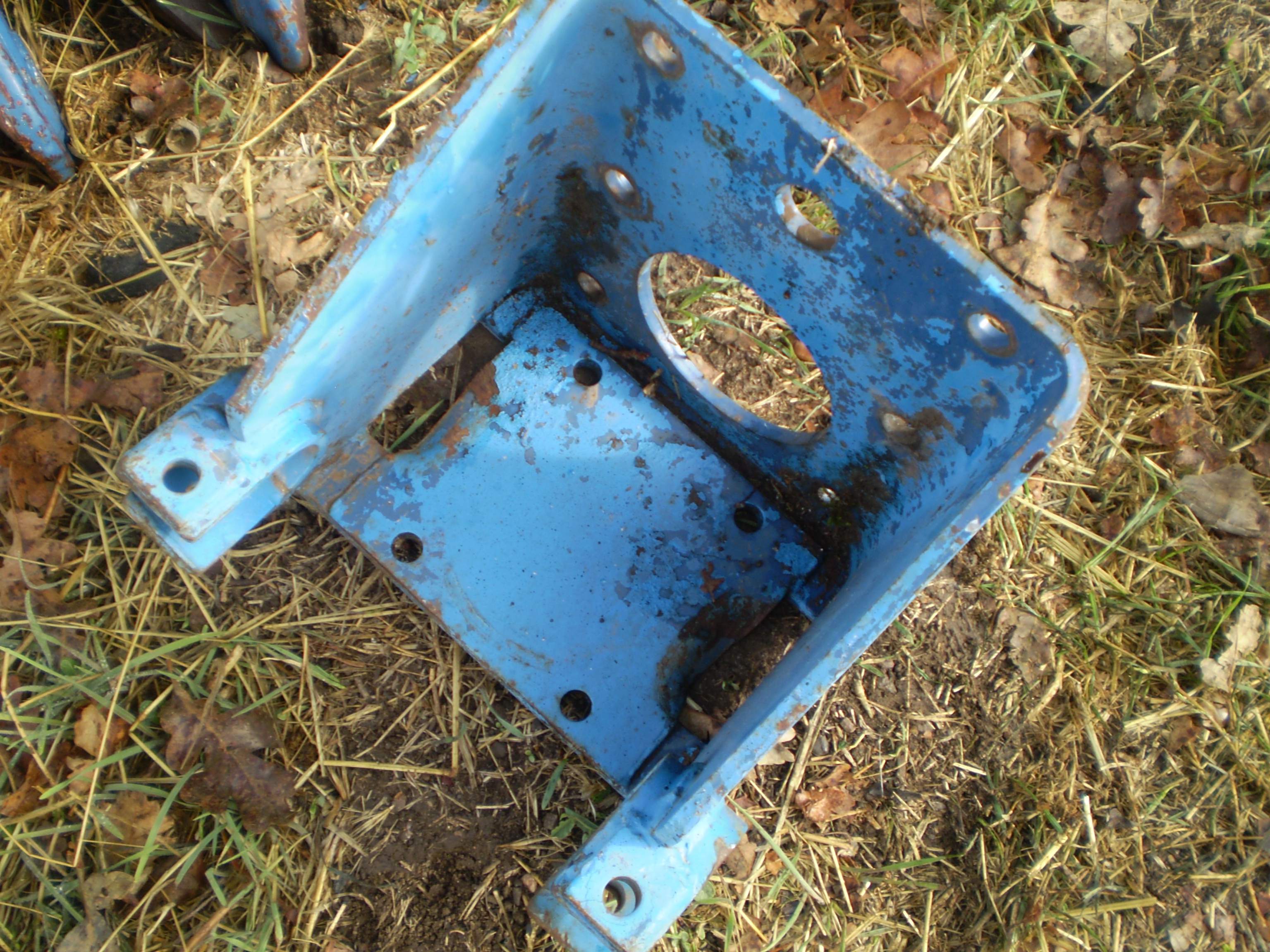

Yes oliver!..wow thanks..yea..I just have one yoke on the tiller with a square piece and nothing else..I will try to insert a pic here to show what I have. I would really appreciate it if you have the other part numbers

#9
