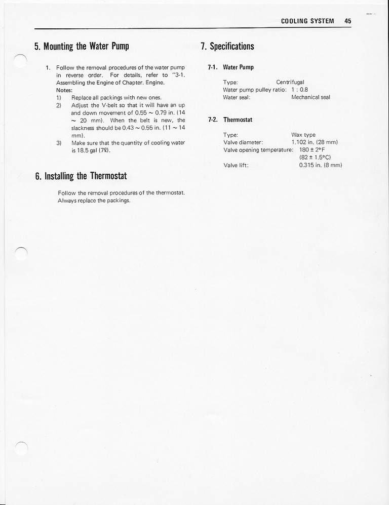

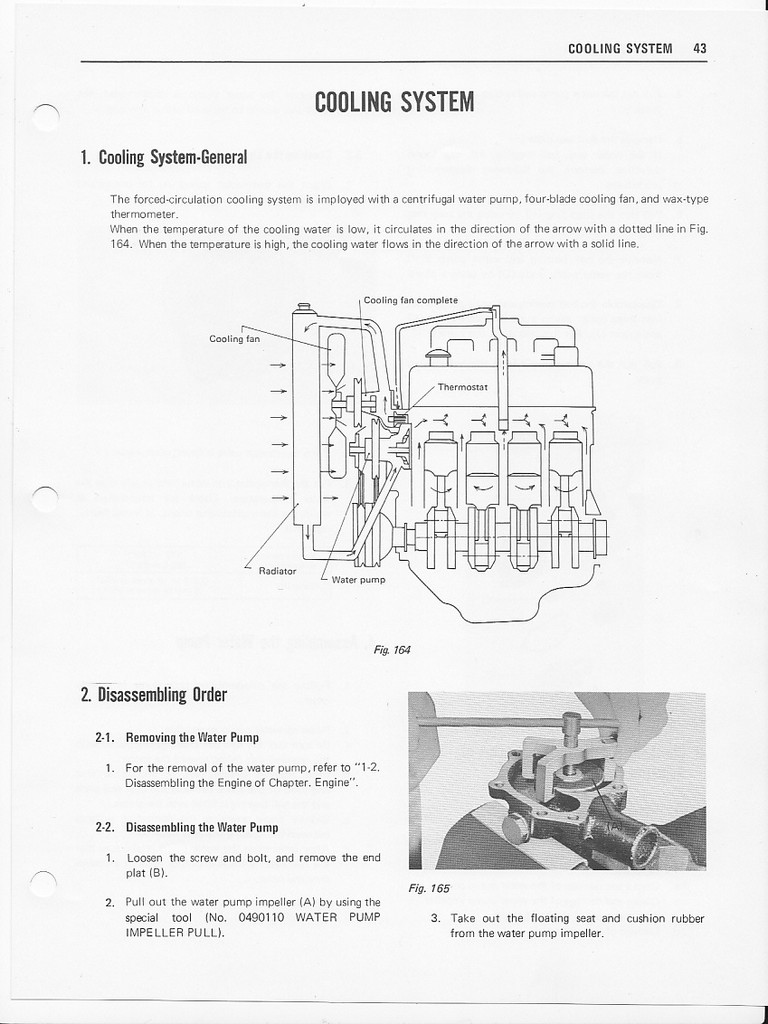

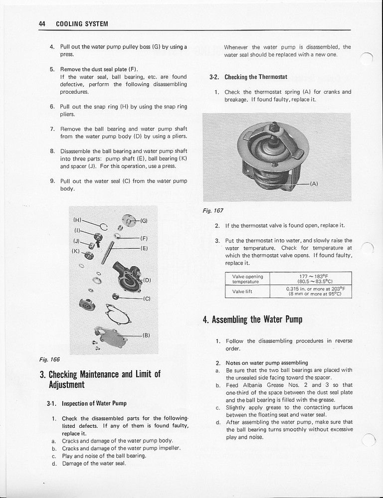

This is what sum total of the repair manual on the subject. Three pages. I hope this works as attachments 'cause I never tried it before.
The sending unit is on the fitting at the intake manifold.

you may want to flush the block with solvents to clean out the water jackets.you can try running it with a little choke on to c if a lean mix is causing it to overheat.
   / Satoh 650G dilemma #23
try going to NAPA or somewhere & get some engine flush. sounds like the block has gotten some blockage.you stated the mechnic said your radiator was kinda full... well this has to go trough your block as well. Also you could try running it w\o a thermostat. if it still over heats (since you ruled out radiator) then it has to be water pump or blockage in the block. by chance ... what color is the water each time you take hte hoses off if it's rusty colored then good chance it's blockage...one more thing... i have ran a wter hose backwards through the motor & got it to clear a blockage before.. just a thought

you put it back together fill it with water do not install the thermostat add prestone super flush .run the engine for the chemical to ciculate. or you can try the molasses and water. after a while remove the hoses from the rad and use a water hose to flush out the system.repeat this until you are satisified with the clean.

Ok. Here's my conclusion on the "over heating issue".
First of all, the sending unit placement is on the intake. Horrible design. And quite honestly, I've never seen an intake with water ducts built into it, but I'm not an expert.
The sending unit, again, heated up and turned on the light. So, I took a meat thermometer, pulled off the radiator cap, and stuck it in the water. 140 degrees. Took it out, drove for a while, came back in, test again: 148 degrees.
Now, keep in mind, this is with a new water pump, a re-cored radiator, a new sending unit, and with the thermostat taken out. Also worth noting, no smoke, no bubbles, and no misses in the engine.
One person posted it could be because it's running "lean". Not sure what to test there.
From here, I'm putting in a manual guage to monitor the temperature, just to be done with it.
