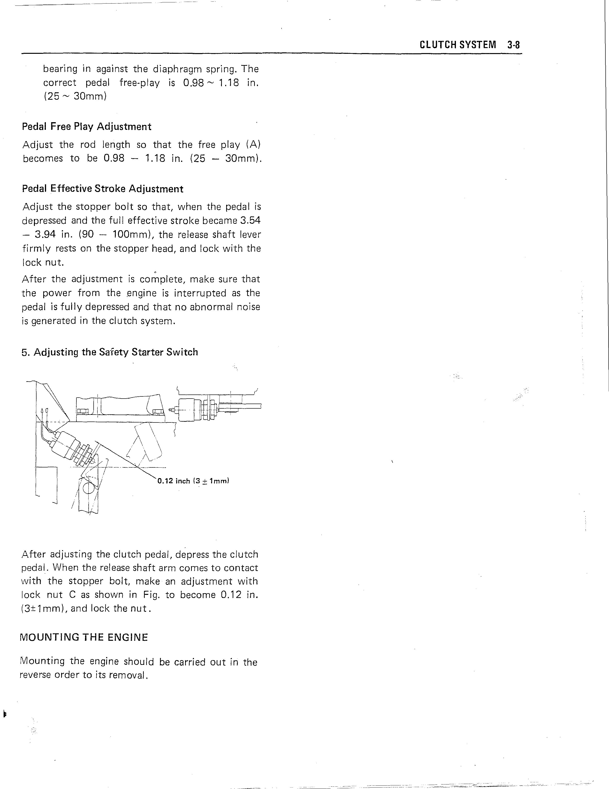

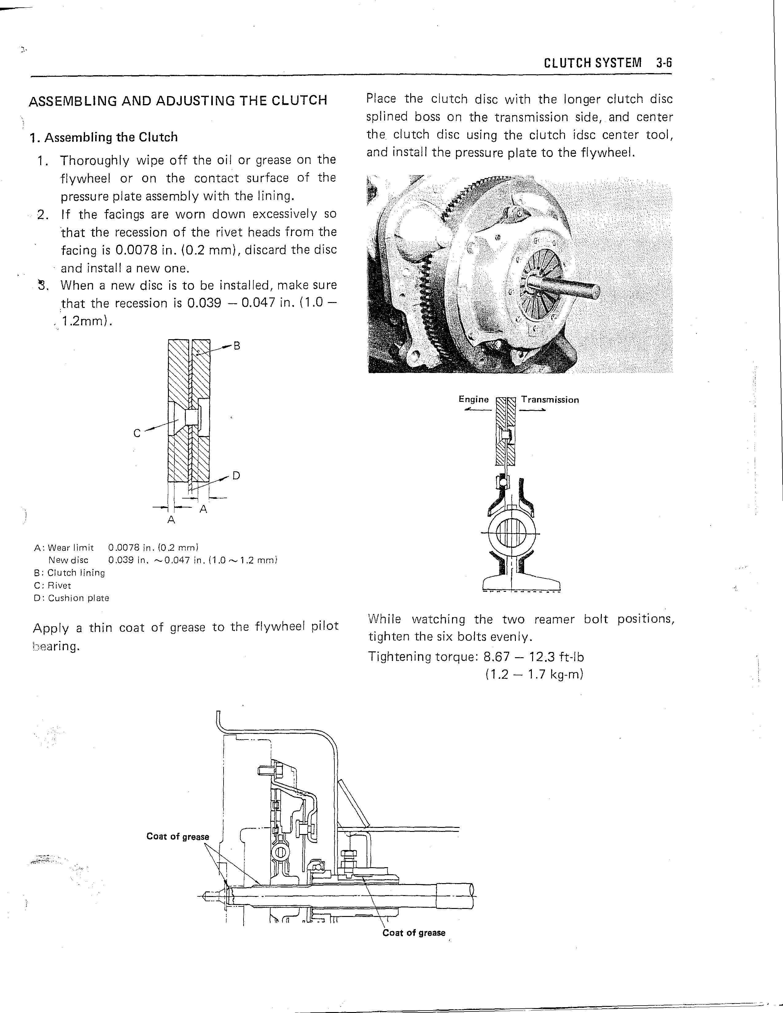

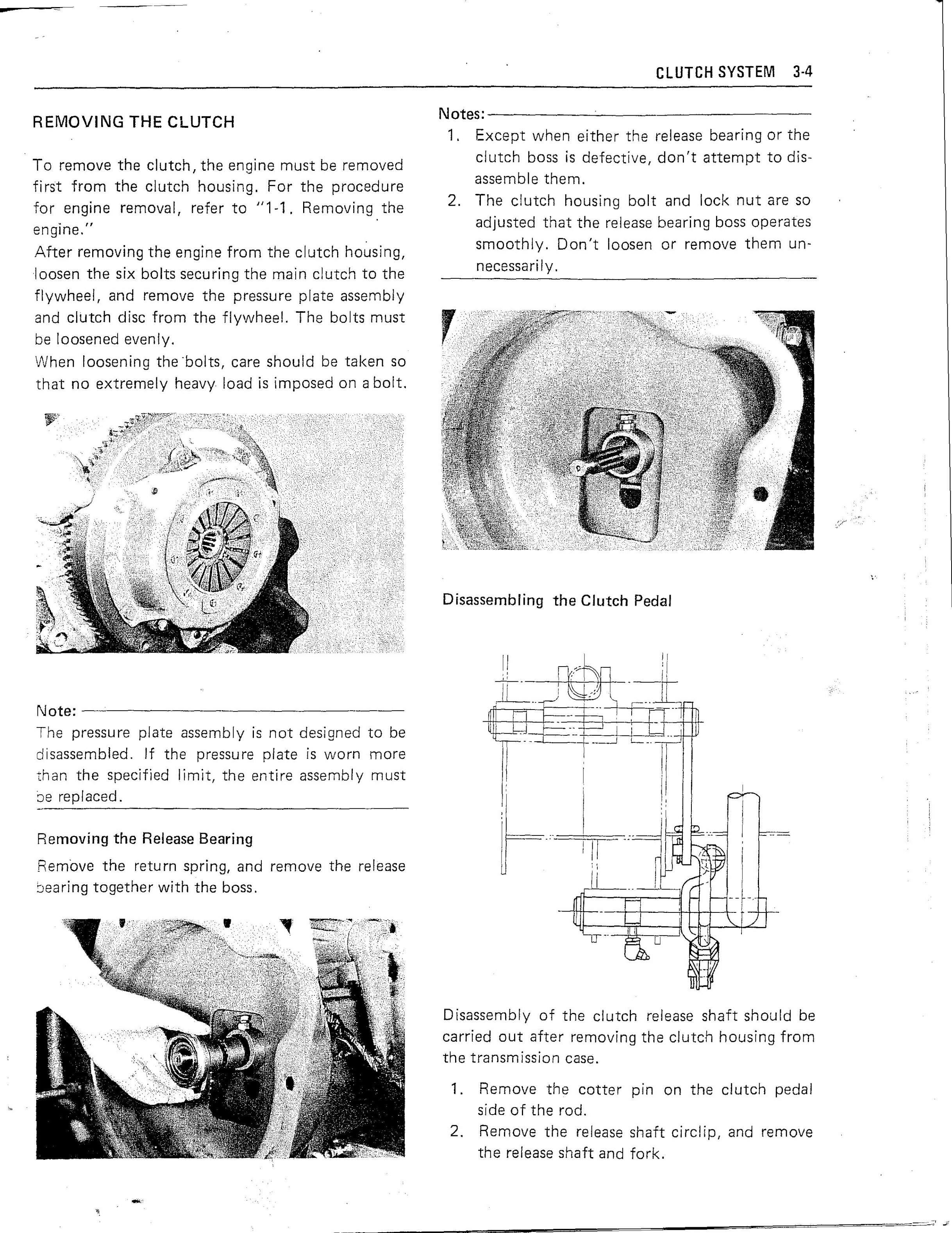

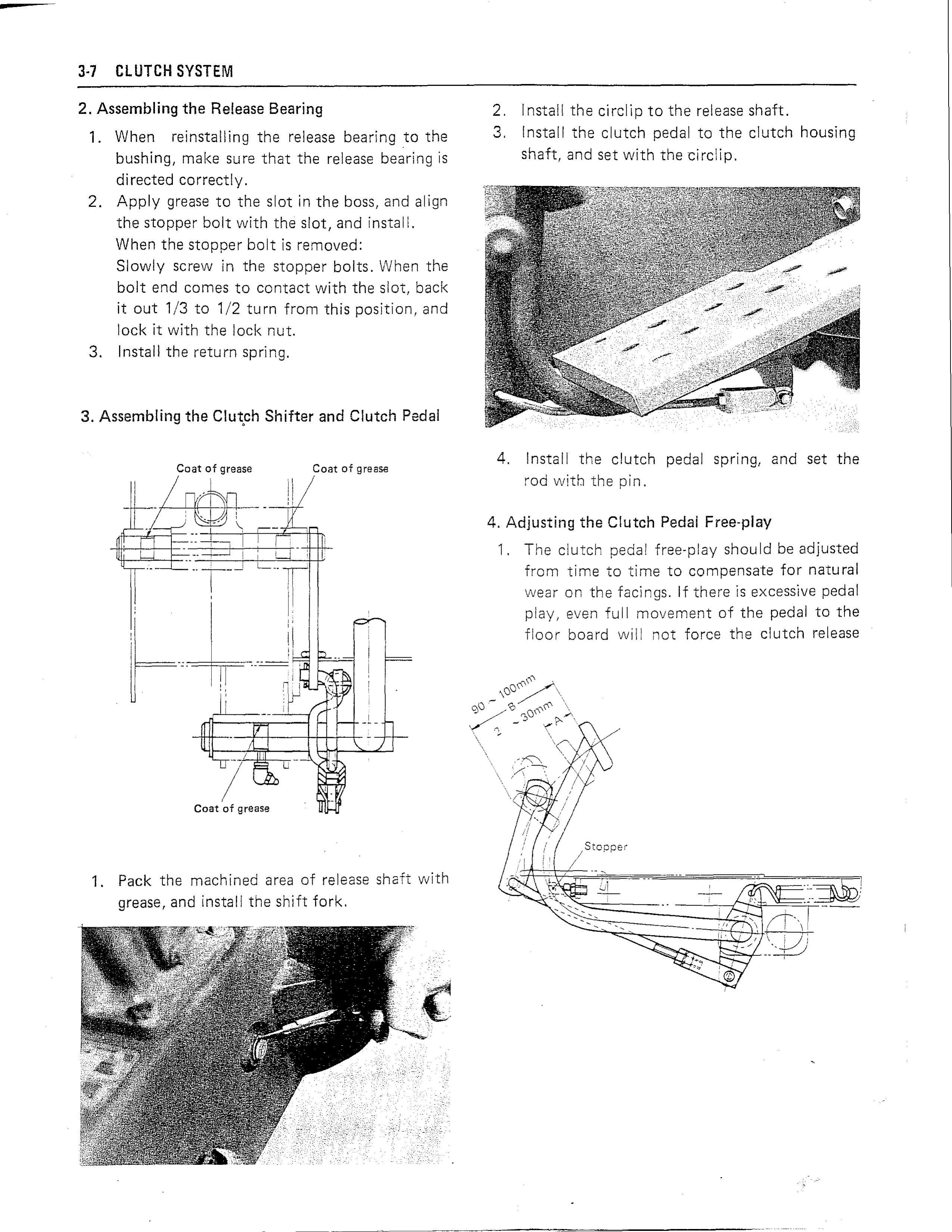

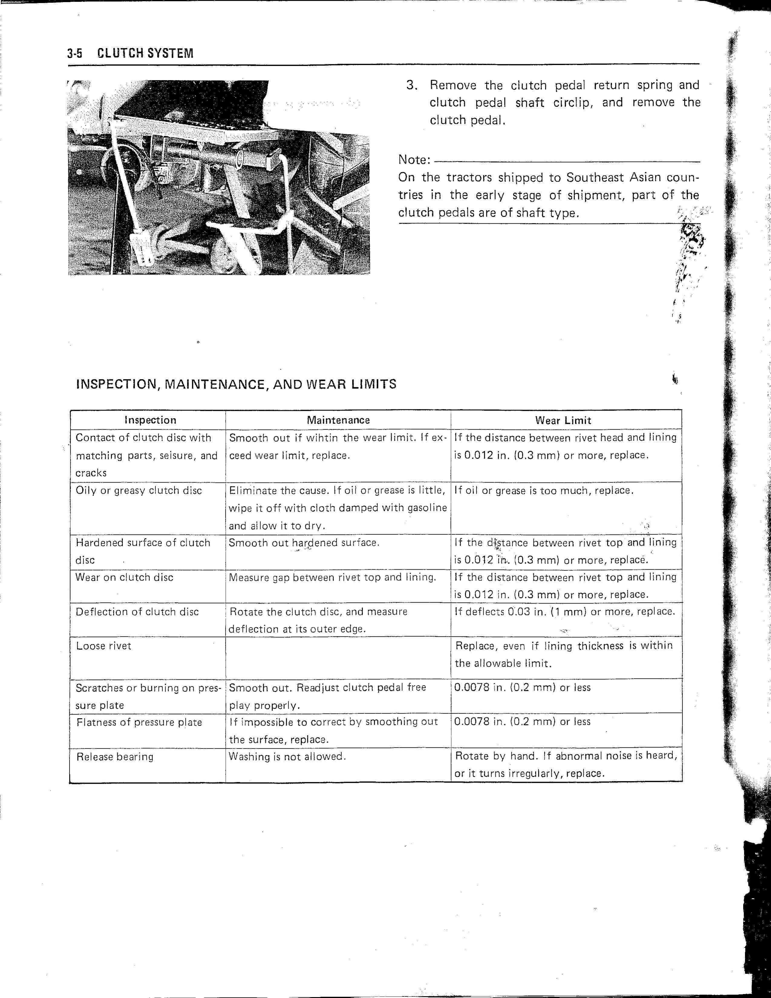

I HAVE A SATOH BEAVER 370D 4WD 2CYL DIESEL NEED SOME HELP ON HOW TO PULL THE CLUTCH OUT. ANY BODY GOT THE PROCEDGER ON HOW TO DO IT.
/ SATOH BEAVER 370D #2
Do you still need info on pulling clutch? I have a manual and could copy those pages and send to you. Let me know.
/ SATOH BEAVER 370D
sorry wasn't on computer had kidney stones . but yes would aperciate it also do you have any thing on how to get the fork out it seize up got it soaking it in wd 40. also were can i get parts for it . thank you for your help
/ SATOH BEAVER 370D #4
I don't know about removing a stuck fork, but have scanned and attached the pages from the manual on Clutch removal, replacement and adjustment.
Hope it helps.
ClutchRepair1.jpgClutchRepair2.jpgClutchRepair3.jpgClutchRepair4.jpgClutchRepair5.jpg
