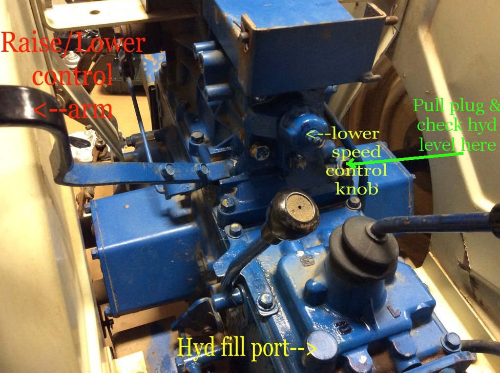

It will hold around 3.5 gallons if you are changing the oil. Two drain plugs on the bottom. There is a screen filter on the right side of the rear housing near the bottom. Held in by two bolts. Take this out and clean the fine mesh screen and look for holes. There is a hard rubber plug next to the gear shift for filling. There is also a fill level plug on the left side that looks like a bolt that's not doing anything. You can pour oil in the top until it comes out the fill level hole. That way you know you are at the correct amount. (level ground of course) Many say you can use 80w-90 if you don't have a loader or other hydraulic attachments.
   / satoh beaver III #7

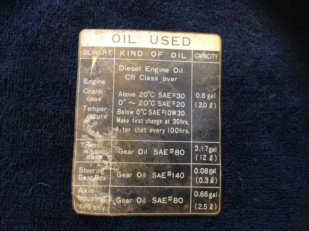

This sticker came off of my Satoh 373D but I put Service Pro Premium tractor hydraulic fluid in mine in 2015.
The original owner's manual also says that you can use 80/90 but I chose to NOT use it.
The manual is from early 1980's and oil technology has changes a bit since then.
Yes, the same fluid is in the tranmission and hydraulic lift. To each his own.
