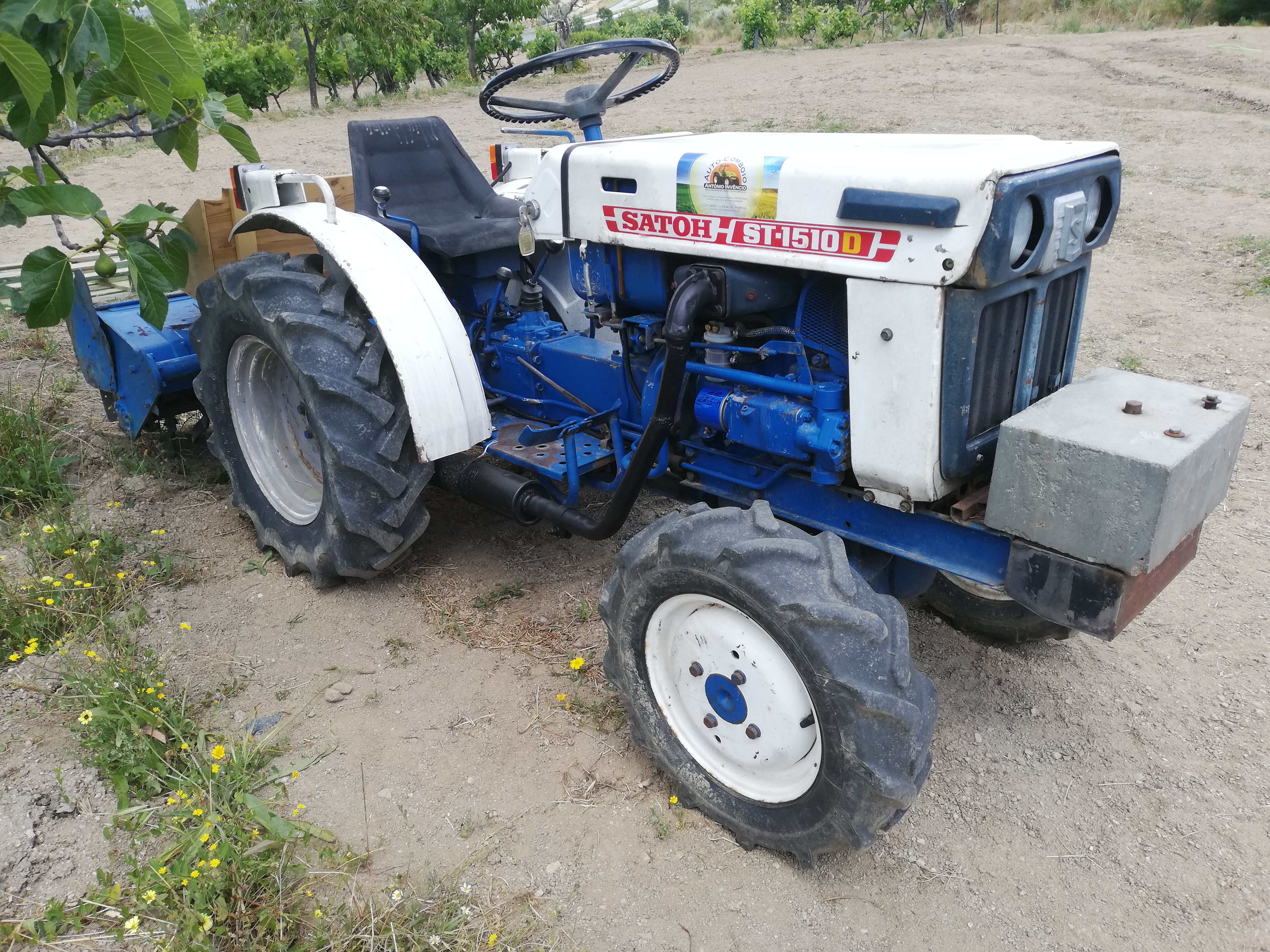

Satoh ST1510D identical to Beaver S370
Hi all.
The tractor is a Satoh ST1510D 2 cyl 4x4, recently acquired.
For what it's worth similar to Mitsubishi M372D, Beaver, etc.

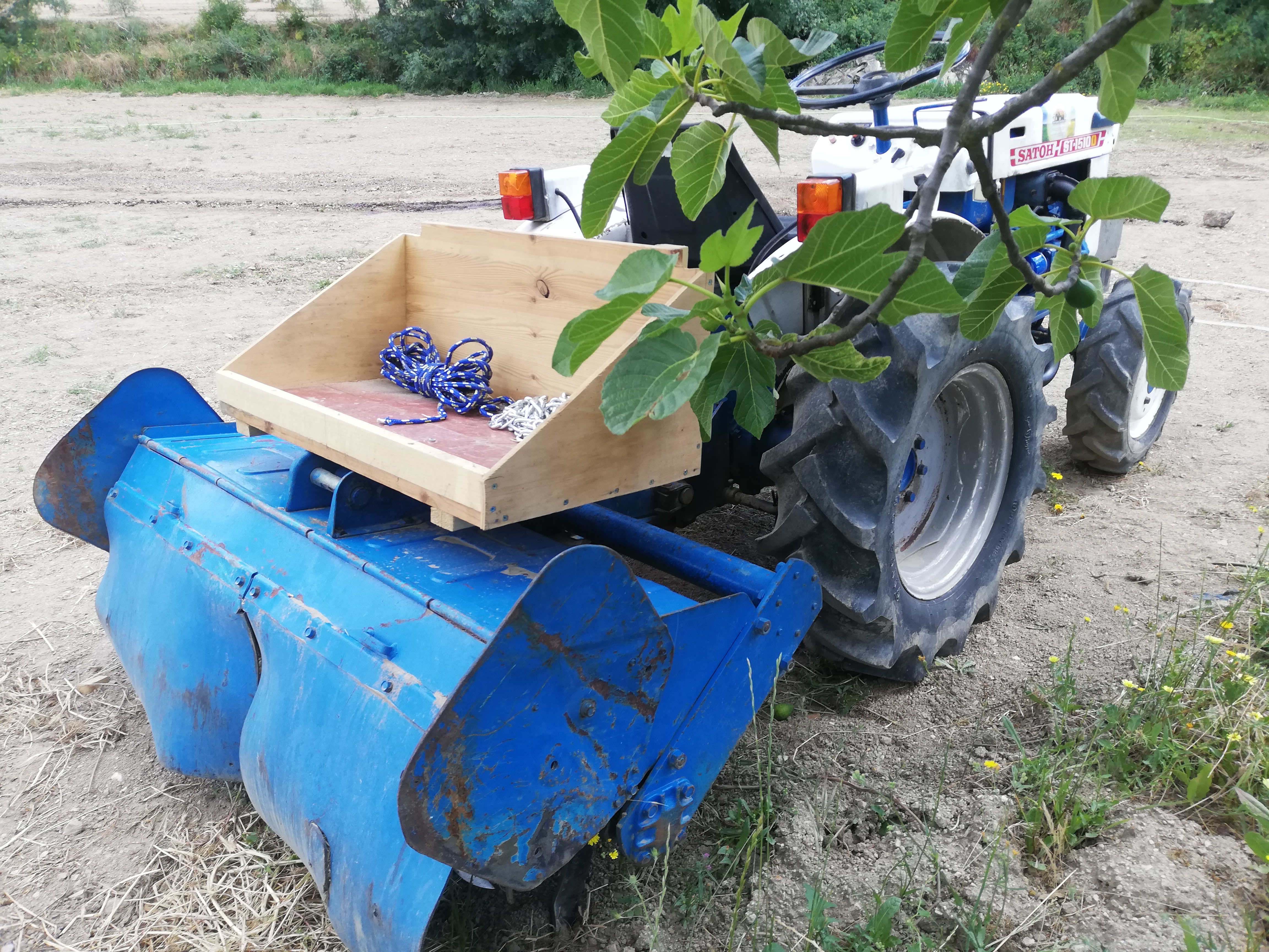

Edit: If wondering, the "box" was swiftly put together with some left over materials. :thumbsup:
Since it came fully equipped with some mud, a lot of dust and nothing else. :laughing::laughing:

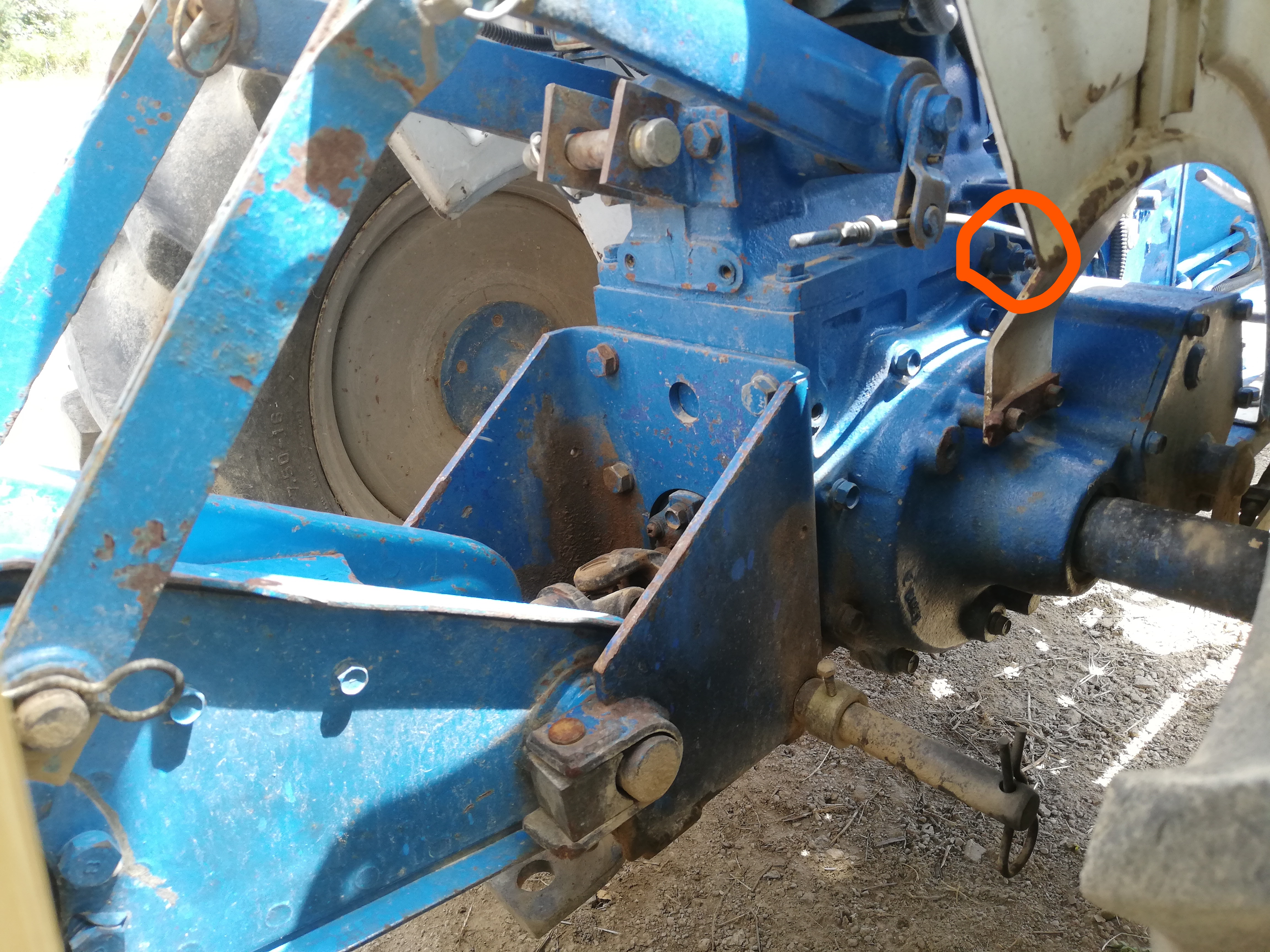

There's no reference to both, BUT there's a 3 point descent speed control.
It's located on the side of the case with a small lever. Marked in red. That I didn't notice before.

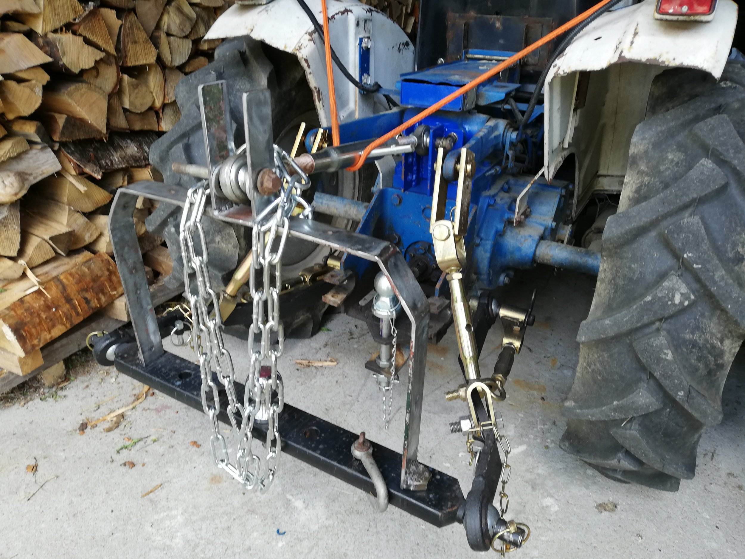

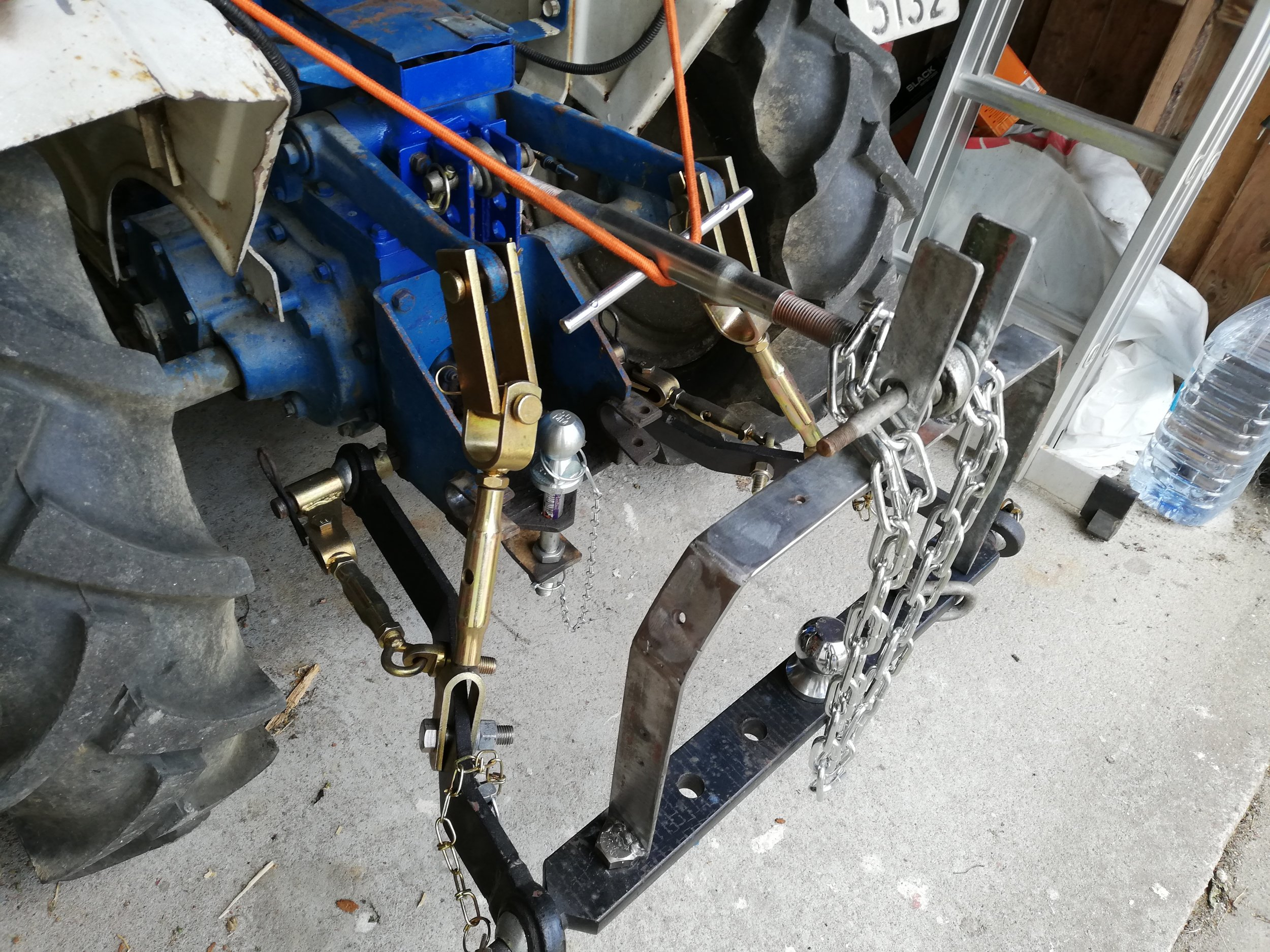

Hi (Warning picture heavy post)
I just went outside to get a couple of pictures of this cat 1, 3 point hitch.

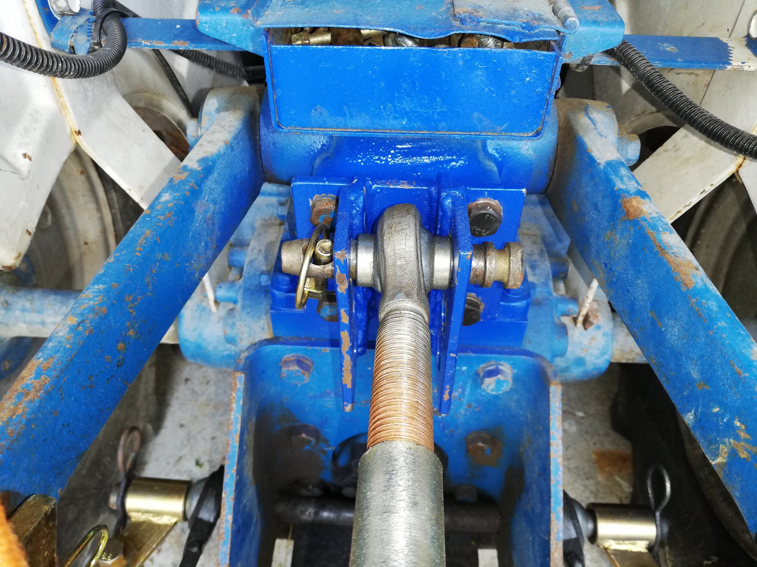

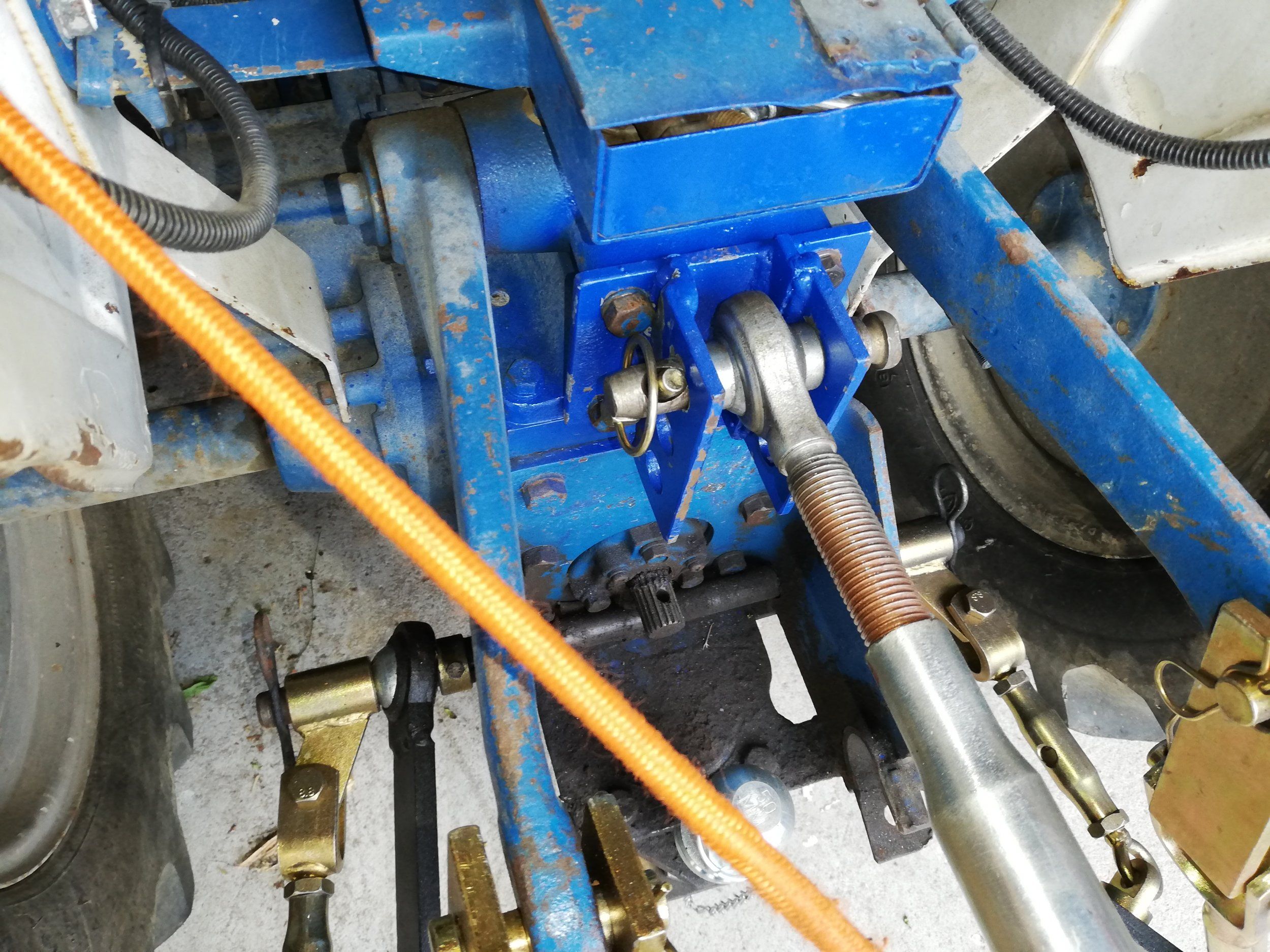

For what it's worth it fits perfectly! EXCEPT, please notice this detail is important, for the plate where the top link connect (deep blue color)!
With this said, there are two options. Grind or cut the tubular connection of the top link making it slightly narrower. To fit the original support plate. Or like I did, make a new top link support plate. FIY I used 6mm plate.
Which will allow any cat 1 top link to fit unmodified. Saving my future sweat, since now it's interchangeable with anything (cat 1) I throw at it!
This entangle a small problem, notice the bolt pattern is rather narrow. So additional plates had to be welded to provide the necessary clearance, for both the top link and the bolts! If you zoom the 2 first pictures, it's self explanatory! The use of Allen bolts (unbrako) can give a little more clearance. Since it's a really tight fit. ;-)
Notice the quick and easy way out is to simply shorten the top link connection tube!
Before anybody ask. The quick attach hitch with the trailer ball, etc. is inspired on the great work of this guy:
Mine is not finished, it's missing the upper holes (above top link), paint and finishing touches! But the general idea is clearly visible. The drawbar is a 600 mm unit (eBay). Pretty much on the limit of what fits in there.
The PTO is the OEM 18 spline!
Cheers all
