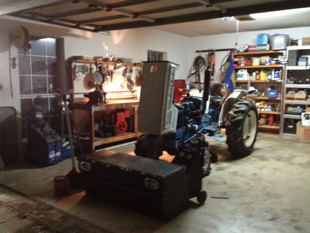

Thanks Gale, sounds like a toss up, maybe MMO in the crank case and SeaFoam through the fuel system? We'll see what we're dealing with for sure to make a game plan. Just shut down for the night. Finally got the other project running and moved out. Decided to clean up the garage before moving her in place. Did y'all know that it's an EXTREMELY hard task moving it with two shot front tires? I thought i wouldn't make it there in time before it starting getting to hot. I was tempted to just cut the darn things off to ride on the rims!

Hey that is a nice looking tractor from that shot.

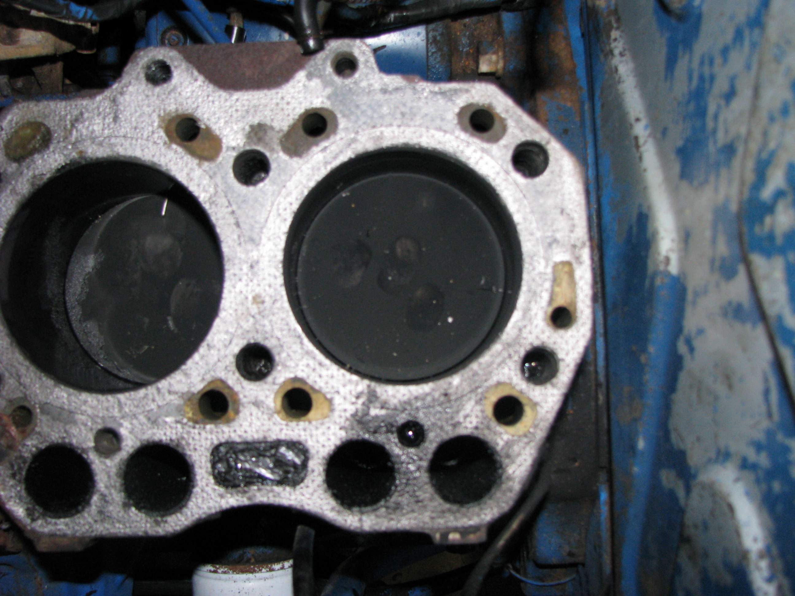

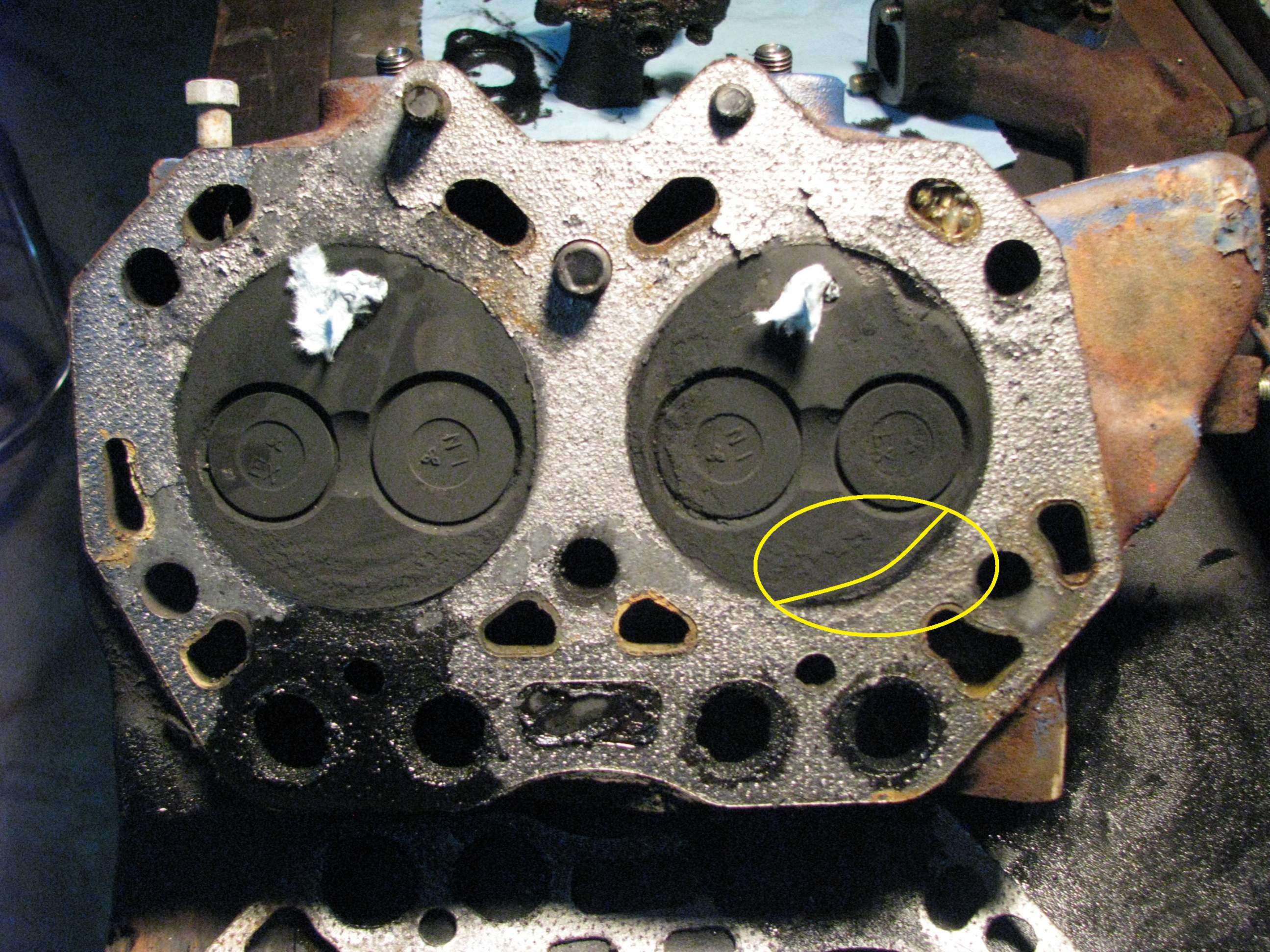

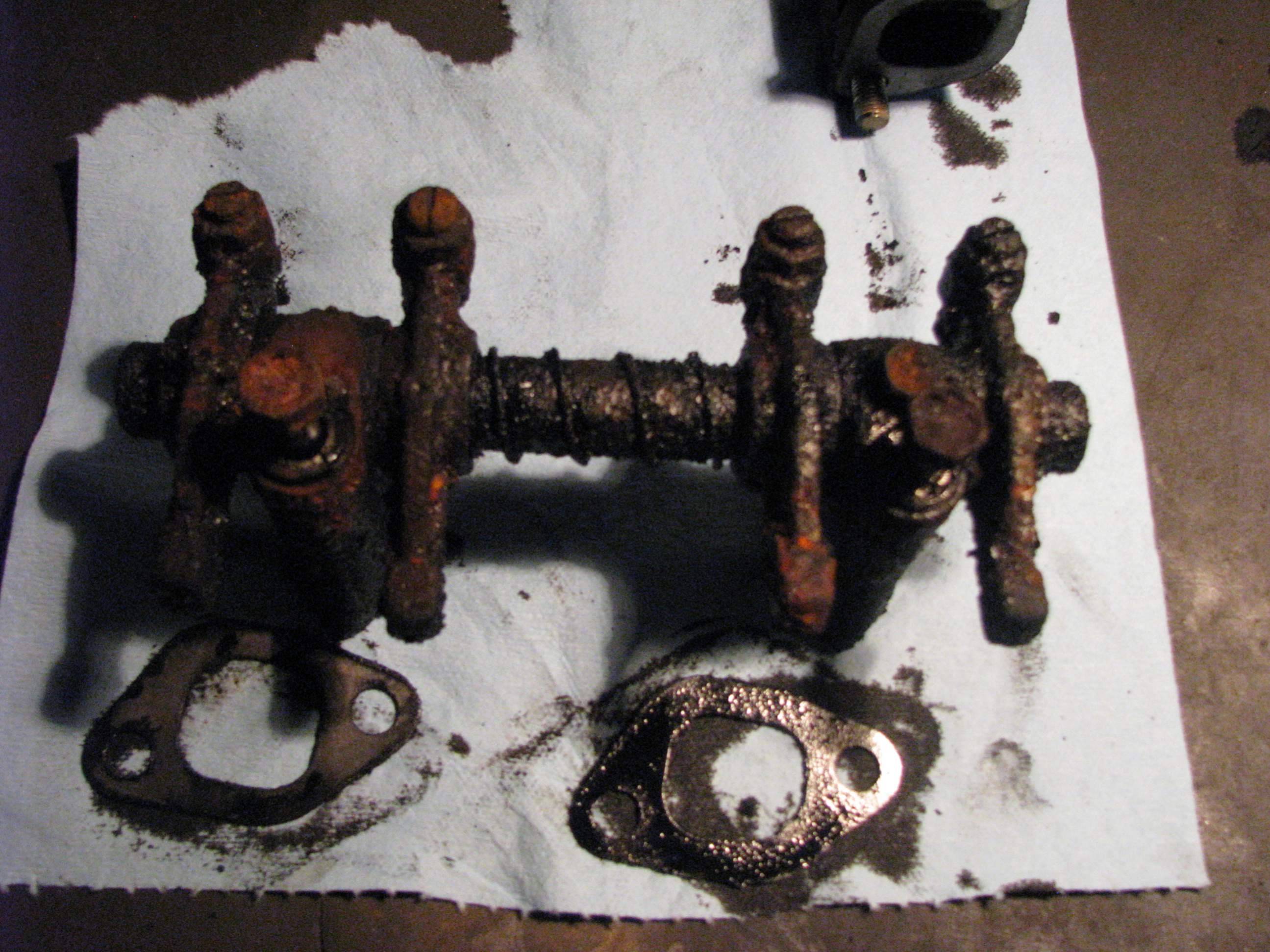

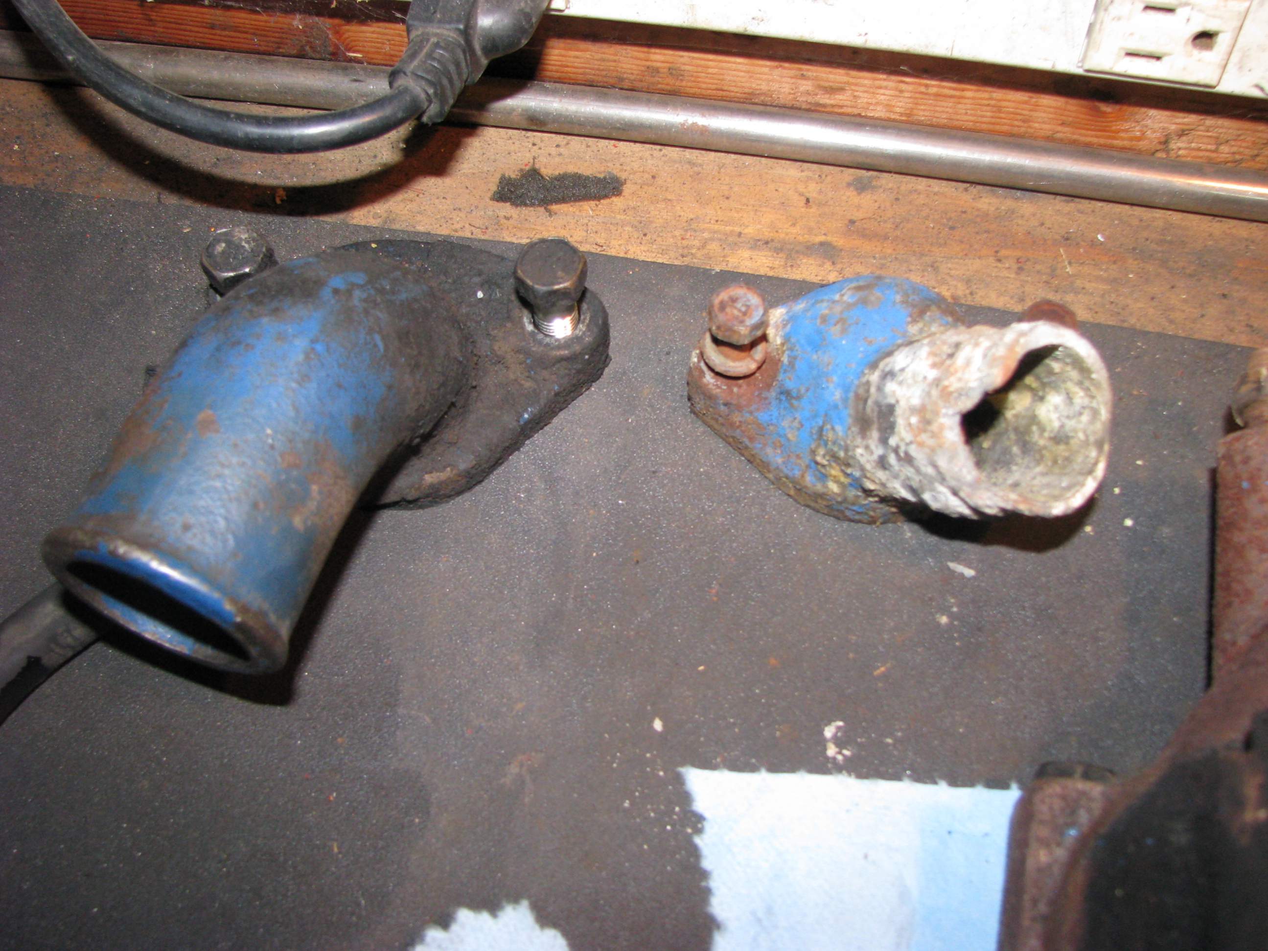

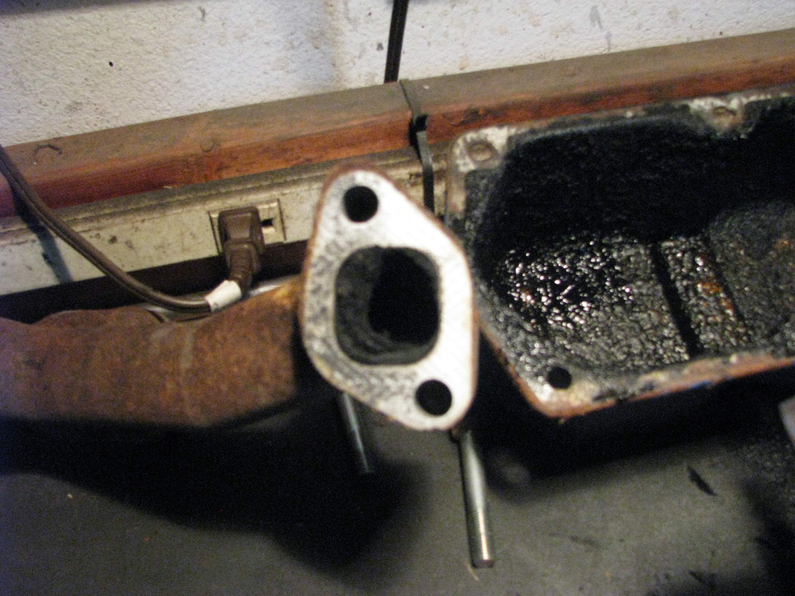

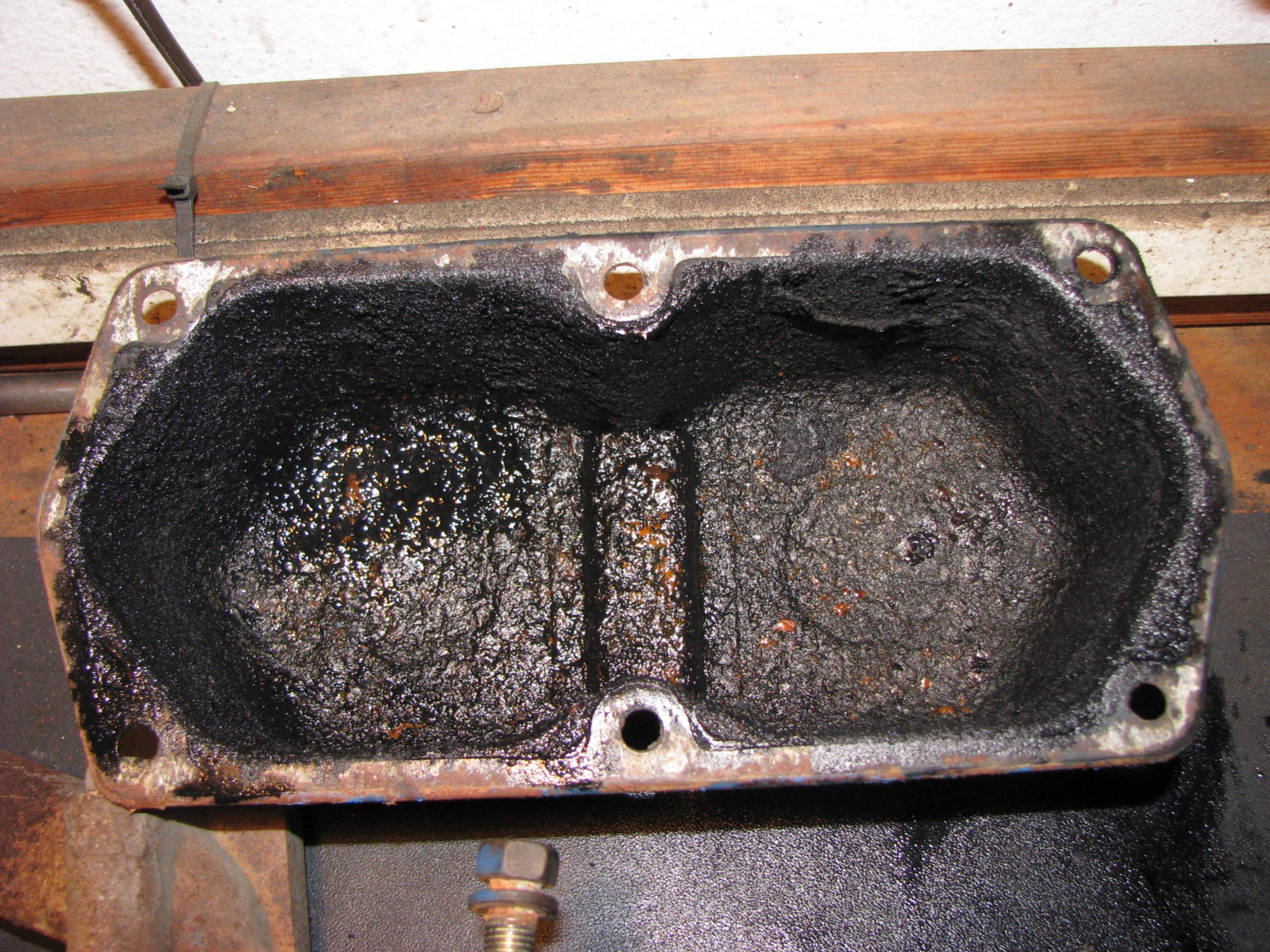

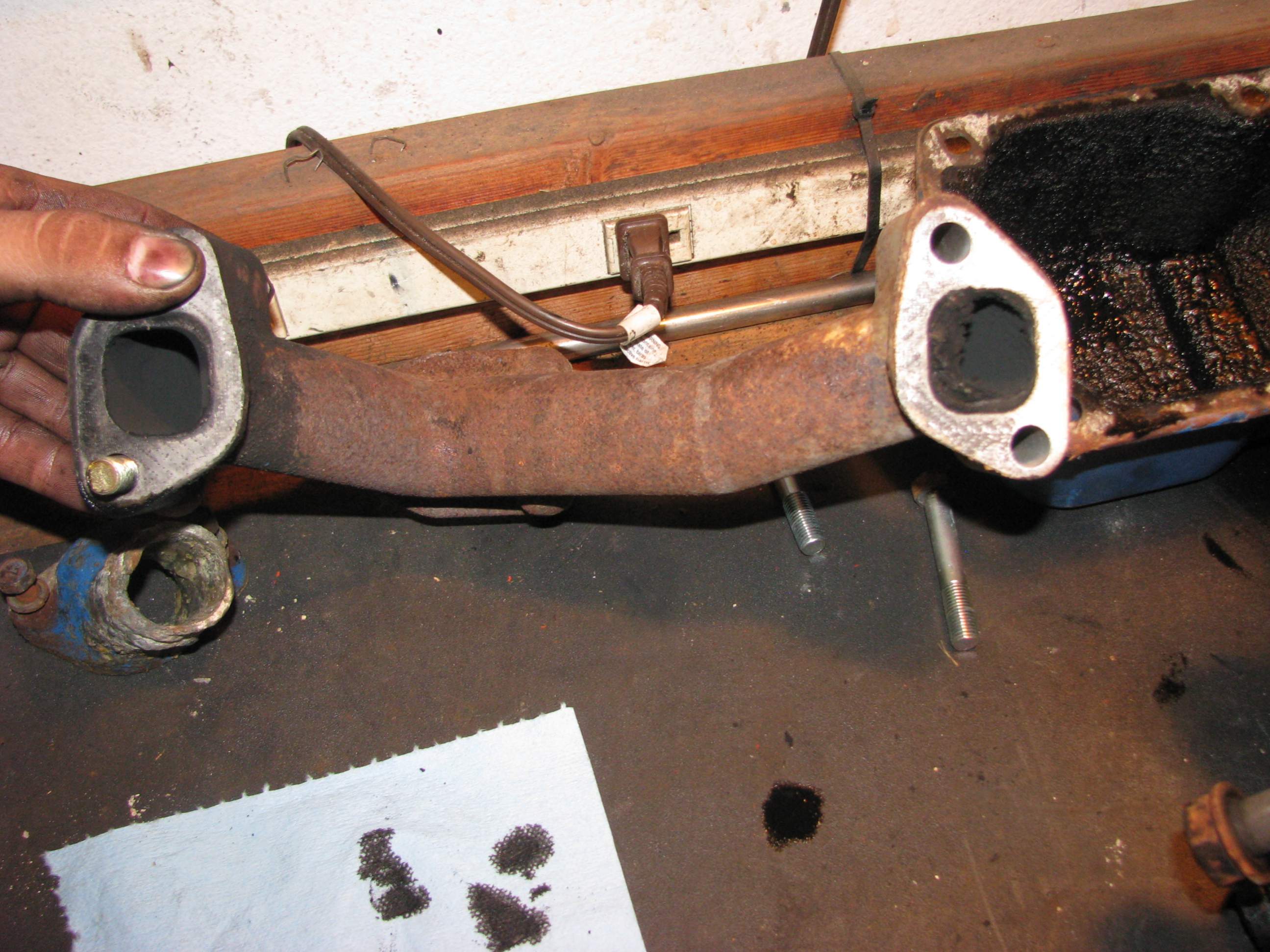

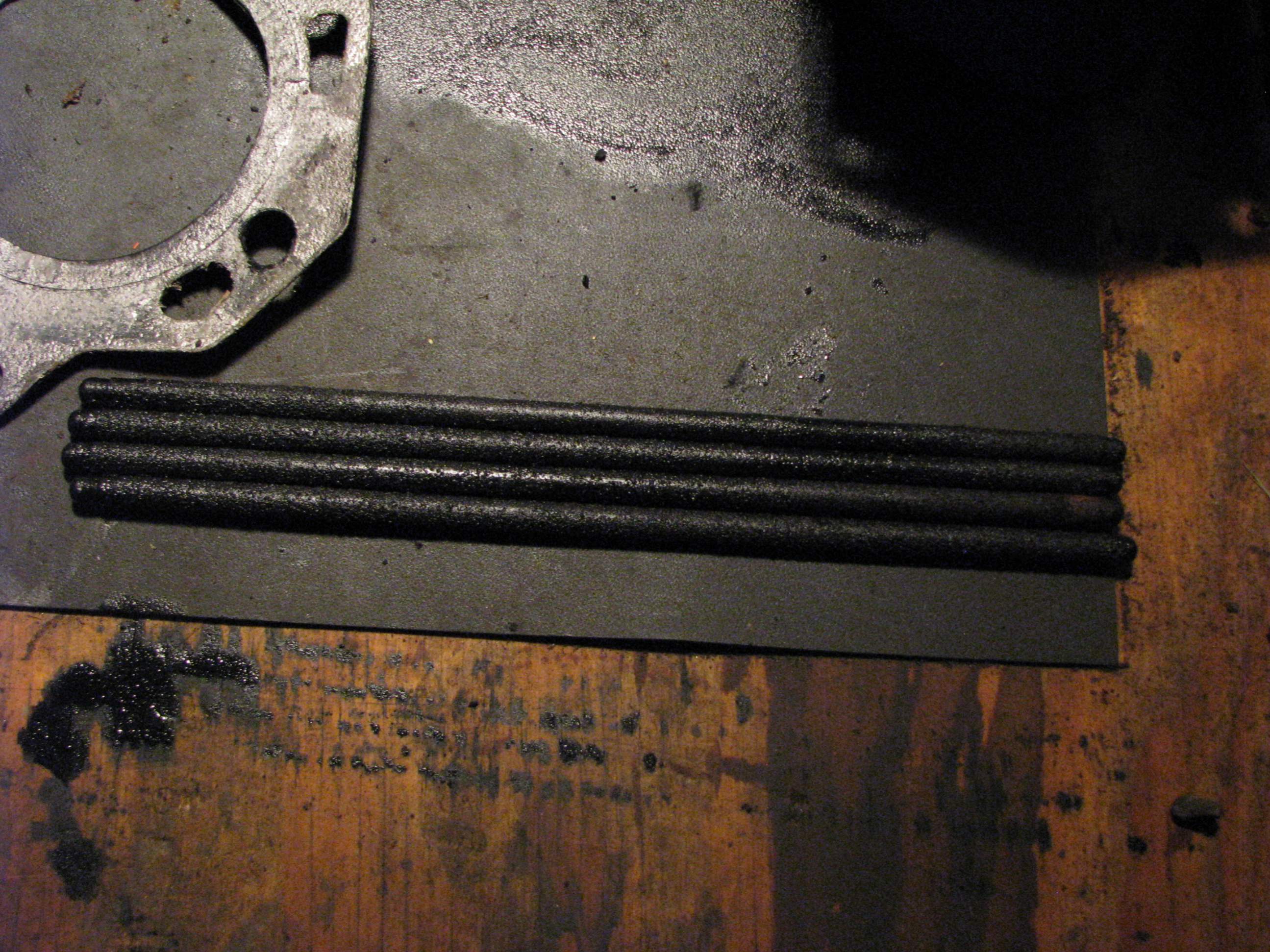

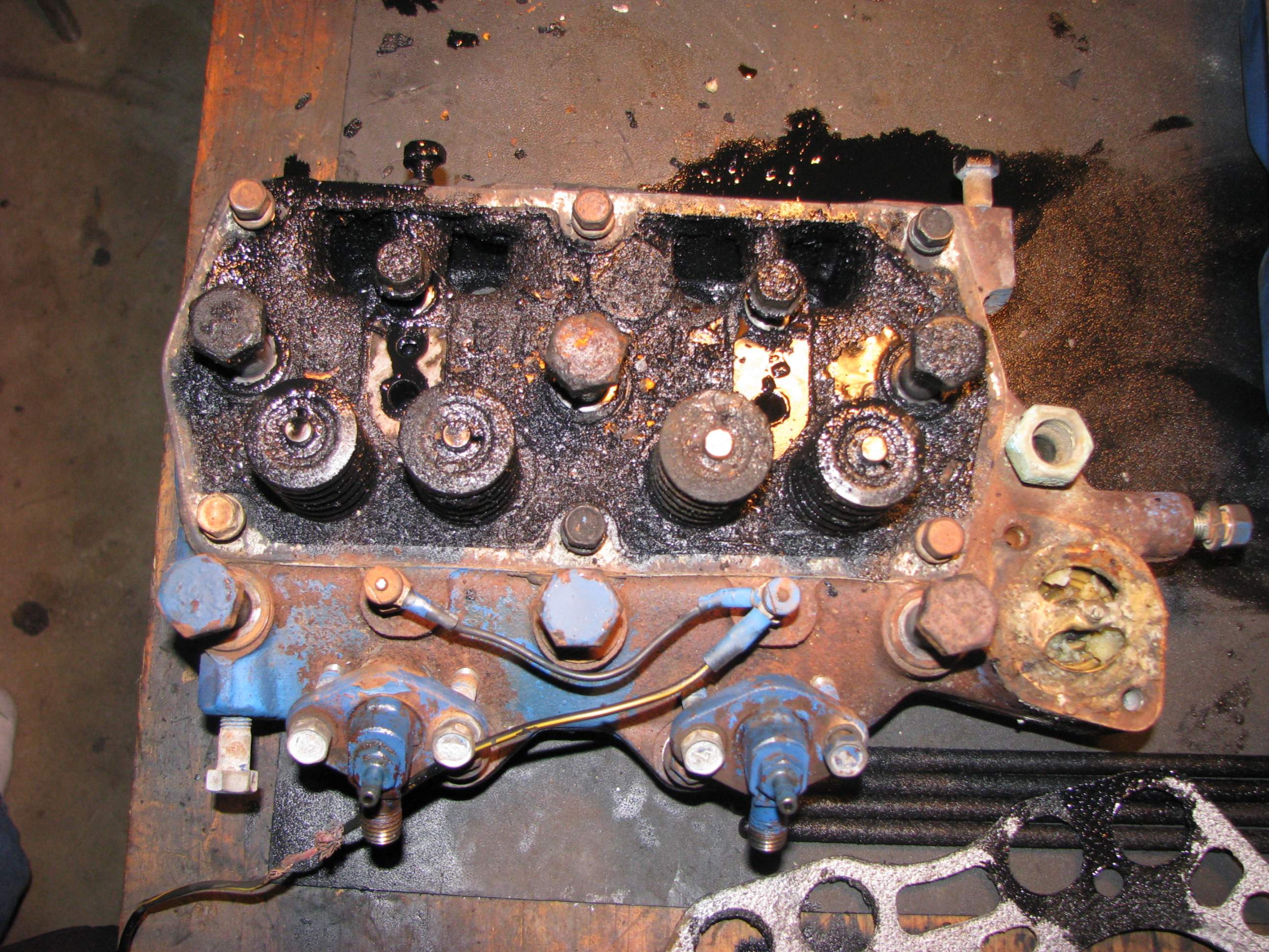

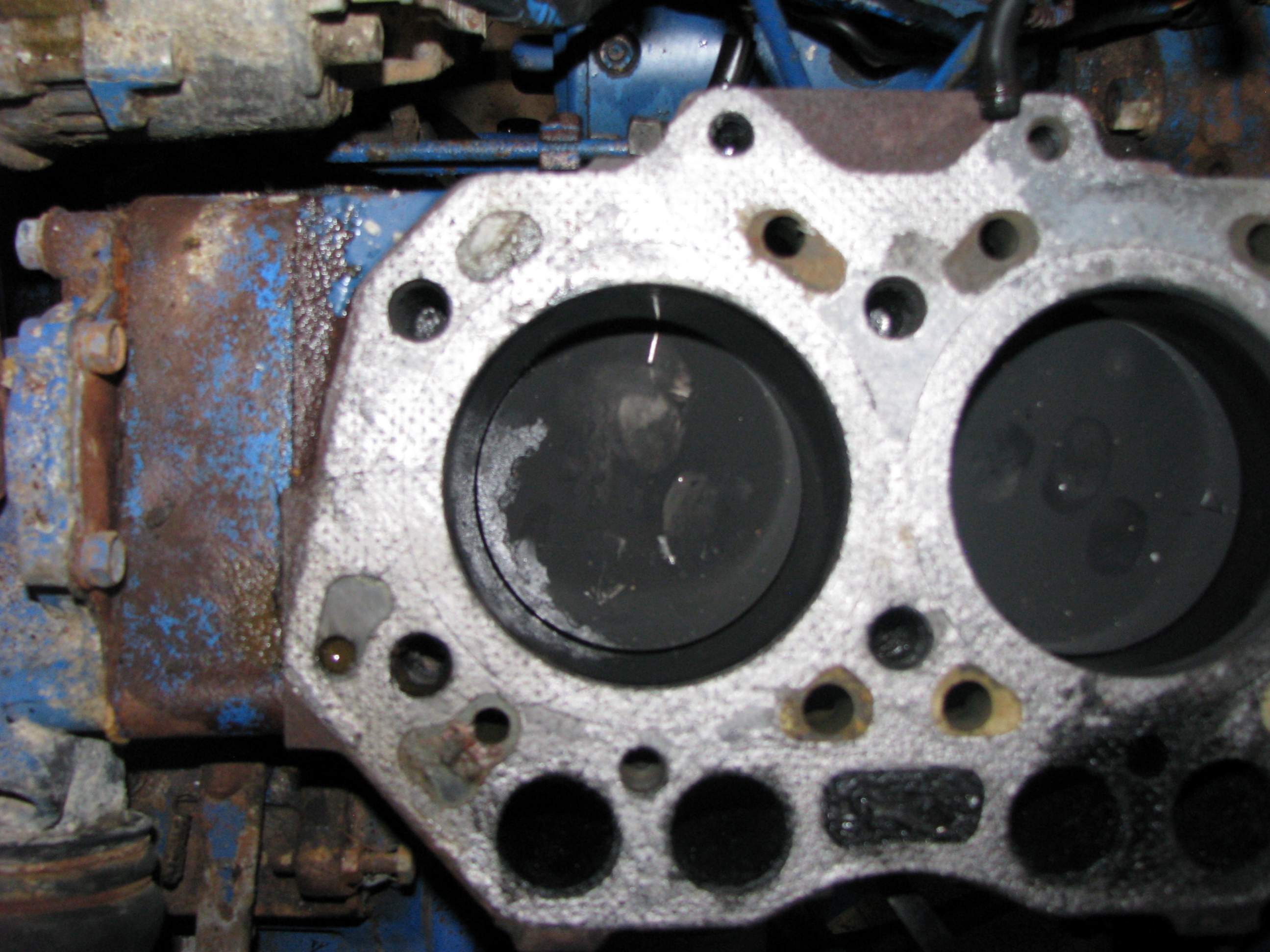

Well it was exactly what I didn't want it to be but it is what it is.
Looks like its not just a head gasket. Rings are toasted. At first I couldn't see anything on the head gasket, then I could see a very tight path that went literally through the middle of the gasket to the front left water jacket. It was interesting to see that it left the top and bottom of the gasket intact. It also looks like the PO also caught on to it being a head gasket issue. Found lots of gunk like someone poured liquid glass or something in the coolant. Lots of corrosion set in and it did a number on the thermostat housing. No wonder it may have had a sticking valve! Lot's of carbon build up and a little rust forming up top on the valve train. Won't know how bad shape the bores are until I get my book for numbers. Roughly it has about 0.080" of space between the piston and wall using the rule of thumb with a feeler gauge. But I'll check it with a bore gauge for final numbers. Hope the pics aren't to big...

   / Satoh S630D Runs Away! #16
Bet they did not change the oil every year and antifreeze every two years.
I will be interested to know if the rings are compressed and frozen in place by carbon build up. Was there any ring grove. If not it may be mainly a ring issue.
Bet the inside of the engine will look cleaner soon. :)
#17
Updated the head gasket pic with a better explanation. Bores are clean, no scuffs or scoring, no signs of heat stress. I can physically move the pistons around. Looks like the cause as you mentioned was negligence on the oil changes. Took a look again and the fact the cylinder 2 is still firing in the shape it's in, I may be able to get away with some quick honing, rings and bearings if needed while their off. I don't expect to run the tractor thousands of hours a year. It took me at least three years to accumulate 280 hours on my 790 JD using it fairly often until the last year. This engine is really disgusting inside all over. :yuck: I can tell it's been apart once before, they guy did say they did do rings way back when supposedly.
