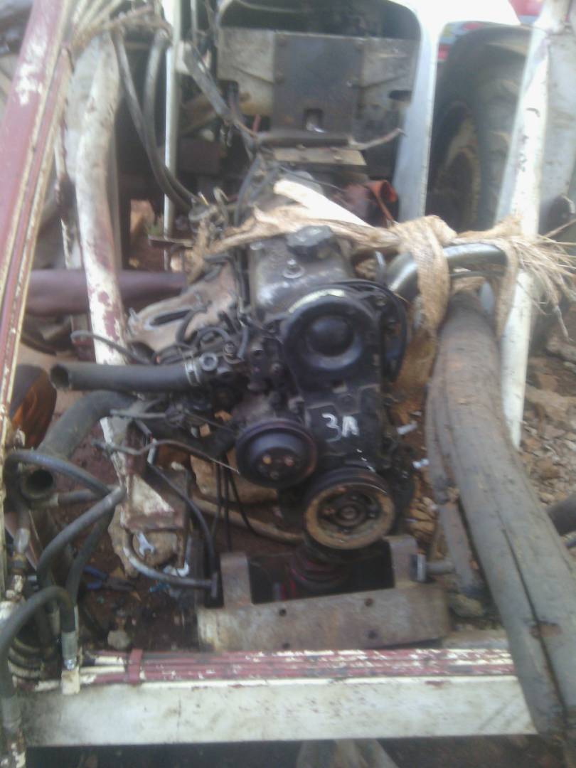

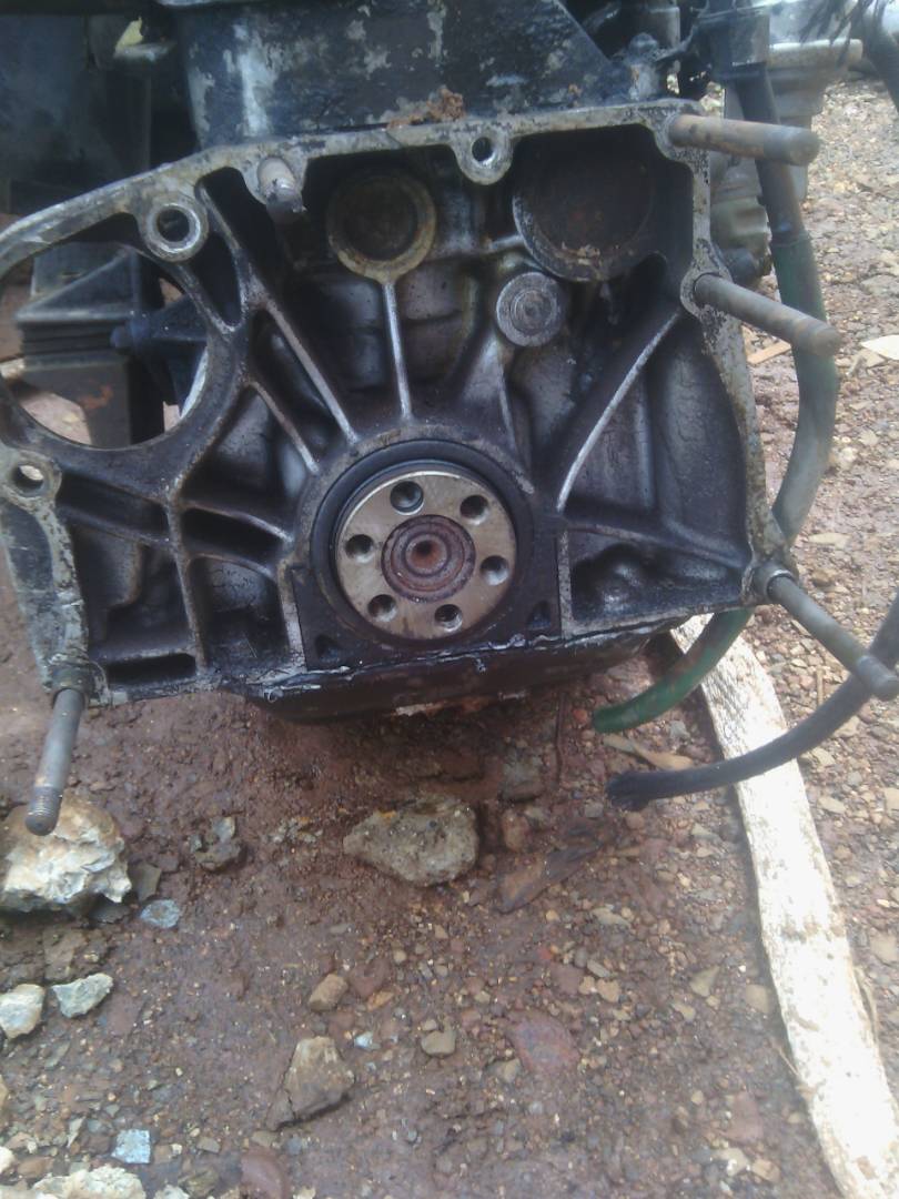

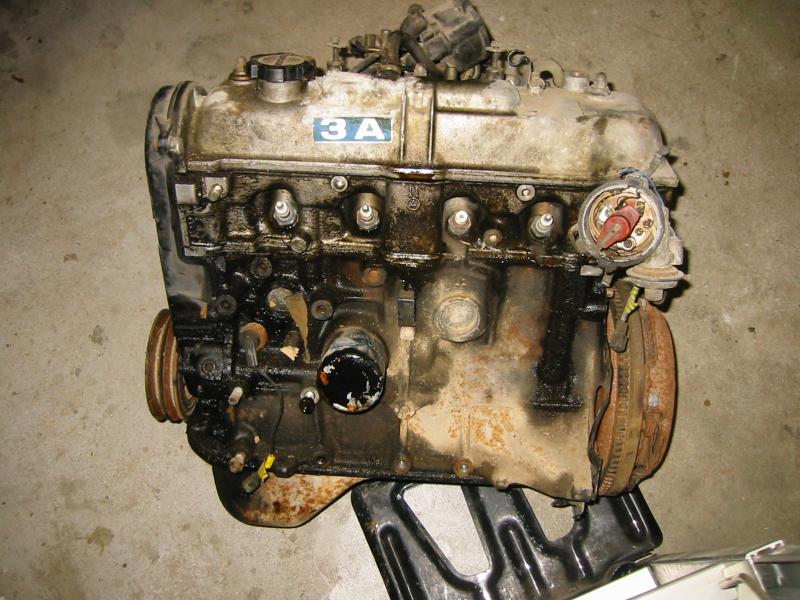

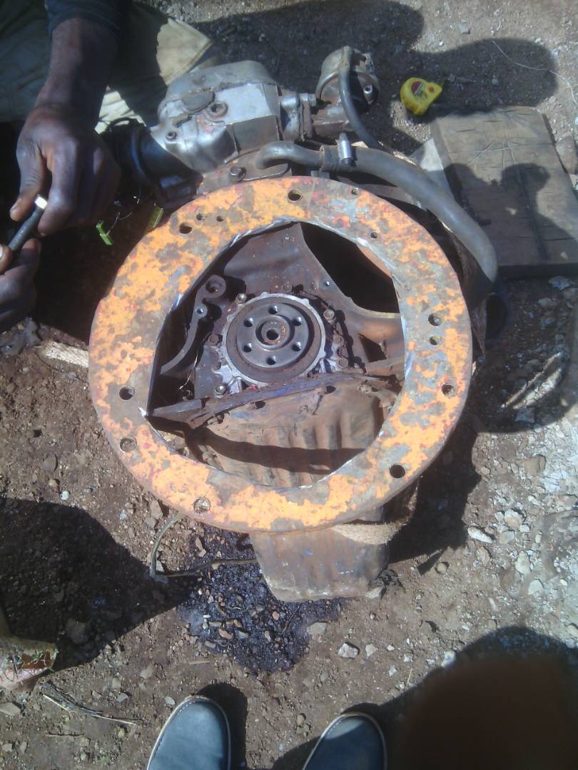

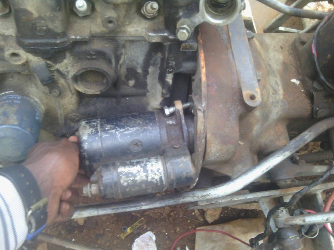

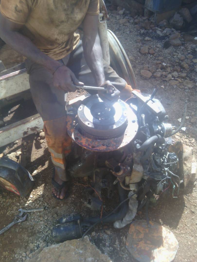

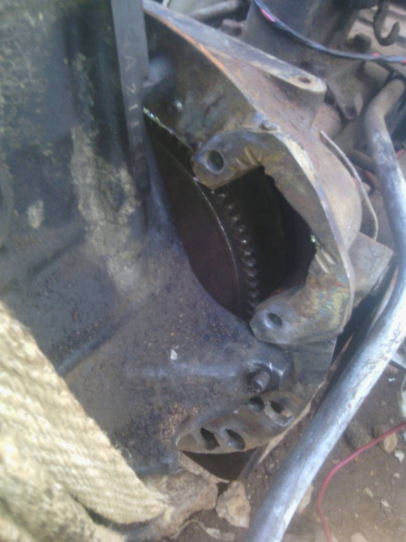

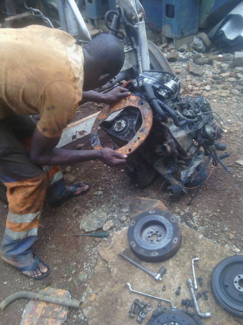

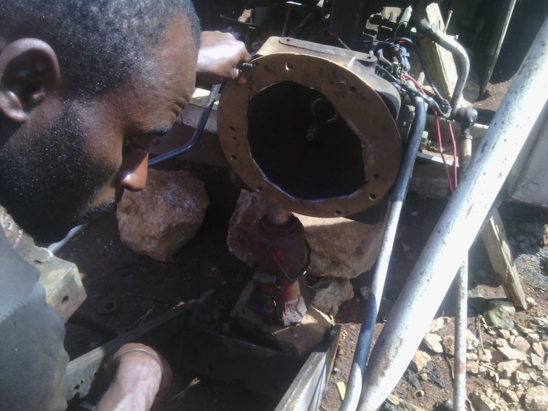

Hi all, I previously posted our challenges with a satoh tractor that was shipped to Africa and we were considering installing a toyota 4A engine...
the 4A engine (except for one scarce version o it) is designed to be mounted transversely, we finally opted for installed the toyota 3A engine designed to me mounted longitudinally on the toyota sprinter carib or known as the toyota tercel 4x4 late 1980's early 1990 model.
Figued I would share some pictures o the ongoing work
IMG-20170629-WA0000.jpgIMG-20170629-WA0001.jpgIMG-20170629-WA0005.jpgIMG-20170706-WA0001.jpgIMG-20170706-WA0005.jpgIMG-20170708-WA0015.jpgIMG-20170708-WA0017.jpgIMG-20170627-WA0009.jpgIMG-20170628-WA0013.jpgIMG-20170629-WA0000.jpg

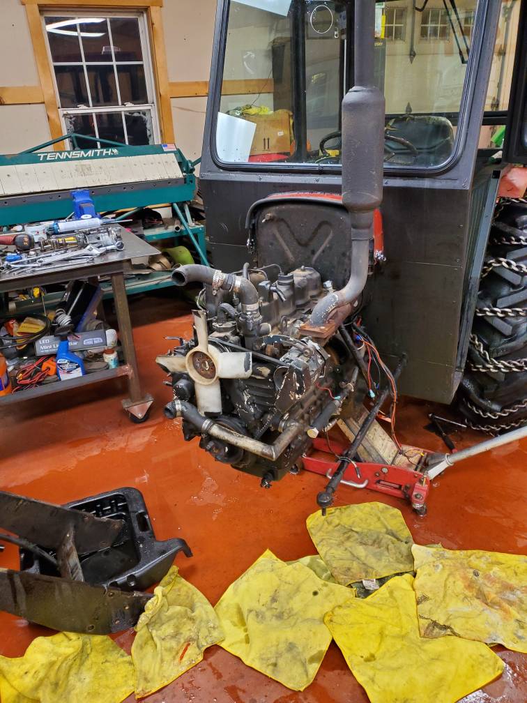

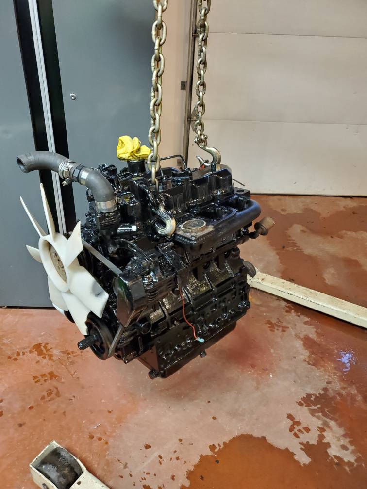

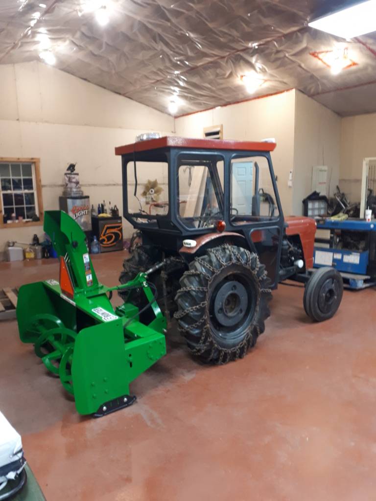

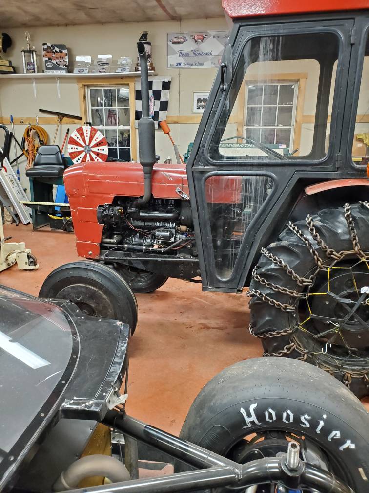

Hey guys sorry about the late response.here are some pics. Engine has been in for two years now and not one problem so far! I can cut a 2 acre lawn all summer on one tank of fuel! This mod really made this little tractor a great workhorse.
Well it's been 8 years since I swapped out the old Mazda. Recently I found a v2203 DI so I put that in. Huge difference in performance going from 2000 rpm to 2800rpm also built my own cab and bought a new Frontier blower.20200109_204235.jpeg20200112_083012.jpeg20200112_173428.jpeg20191113_173603.jpeg
   / satoh S650G engine changeablility ? #30
Just found this thread today, and quickly focused in on the cab on your S650. Very nice job, as these tractors were not offered an accessory cab when new, and afaik no aftermarket manufacturers did either, with he possible exception of Original Cab offering a soft cab. Would you be so kind as to post a few photos showing more of it? Seeing your mounts and mount locations would be especially helpful to anyone wishing to make their own cab as well. I have a Bison S670D with the Mitsubishi K4D engine. For winter snowblowing, a cab would be worth its weight in gold! Are your cab windows made of Lexan?
