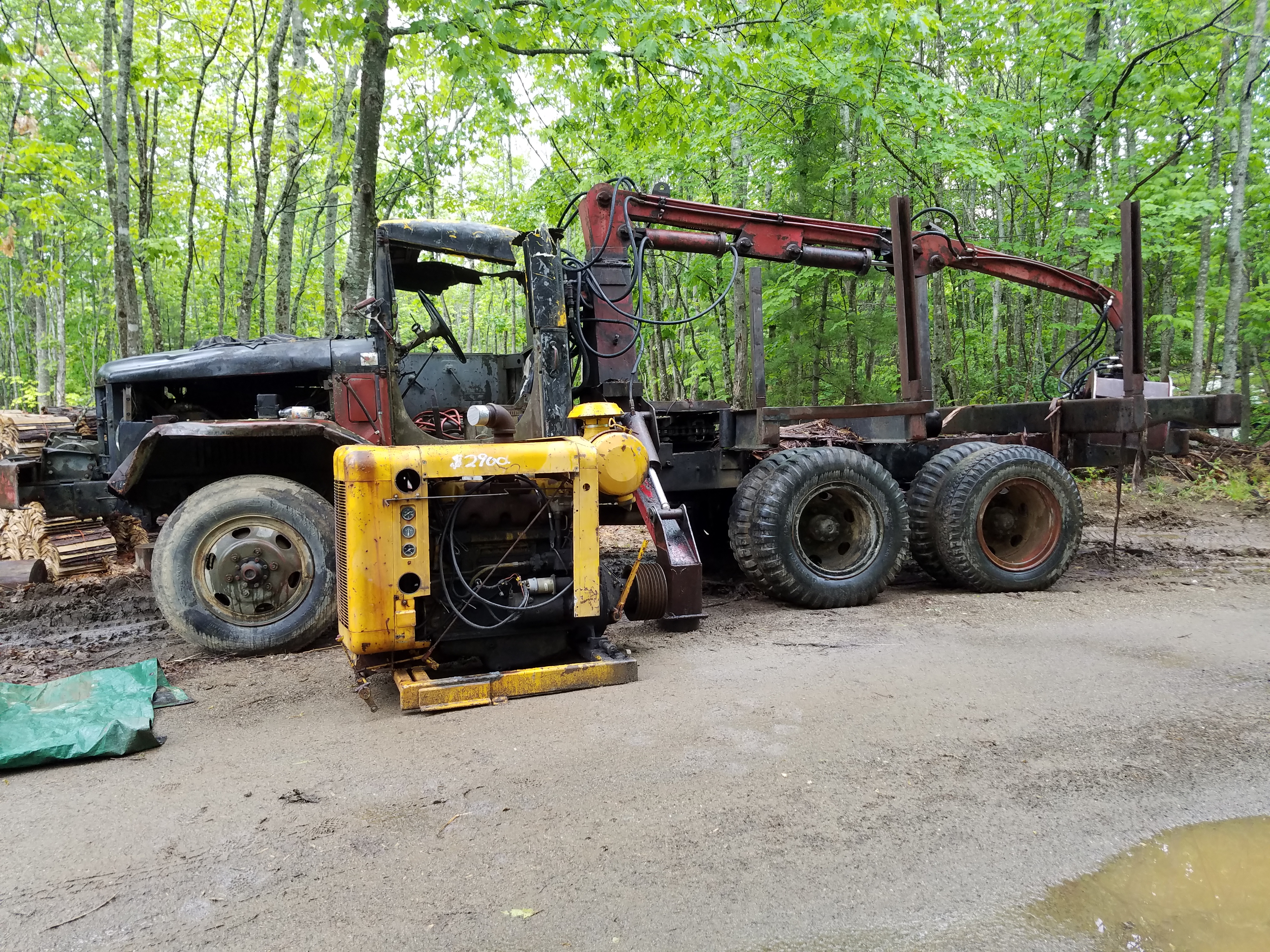

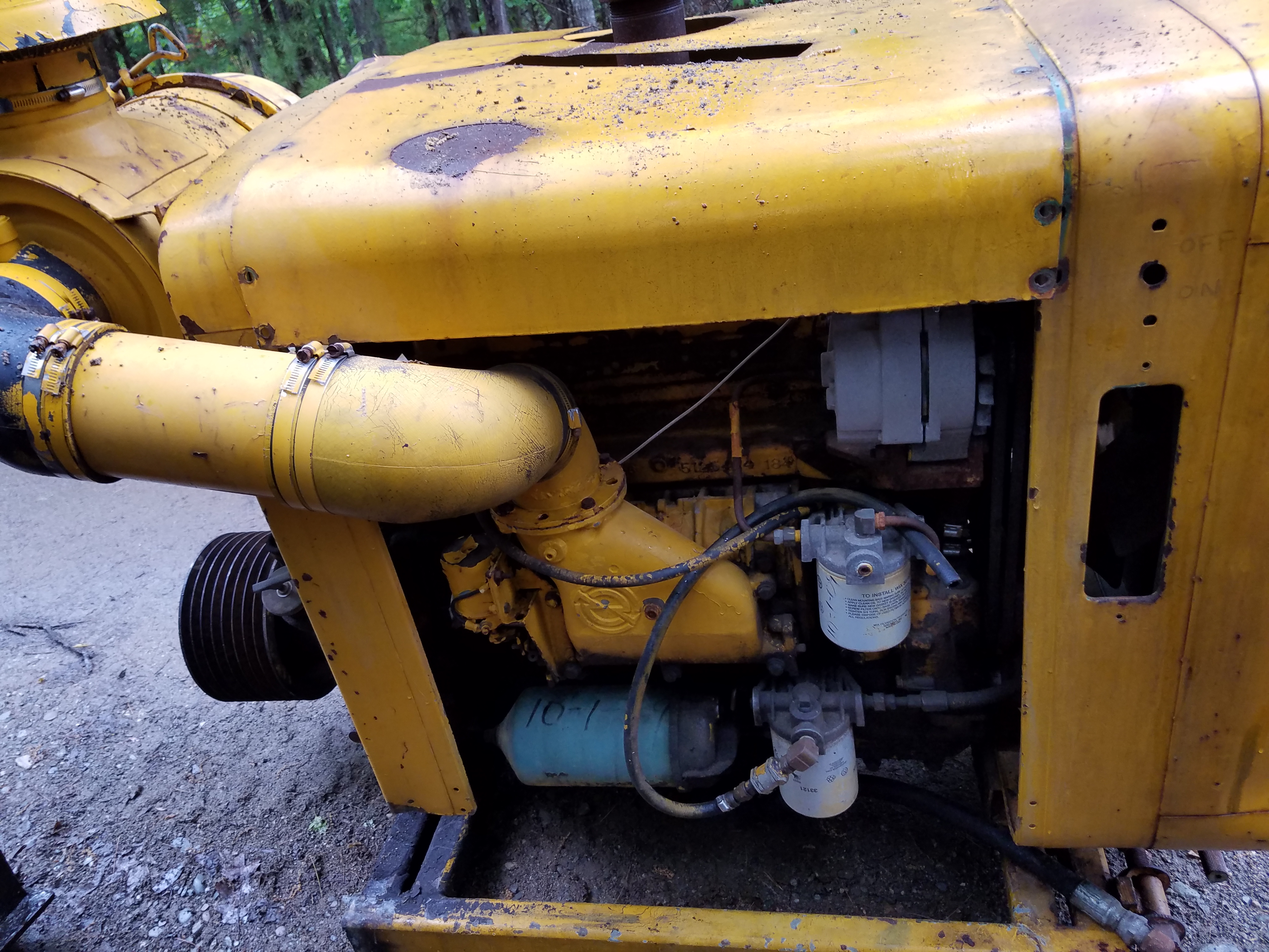

My son bought a 453 Detroit diesel power unit this past week 2.5k, he's been using a rebuilt 59 GMC 261 six cylinder to power his shingle mill for ten years and has now gotten tied. Something he said I thought was kinda unusual, weight is 1,400 lbs. heavy his loader can barely pick it up, takes 5 gal oil for a oil change and he said it's 2 stroke, thought diesels were 4 stroke, I can never remember what the strokes are call.

You'll recognize the sound of that 2 stroke once he fire's it up. Many skidders had them along with lot's of older machinery & trucks. FWIW the 4 is the # of cylinders and the 53 is the displacement of each cyl. (c.i). I'm no expert on them but I think they all were "blown". Look for a strange casting involved with intake air that has "GM" embossed into it.Detroit Diesel Grain Truck - YouTube

Two stroke diesels are cool. Not like a two stroke gas motor, where you need you add oil to the fuel because the charge lubricates the bottom end on the way to the conclusion chamber, but they do use a blower to move the exhaust out of the cylinder through ports in the side instead of having open valves during an exhaust stroke.

The blower pushes air thru intake ports in the cylinder. The exhaust goes out exhaust valves like a 4 cycle engine has.
They're good heavy duty engines. I've run equipment that used them.

****, I got it backwards. Thanks for setting me straight!!
