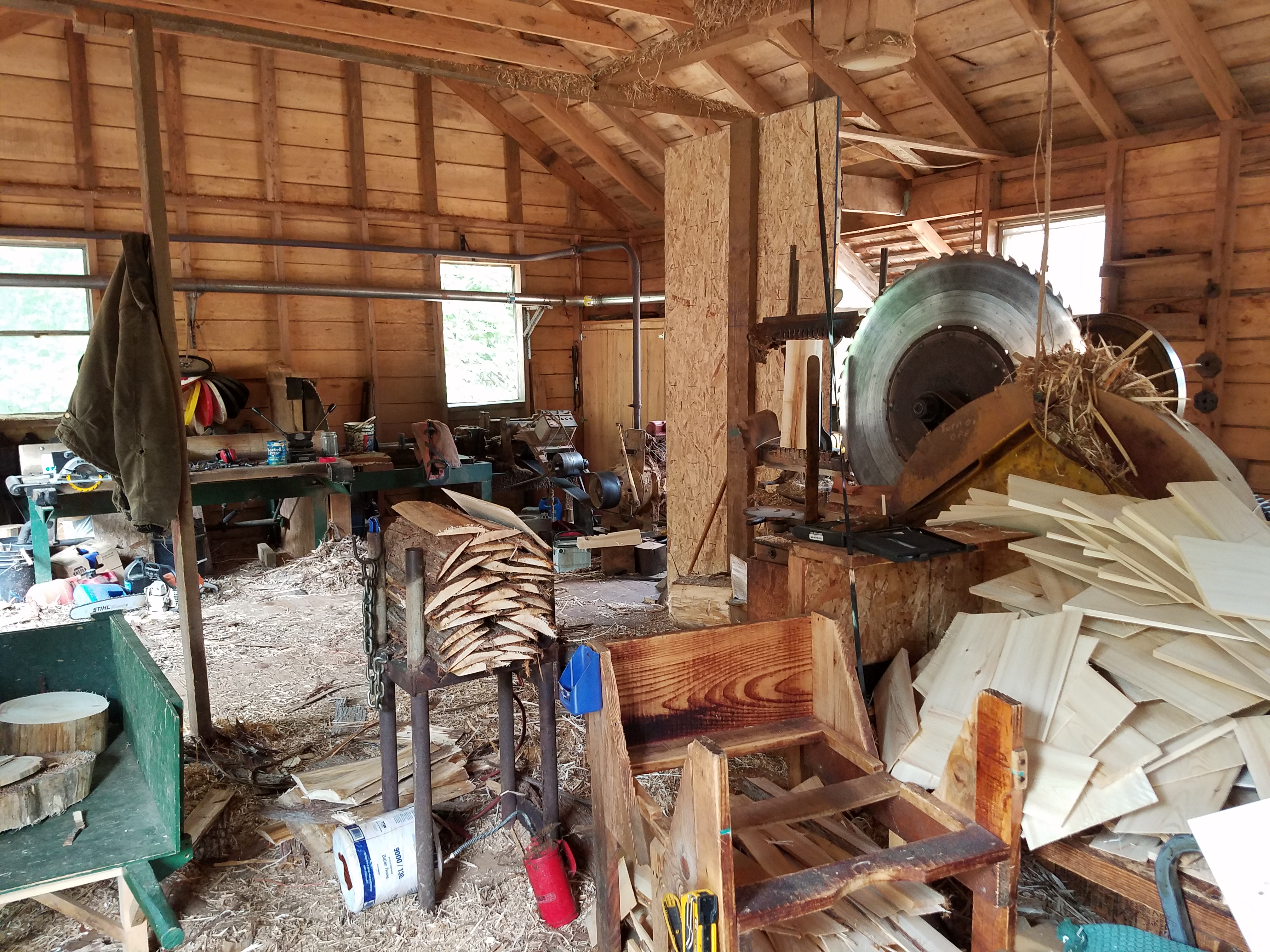

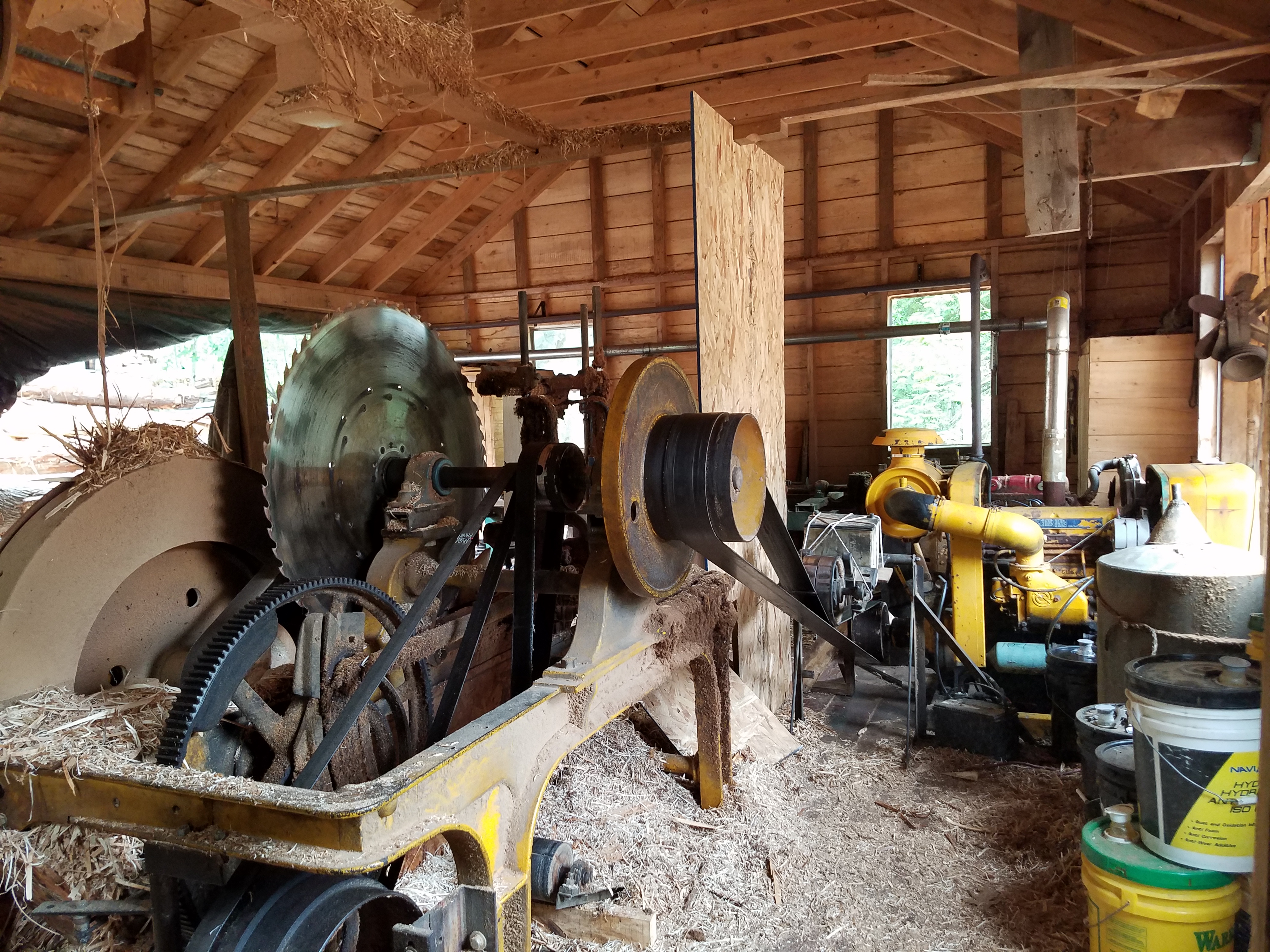

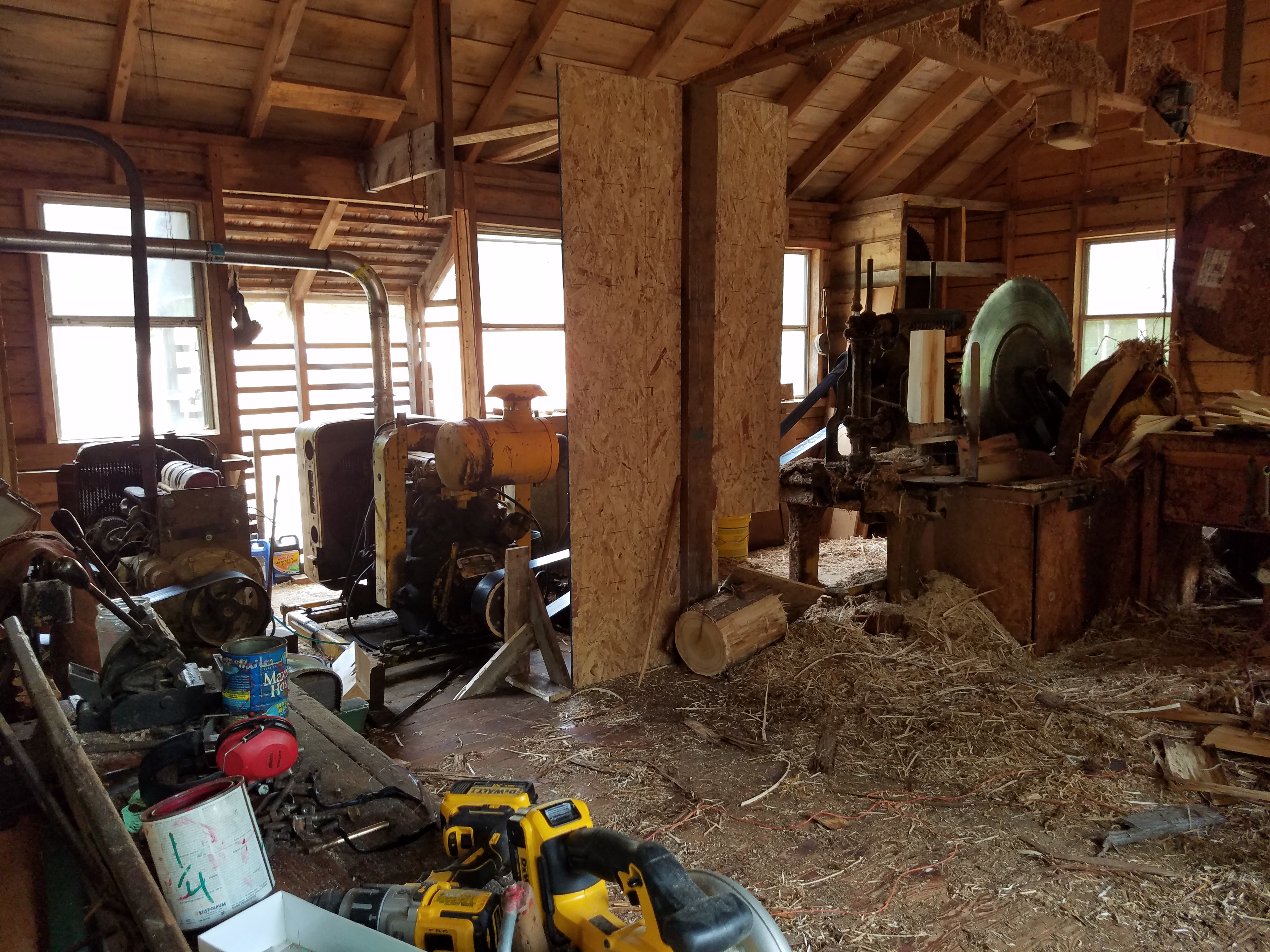

My son got his motor in last Sat., guys here were right, LOUD, I guess it's loud. I was working in the garage 300' away when all of a sudden I hear this whining, buzzing motor sound, looked out the front door thought the neighbor had a runaway lawnmower, then open up the back door and there it was, only thing louder would've been a Harley.
The Detroit diesel power plant is on 30' of 3-1/2" pipe, went down there to see what can be done to make it quieter. I was standing next to the motor and the exhaust was still drowning out the motor. He got a muffler put on today and shorten up the pipe, said it's a lot quieter, next he's putting on a spark arrestor. I'll check it out some more this weekend. Also said he's going to make a video of it in a few weeks when things ironed out.
