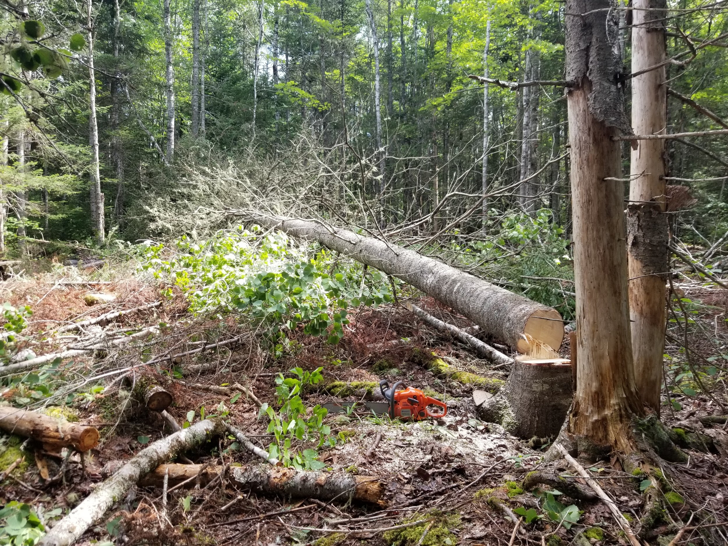

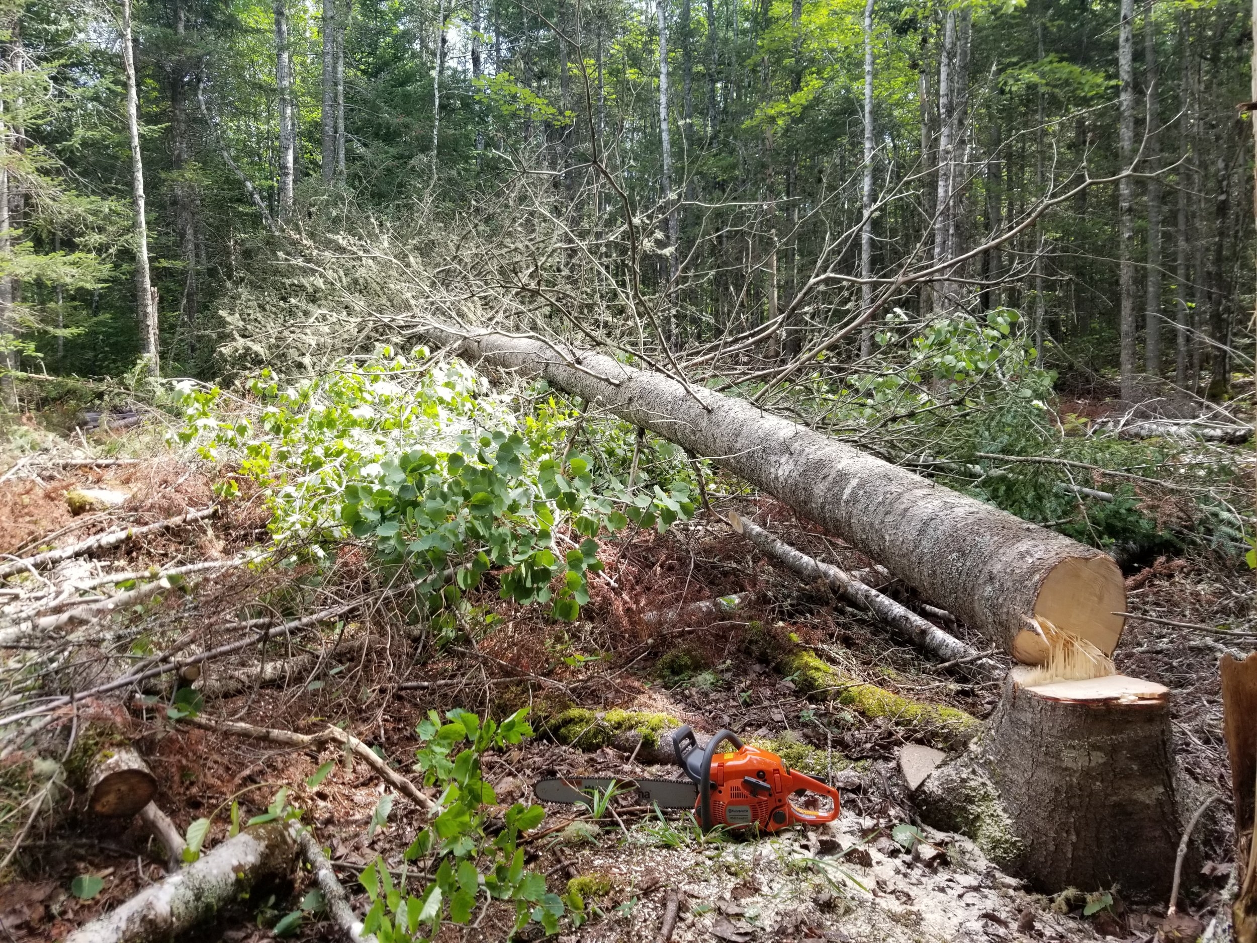

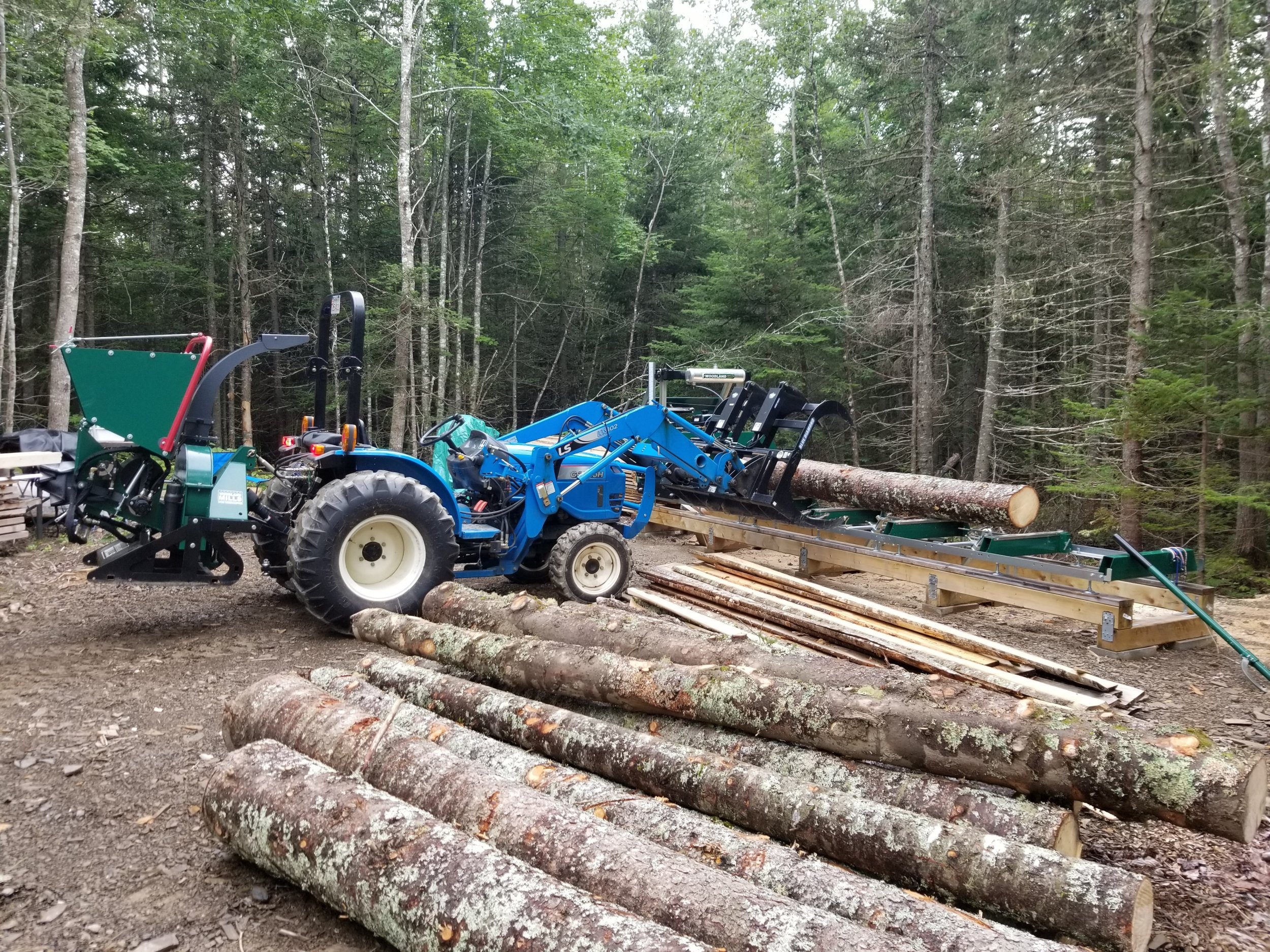

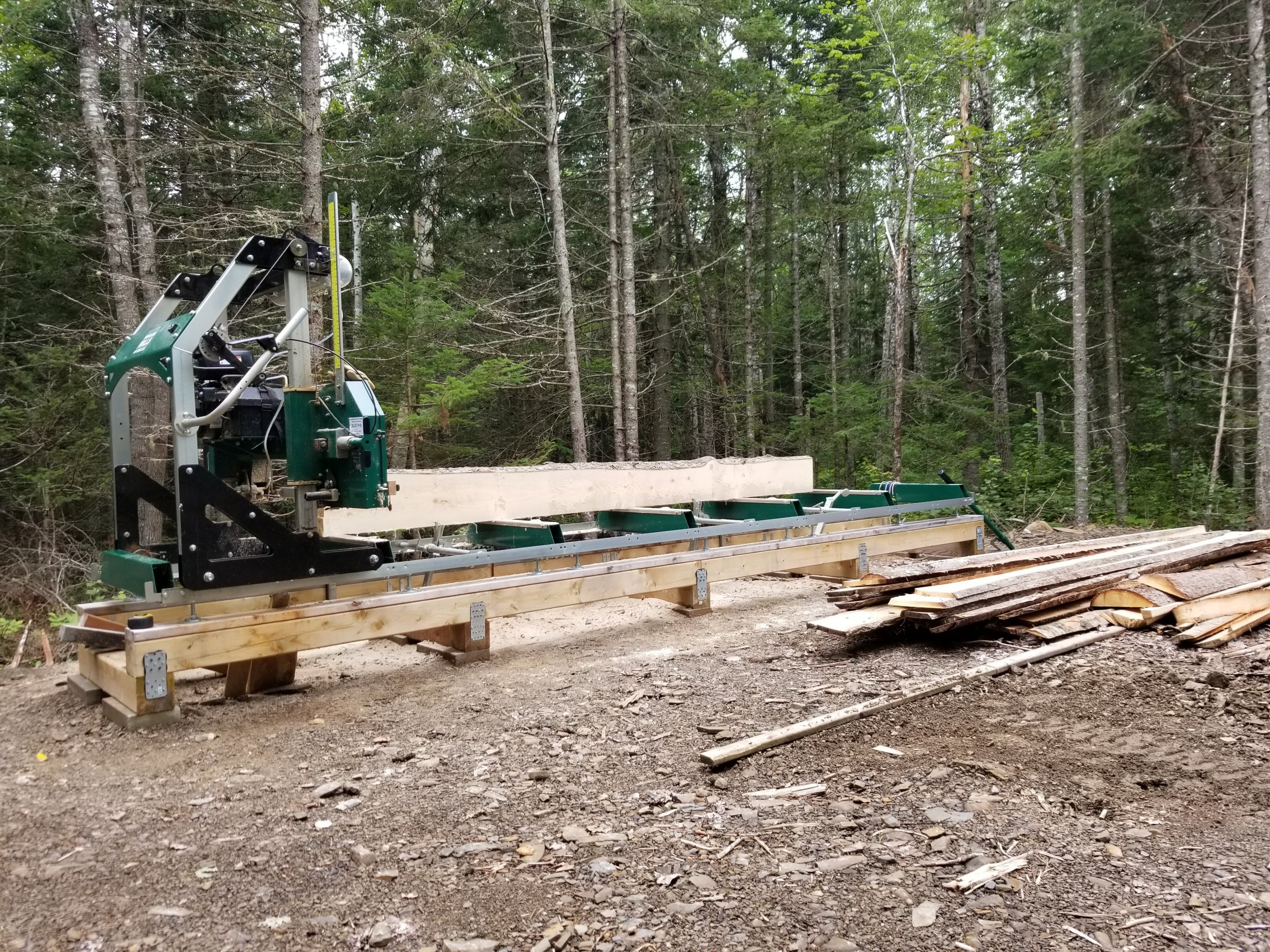

I have been milling lumber for my Garage / shop while clearing the land this summer. I only work the mornings as the afternoons are too hot for me. Having a good time at it though. I am really liking my Woodland Mills HM130 max.
I bought a laser and put it on the mill with a piece of white oak and some potent rare earth magnets but it still moves with the vibration. I will drill some holes and secure it with bolts in the near future.
My mill settled on one side over the winter mostly because the fill under it was fairly new. 20 minutes and a level put that right.
I also bought a new saw. I got a Husqvarna 450 rancher. It's a nice step up from my Echo CS 370. Handles any size tree I have with ease and not real heavy .

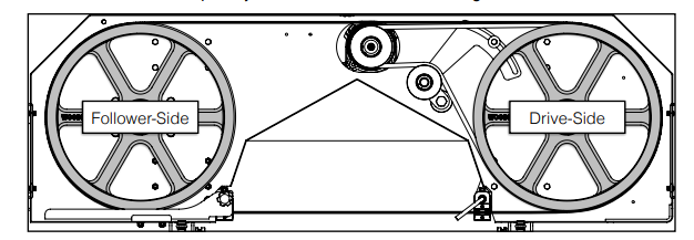

Quick question about about blade jumping. I had torqued the blade once by moving a log and not withdrawing the blade. Since then, no matter how I adjusted things, the blade would jump. I discovered yesterday, after hours of checking and adjusting of every part, that the follow belt was 'kinked'.In other words it wasn't perfectly round. Of course this never showed itself when hand turning. Everything tracked great. Only when I finally decided to give it a go and throttled up did the blade jump off again. It's then that I noticed, when removing the blade, that the belt had an issue. What I do not know is if that happened this last go-around or was it there prior. I guess the question is this. Is the belt deformity enough to make the blade jump off? I'm guessing it is. Regardless, I am ordering a new set of belts for a mill I've barely used. If this is not the issue what else do I need to look at?

Sorry. There is a drive side for the mill (HM130 MAX). I'm talking about the opposite side. See image below
As for blades I did change to a new one. Tensioned to 25lbs of torque. Still jumped.
   / Sawmills, sawmill buildings, drying sheds, and kilns... show your pictures! #387
Oh.............okay. Swap the belt on the follow wheel to the drive wheel and the drive wheel belt to the follow wheel. I do that every so often. Like rotating your tires.
You will find that keeping spare belts around is a must if sawing for $$$. That may help, but the kinked belt should be replaced.
Some times when a blade comes off, it takes a cut into the belt. Look at them good if you swap them.
