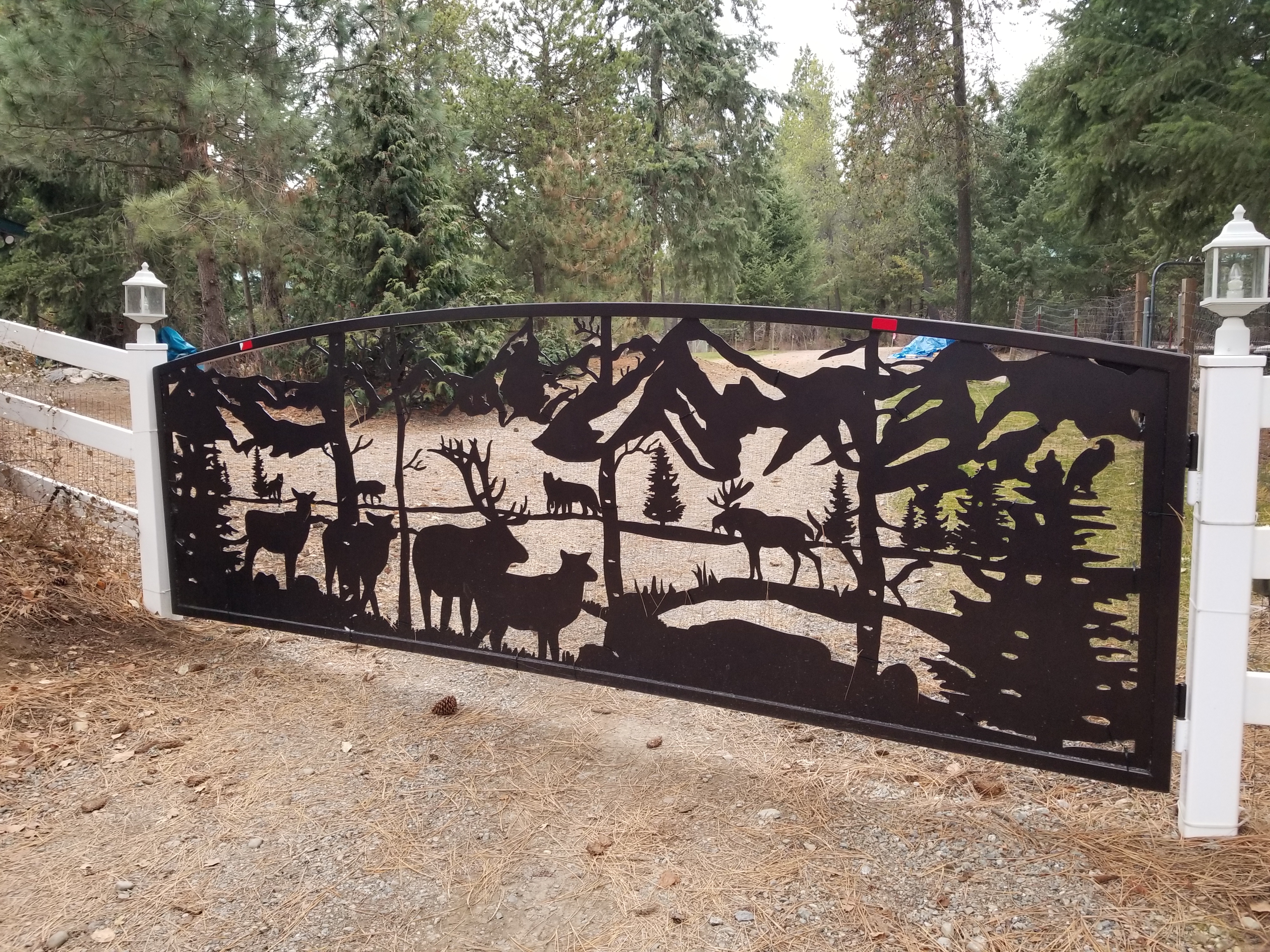

My gate is about 300-400#. Have vinyl fencing.
Used 5x5 x 1/4” tube. I plasma cut the 3 holes and powder coated it white. Looks just like vinyl post.
Made brackets to hold lights also.
