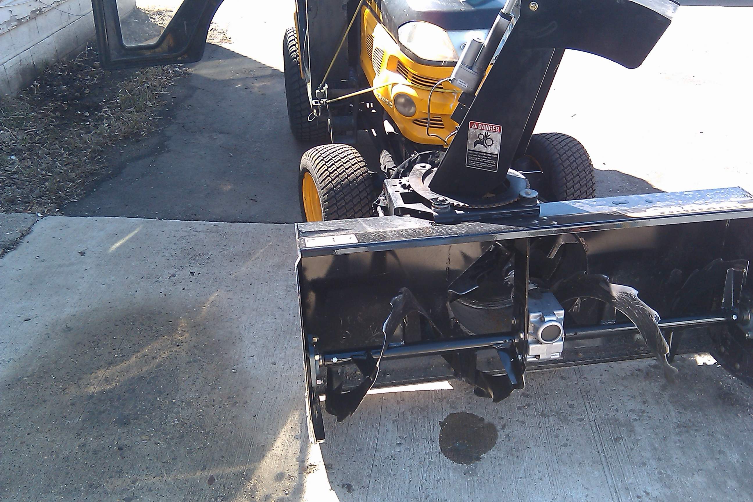

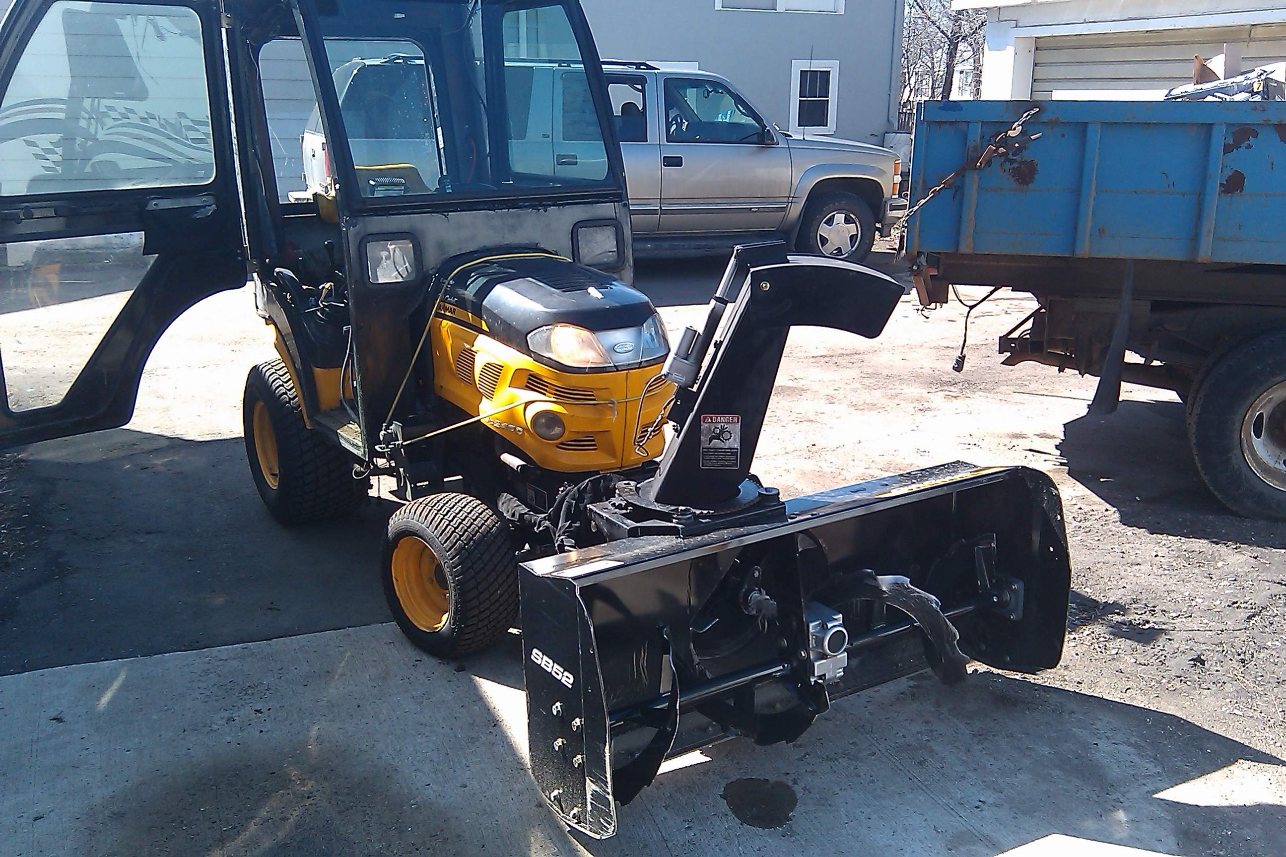

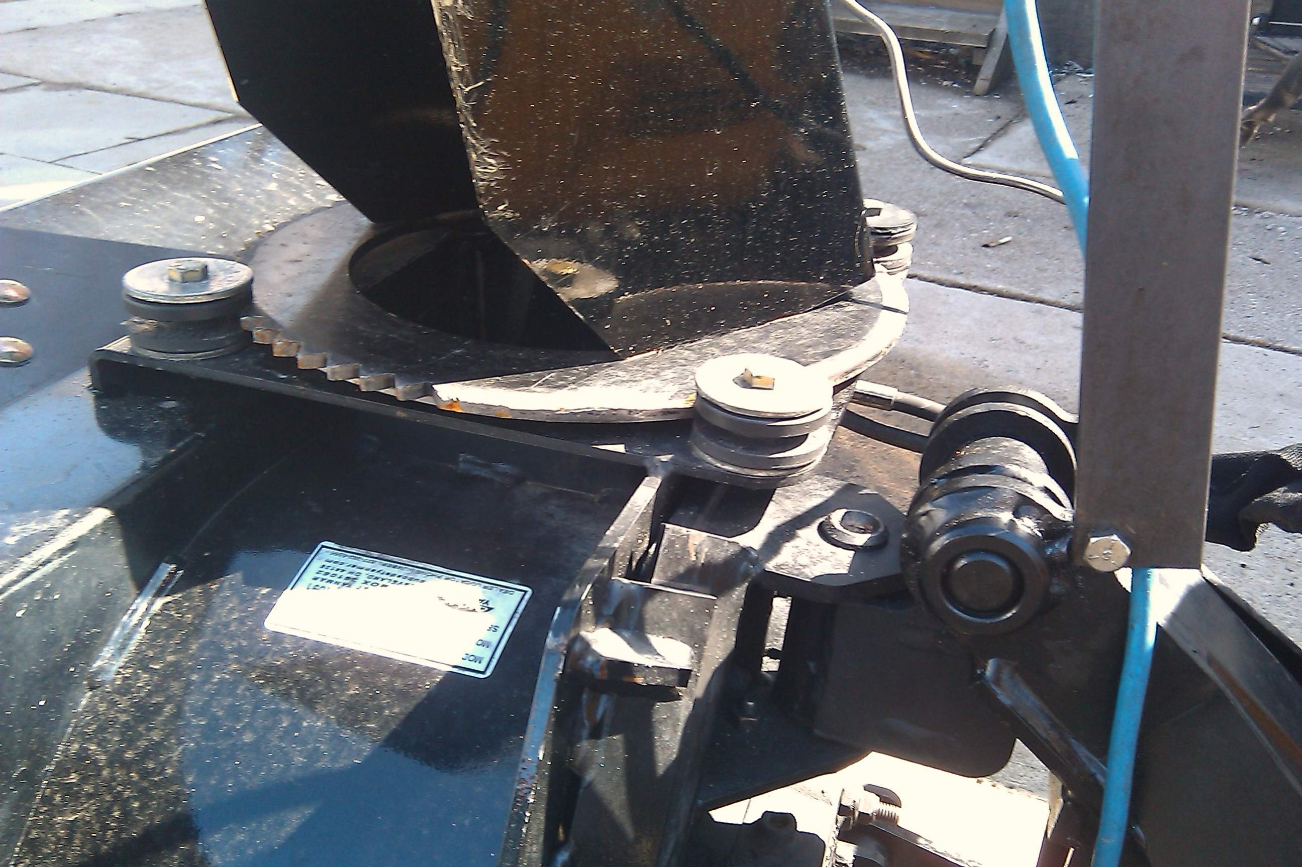

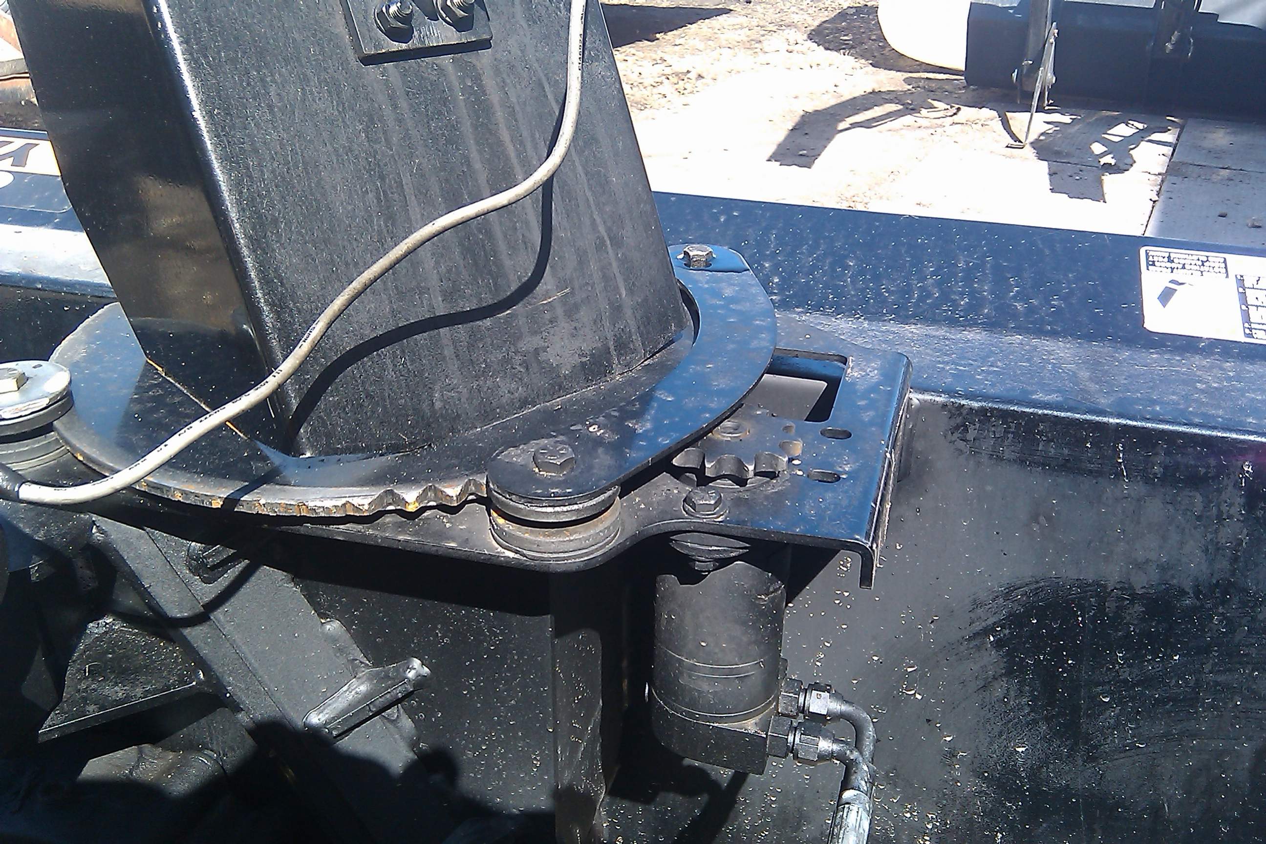

here even a couple pics as I was taking everything off
these are after 200+ hrs of use probably more than most get in a lifetime
the two pics are of the rollers used to hold the chute I went thru 12 plastic rollers as they were kind of rationing them out to everyone and as mine went first they sent a lot of plastic to the dealer and told me to burn em. as long as they went on the back side (not next to chute rotator motor) they last pretty good. The two metal ones they gave me right away have been on for over 125 hrs now and no wear at all so thats a fixed problem. have to straighten the sides where I have bent in the bottom a bit rubbing up against curbs and steps and such and a little straightening on the feed augers (property manager told me where one brick planter was I found the second one when pieces of brick started blowing out.

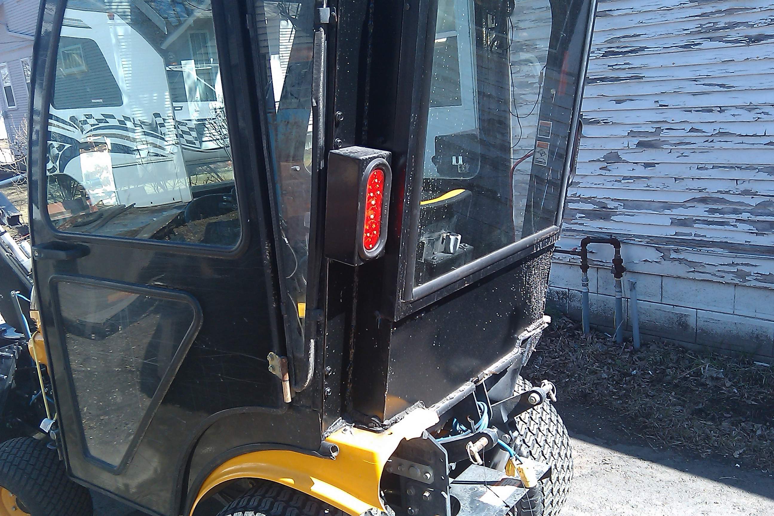

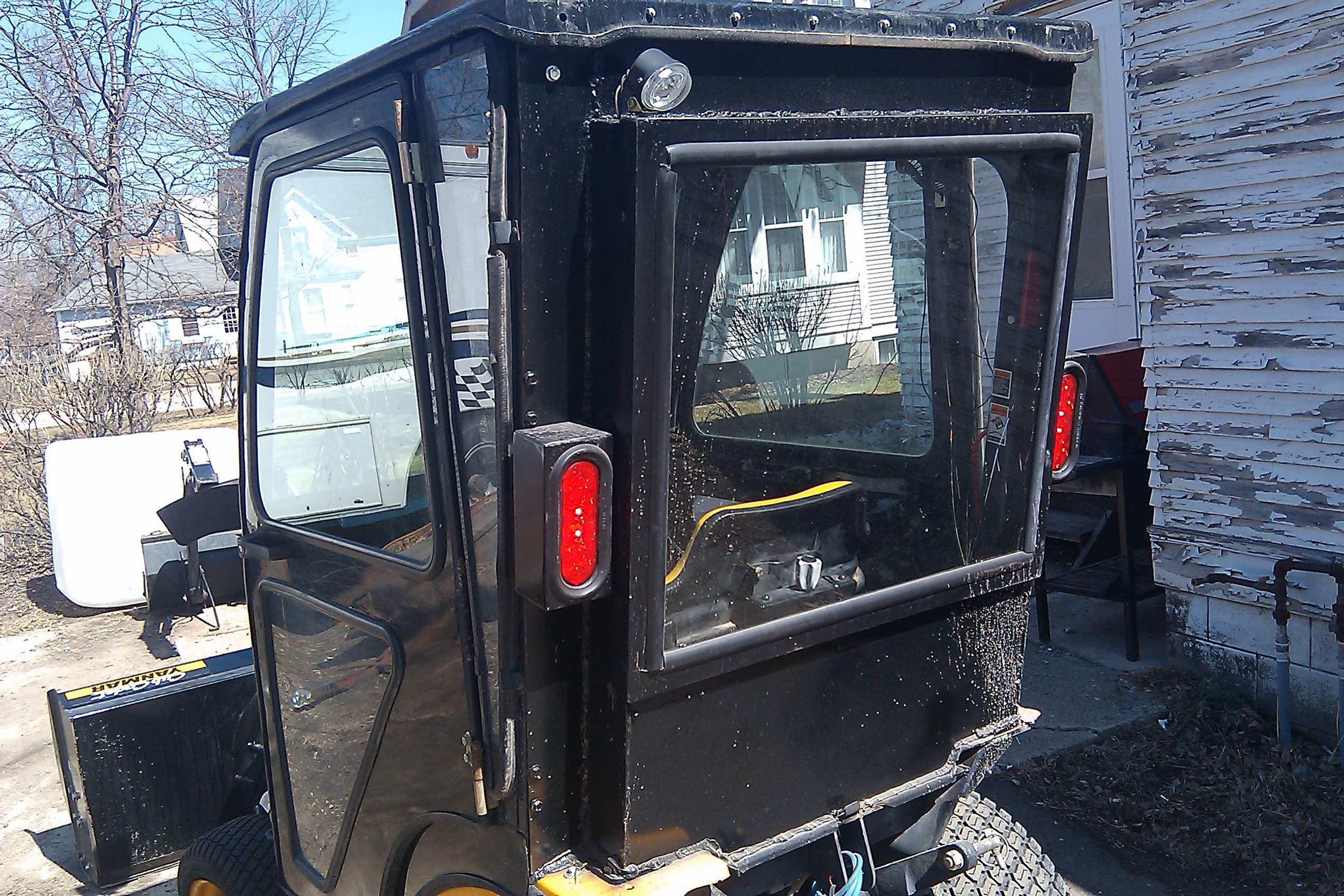

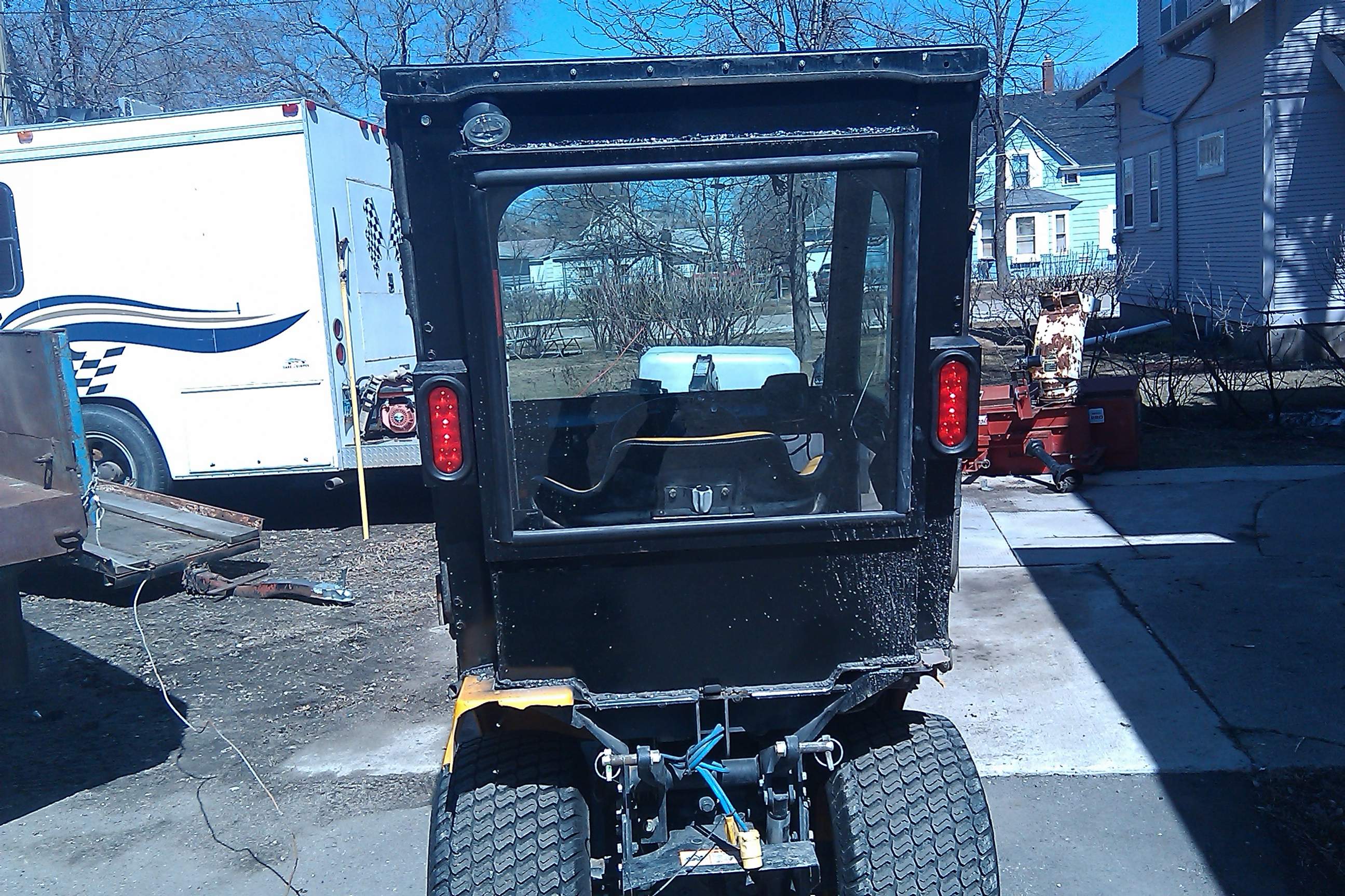

On another note here are a few pics of the metal back and glass windshield I put in this winter too, That factory plastic thing sucked big time all the way around. made the cab 15 degrees warmer on the -25 days with the 30 mph wind. the back glass comes out with three bolts for the summer used some flat to go into the factory bolt inserts in the cab then layed flat up and out around the rollcage to get a bigger glass and view of the world. Still have to make a bracket to mount 2 7.62 ammo boxes on under the window for tool and chain boxes outside, and also will mount 3 zippered pouches on the back inside for tools.
