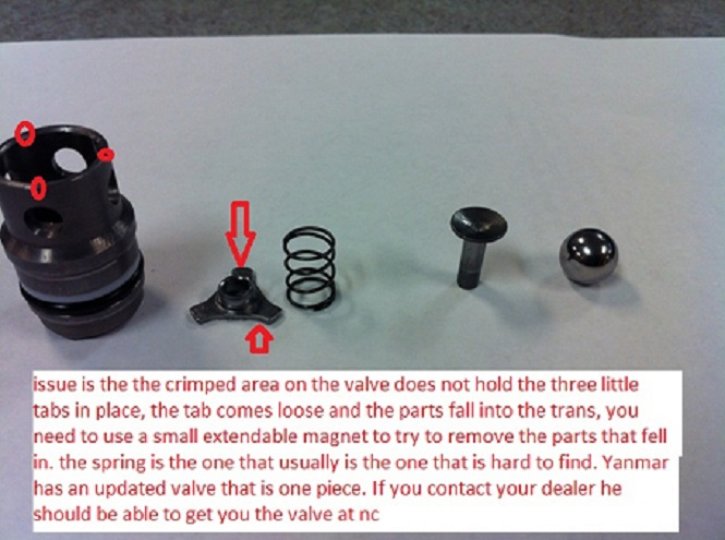

your problem Is the reverse check valve on top off the transmission under inspection plate in floorboard part number 1A7050-24990
   / Sc2400 issue #4
Tier4 correct, Yanmar had the issue and sent these updated valves to all the dealers to replace the originals, Nate, you should call your dealer and ask him to contact Yanmar on sending a new valve at nc, also if they would pay to have the dealer replace it. This pic shows what the old valve looks like, you don't want to use the tractor until is repaired, as any parts can get into the trans

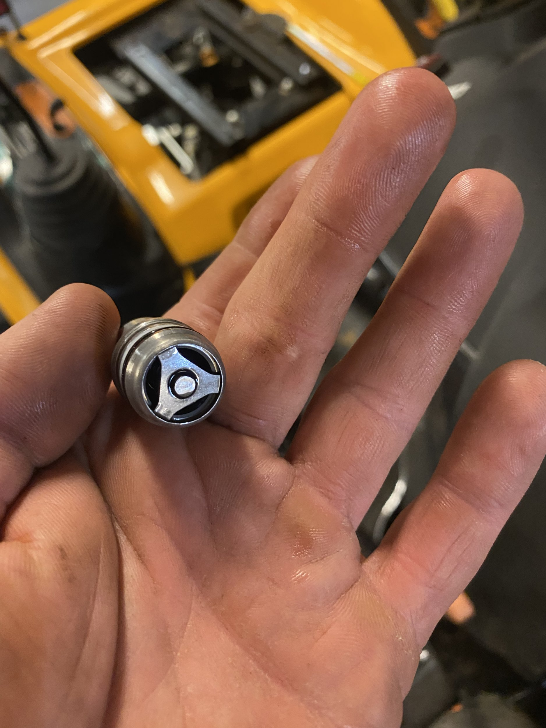

My apologies for delayed response and much thanks for the help.. I finally got back to the machine and took the check valve out.
